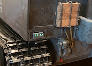

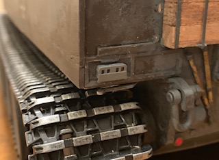

I received a cool early style convoy light and I was wondering if I could simply hook it up to the speaker wires. It came with a resistor. I don’t have any connectors but I originally thought I would connect it to the headlight wiring but I want to eliminate an extra connection between the hull and the chassis. The convoy light is a SMD LED. Any better ideas or suggestions?

I connected mine to like this.
A jst 2.5 connector to be able to take it off. The wires go to the wires for the front lights. So it comes on with the front lights. No need for resistors as these pins give the required voltage.

In case you can't see. The wires are soldered to the relevant pins of the upper hull cable. This eliminates another direct connection to the upper hull. The jst is optional.

Re: Convoy Light Hook Up?
Thanks for the reply and photos. Looks like a good idea.
For crying out loud! I just realized that the Taigen V3 mfu has a socket designated as “tail light”. Guess I’ll hook into that. Sorry for asking a silly question. I blame the whiskey.
Got it working. I love the way it looks. Gives the rear end a little more eye candy
Thanks. I tried not to overdo the weathering but without rear mud flaps I figured the corners would take a beating. I need to add a spot or two on the convoy light but for now I enjoy it’s new look.
