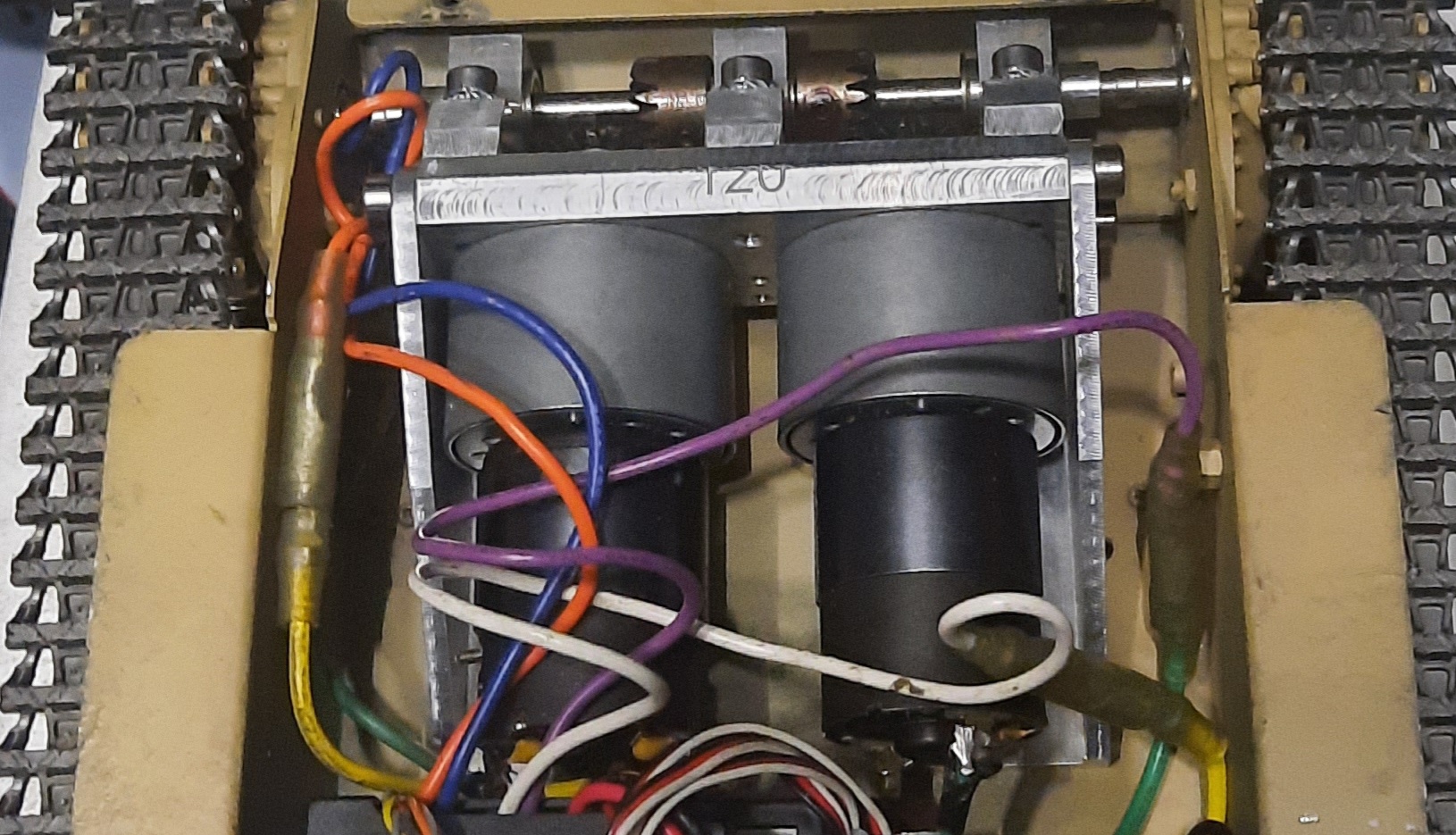

Turnigy do a servo slower which gives a momentum effect. There's also schumo geardowns. I found these shredded my gearboxes so not a massive fan but they do what you're after.

Have the Schumo version? No problems with it running metal tracks on a KT.

Hi, just found your question. I love using Roland's gearboxes in all my Tamiya Panther tanks. ;) https://modellspiegel.jimdo.com/ I have his gearboxes in my Tamiya KT, Tiger I and my two Taigen Panzer IV's and Panzer III. You can also change the 540 motors to even slower speeds or faster. He came up with them first before ETO's gearboxes. Roland is in Germany. You can find vide I s of his gearboxes in action on YouTube (just have to search). Cannot post video of one of my Panthers b/c it's too big. Lol
