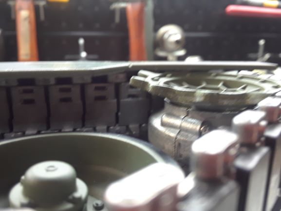

20190303_210415.jpg binding box.jpg (28.8 KiB) Viewed 4037 times
Picture of installed item. Bulges tank body.
