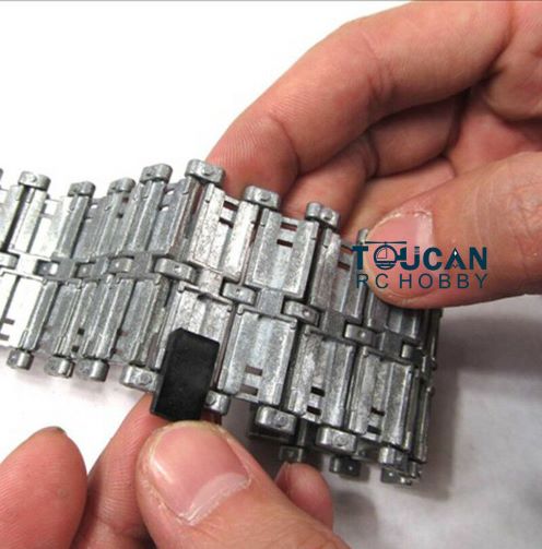

Mato tracks are not like those in your illustration. Mato pads only meet the road surface. Nice to see there are tracks such as yours made to be used. I notice none of your track pads are missing. Mine fall off with only a 3 meter run across my kitchen floor. Photo above is a Mato track set. Notice pads slide on to the metal track from the outside. A tiny rubber spine is what the engineers decided would hold it in place. Holds the pads to the track just long enough to cash a buyers check I suppose. Mato claims a 1 year warranty but does not honor it. They know this track design is flawed. The customer service rep with all the glue instructions practically told me so. Note. I did not purchase these tracks from Toucan Hobby as illustrated on the photo. Toucan Hobby has been a great seller).
