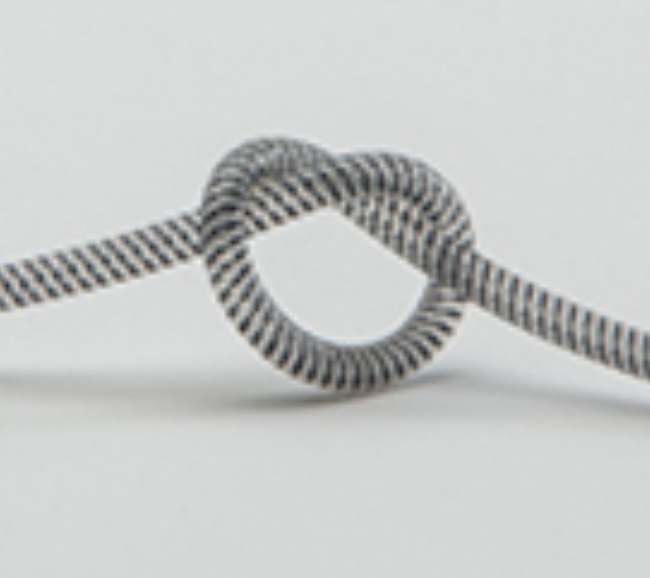

You can purchase small reinforced medical grade tubing, I thought I had a link for some, I'll keep looking.
- Screenshot_20190310-123148.jpg (81.24 KiB) Viewed 1327 times

I found my link, but it wasn't for the medical grade tube.
The smallest id this place does is 5mm.
Clear Reinforced PVC Hose – Per Metre – Direct Hoses
https://www.directhoses.co.uk/product/c ... nvEALw_wcB
