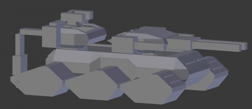

I started of by pulling a rough and ready block diagram together that would be about the size I was aiming for so I could get an idea on the relative ratios of the various components and sanity check that I could fit all the bits inside that I wanted to (more on that in a bit)
This was also my first attempt at using Blender so be gentle with me :)
Early block level proof of concept just to check the high level scale and size and to ensure it looked about right to my eye

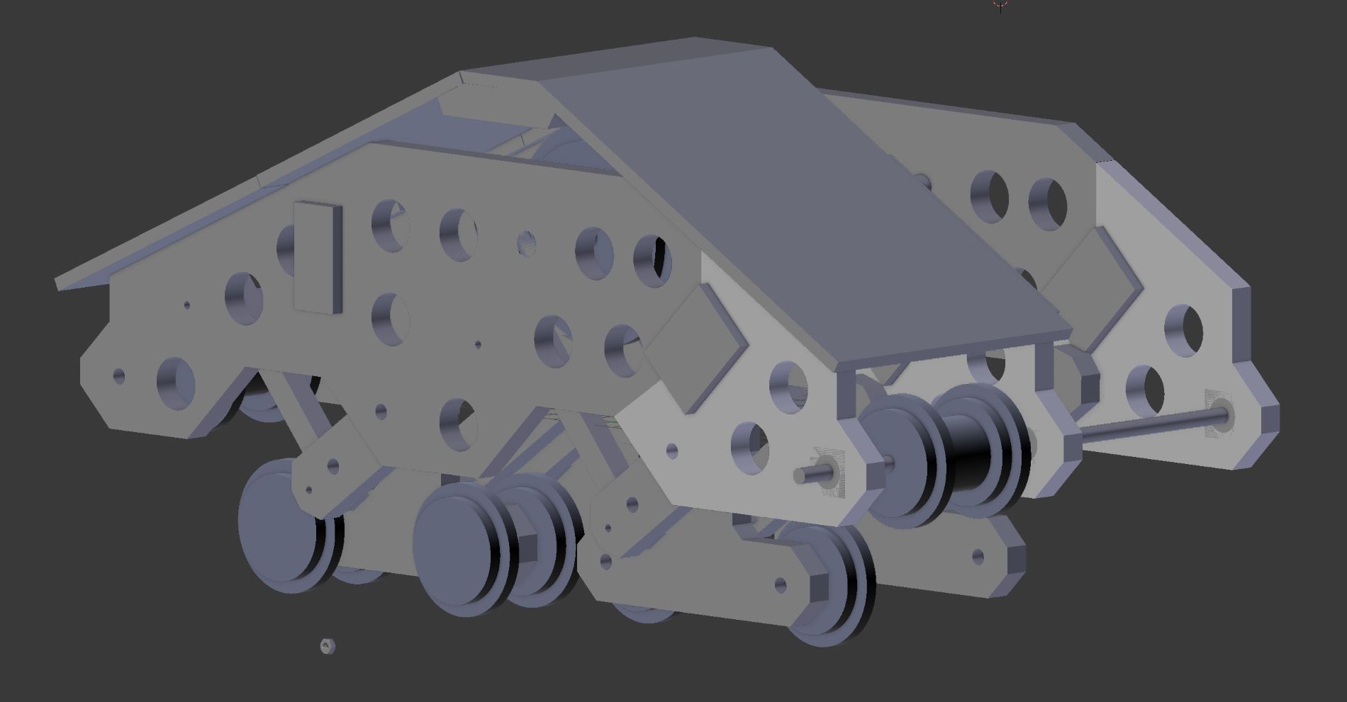

The wheel pods are still work in progress (much like the rest of it actually) but this is what I have so far:
Wheel Pod
Wheel Pod
Resized Wheel Pod 1.jpg (79.15 KiB) Viewed 1570 times
there a 6 of these in total, three down each side. All three are driven from the same motor so shouldn't get out of synch with each other. I have found some very cool springs on eBay that come from a rock crawler which should smooth the ride - 8 of them per wheel pod. These should also help keep the track under some tension so it doesn't slip too much

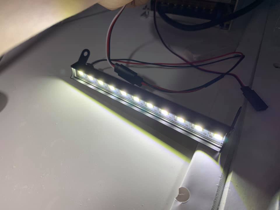

Got some additional lighting on the front which can be switched on in various combinations…. two on each forward wheel hub and two on the body
One of 6 head lights

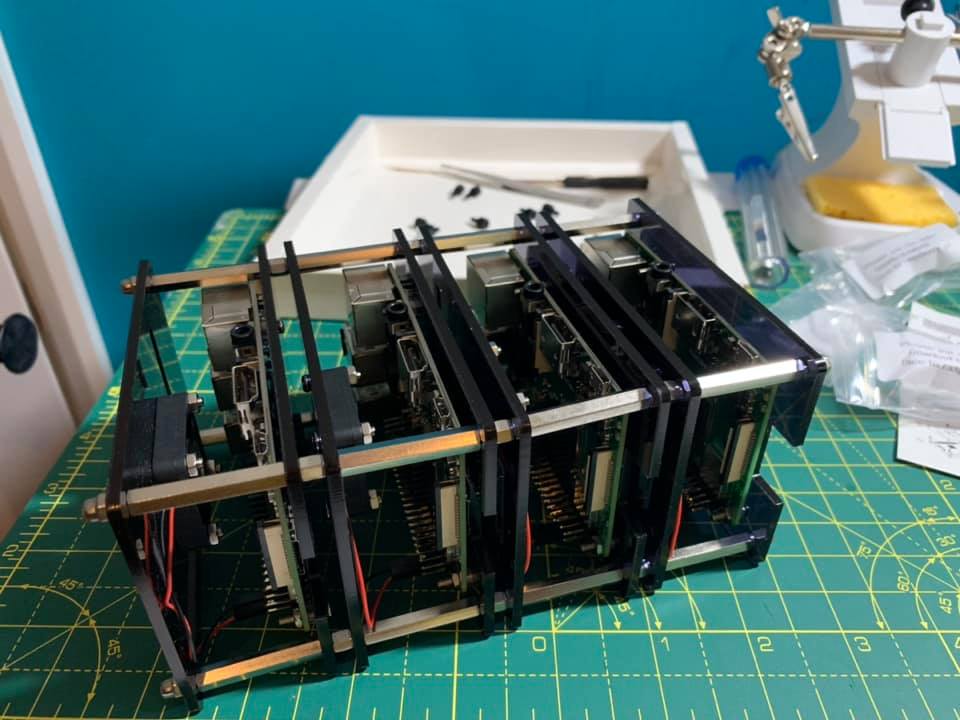

Finally (for now), here is the electronic brain that will be managing this crazy idea of mine.... can do quite a lot with a total 16 cores and 4gb of ram :)
Tank Brain
Tank Brain

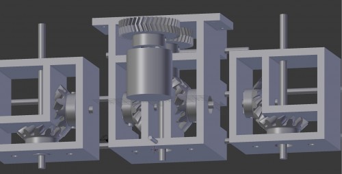

Hi Paul, what can I say, WOW 8O 8O , this looks like it's going to be quite a large beast and I totally admire your vision. My worry on this is the vehicles ability to turn/rotate in place as there will be huge stress on the drive pods plus with one motor per side of the vehicle, you will need some very clever gearbox/drive system. One solution to that could be stepper motor drive belts which you may want to consider.
I will be watching and following on this with very great interest.
Alwyn :thumbup: :wave:

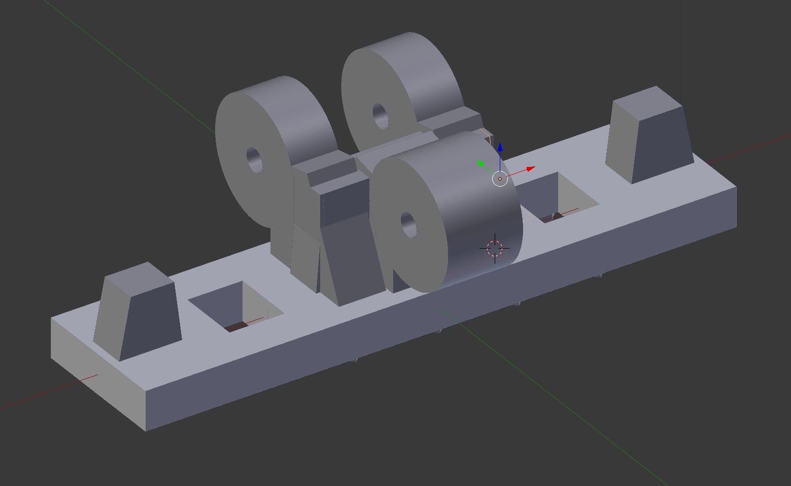

This is the current design but I need to rework to provide a 15:1 step down using some steel gears I have just ordered - I suspect I may need something a little stronger than PLA for some of the 3D printed components too - its on my list to research. I have a Prusa i3 Mk3 which can print in all sorts of materials but I have not got round to testing them yet
Current center gearbox
Is there any benefit to using belts/chains to transfer power over a driveshaft as I have above? I guess it saves power losses through the bevel gears...?
The 10mm steel rods running the length of the body should hopefully alleviate the lateral stress through turning but I will defo be mindful of it, thanks

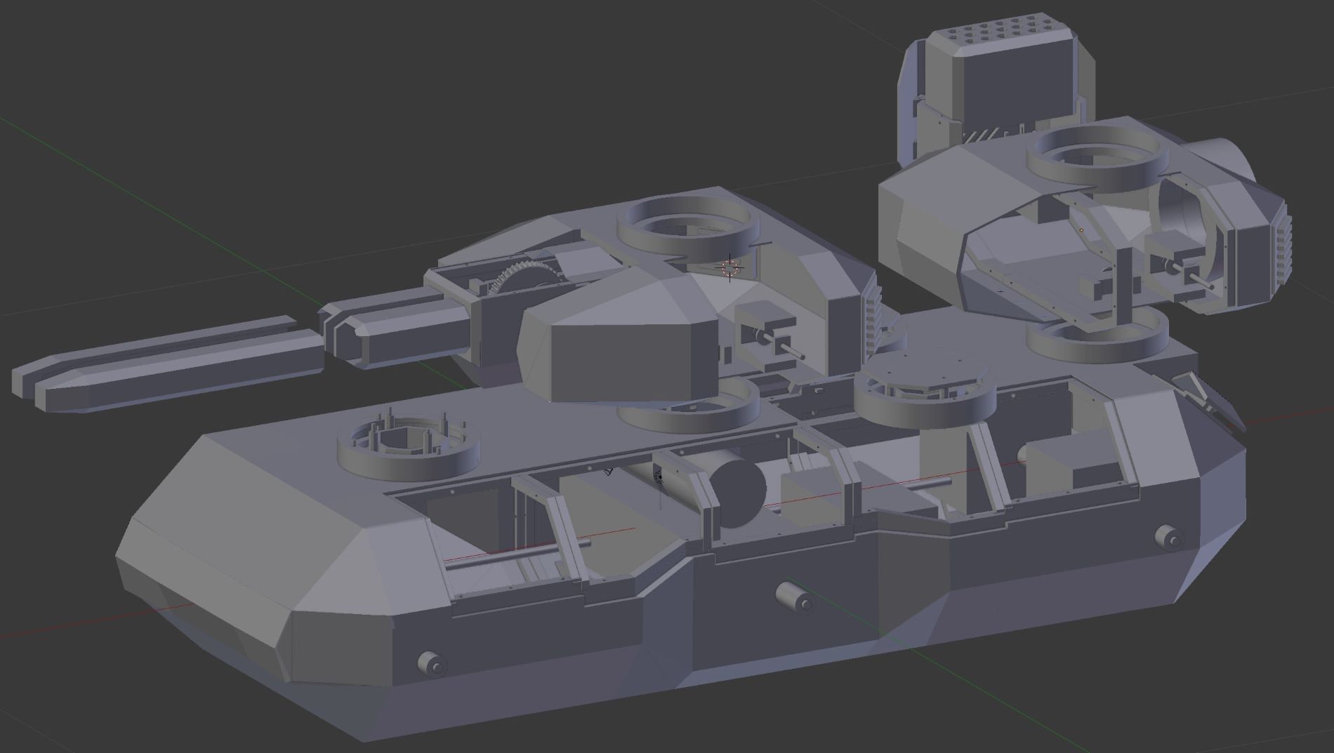

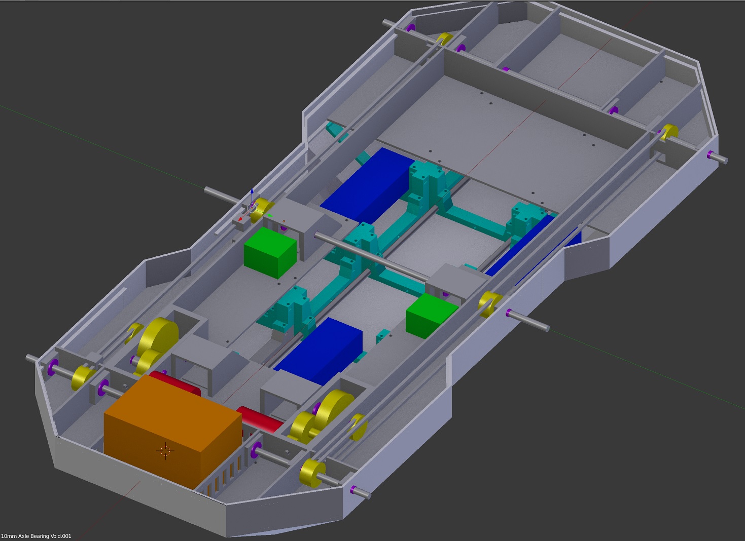

after taking on board all the comments from you lovely people, (and cramming a few courses on Blender to get my head round making it do what I want, we now have a version 2.0 of the hull :)
I have to say, I am quite pleased with how much cleaner and more accurately this has gone together... using chain drive rather that prop shafts was 100% the way to go!! please forgive the bold colour coding - I find it more useful that everything being battleship grey...
Dark blue = LiPos
Green = ESC's
Red = drive motors
Yellow = steel gears
Purple = roller bearings
Orange = Pi cluster
this also has the advantage of a nice open internal spends it self to having some internal modelling at some stage - is it wrong to put windows in a tank so you can see inside? LOL!
Still very much a work in progress so please keep the comments and suggestions coming - for scale, one floor tile is 180x180x4mm
thanks for all the support and encouragement - you guys are awesome!
AD

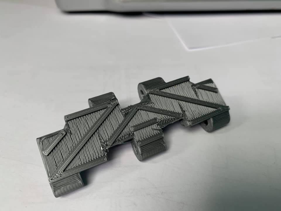

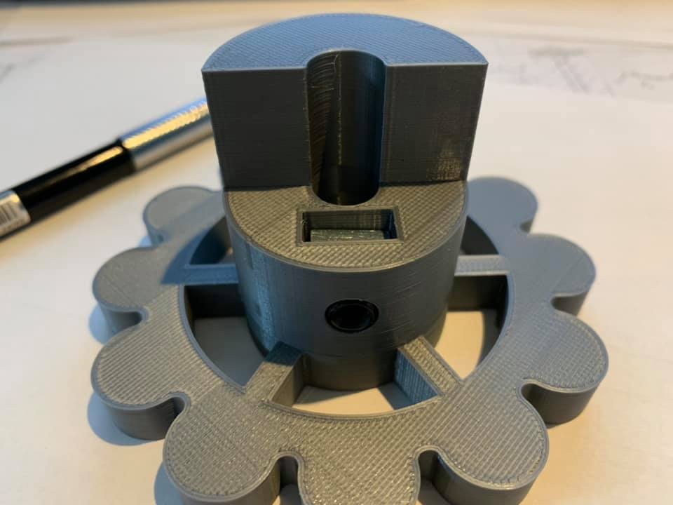

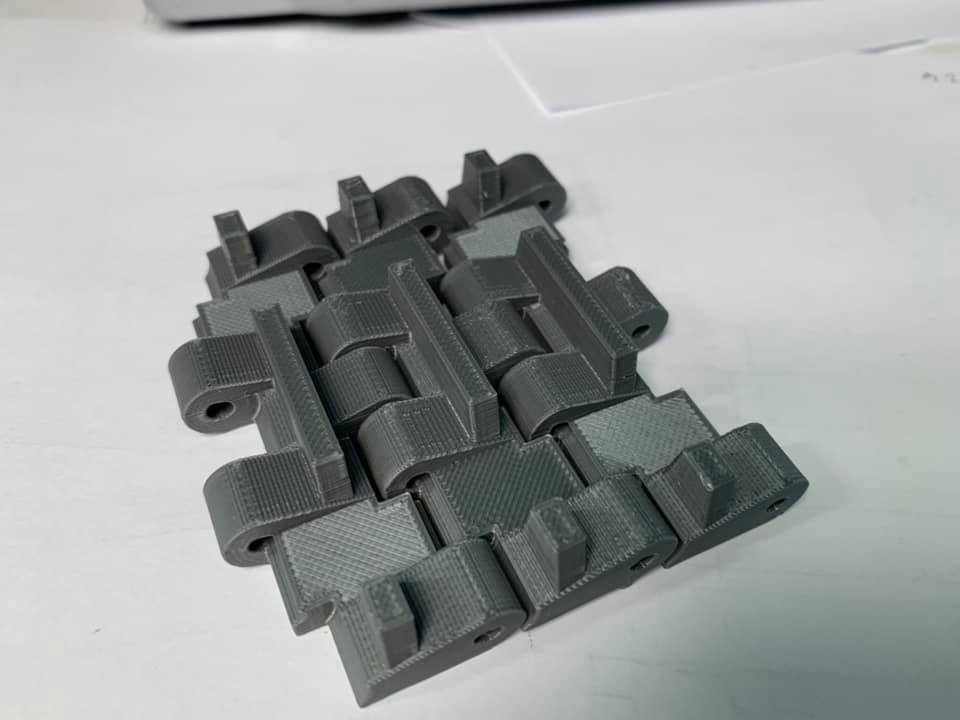

Spent the last few days playing with a new slicer - much happier with the results!
One half of a drive wheel and some track segments designed and draft printed
First three track segments - different designs iterations but you get the idea...
3pc Track Segment.jpg (38 KiB) Viewed 1399 times

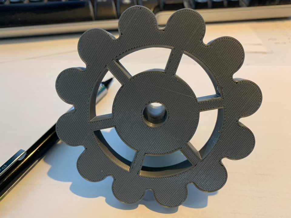

Drive Wheel
Drive Wheel
Drive Wheel Top.jpg (49.2 KiB) Viewed 1399 times
Different view - just printing the other half with a few tweaks...
Drive Wheel Front.jpg (63.83 KiB) Viewed 1399 times
