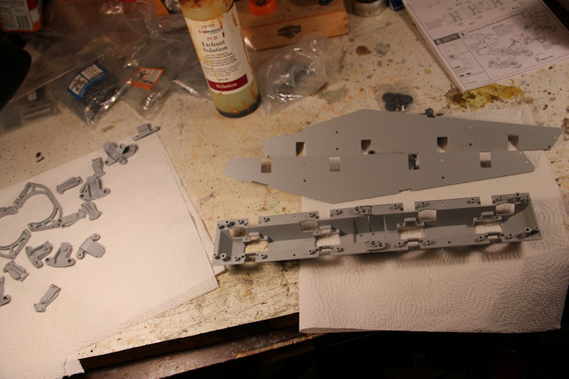

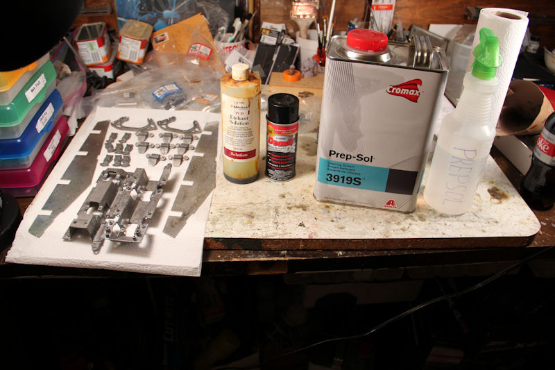

While I'm waiting for the first of my two FAMO's to get re-worked in Germany, I'm going to be working on my Puma from Metal Origins. I've had the kit for about 3 years and it's time to start on it. Compared to my last 2 projects, this will be cake, but it does have some issues to be re-worked. There's also some additional items that I'm going to improve, such as the total BS involved with having to un-screw the top hull to access the bottom to change out the battery. We're going to do this with rare earth magnets as we did with the WeCohe Panther. Anyway, this is the vaunted Puma (SdKfz 234/2) 8-wheeled armored car. This thing was 8-wheel drive and all 8 wheels turned. The driver could drive going forward, and if caught in trouble, could spin his seat around 180-degrees and there were rear controls so that he could drive rearward in a dash. What I'm showing with this initial work is I've acid-treated the metal for improved adherence of the primer and paint. I used Tamiya metal primer, but I don't think using this alone is enough so I use a metal etchant (Ferric Choride). I then follow on some parts using Deoxit, which removes some of the oxides built up due to the composition of certain pot-metals. Only the hull needed it. The arm controls in the photo didn't need it, nor the aluminum hull pieces. I found out with old cars that pot metal has a wide variance between manufacturers, and chroming was an issue with this. Going on a tangent I know, but that was the reasoning. Anyway, cleaned all parts with PrepSol and then sprayed with a few coats of Tamiya Primer. I'm going to follow this with Tamiya acrylic paint XF-60. This is going to be my first all-acrylic paint job since the hobby has mostly vacated enamels these last few years. Thanks a lot to Silversurfer and my buddy Bret Bensen for leading the way on their Puma's. Anyway, more to come. Oh yeah, I'm playing/spinnin' Guns N' Roses 'Appetite For Destruction' and Beetles 'Meet the Beetles' tonight.

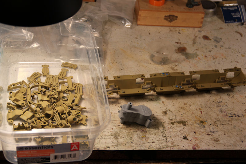

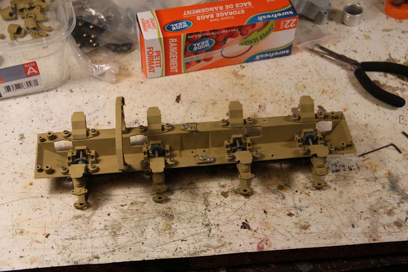

Here's some progress photos. Even though I have acid-treated the metal and used a good primer, the Tamiya base coat of XF-60 does not hold up like an enamel, and I will have to do a final spray once finished. Anyway, here's some production photos. I'm not doing as many photos as Silversurfer did, but just a bit slightly different in building. A big hat's off to him as he really did a big show of his build that has really helped out. Metal kits are a real bitch at times to work and get detail from. This one is infinitely easier than the last two kits I've worked on (see Porshe Tiger and WeCohe Panther), but it's still a metal kit and is much harder to get detail. I was going to paint the motor housing, but realizing I have to break in the gears in an oil bath, then degrease and paint, I decided to hold off. Enjoy.

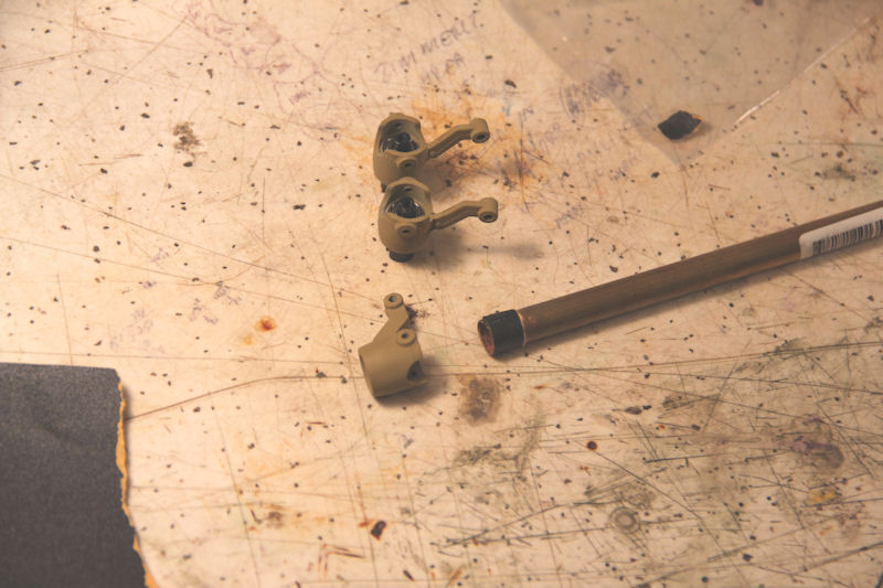

Silversurfer, this is something that was pretty well covered and addressed with different methods of attack by different people on your posting. The inside of the wheel hub is much tighter than the outside (which the bearing slips right in and out of in contrast). My answer was to take a 3/8" brass tube and wrap the end of it with some 220-grit wet/dry glued down and go to it as a reamer. It cleaned right up in a jiffy and did the first three in a few minutes. If it had been a little tighter, I would have serrated the edge with a Dremel and wound that in, then go back with the sand paper. Anyway, got them done. Sorry, the photo's not the best but I'm running off to bed and wanted to get this out.
