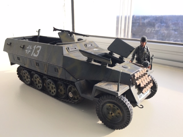

Post by modler »

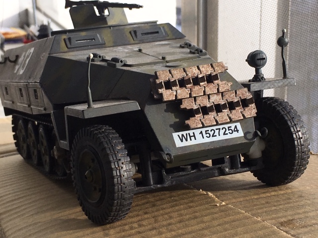

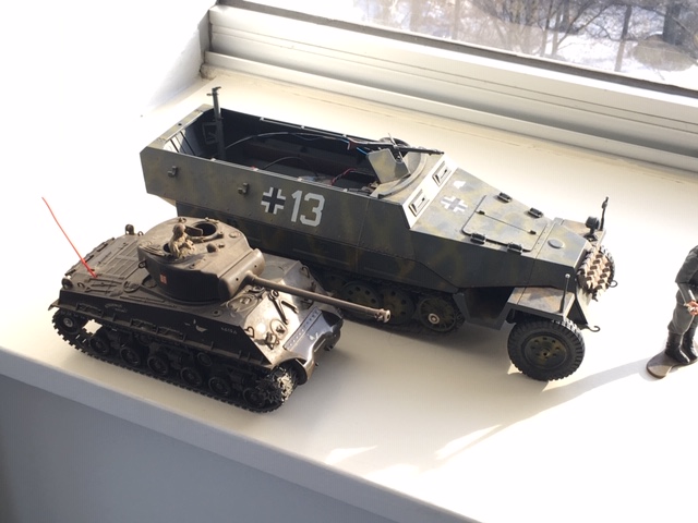

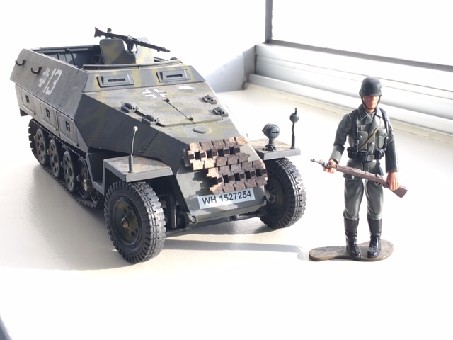

I converted this Halftrack about 20 years ago. It is due for a radio update but still works good just not great range.
It features Digital Proportional steering and throttle and has a live rear axle configuration to aid in steering. The stock wheels do all the steering.

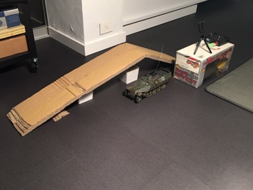

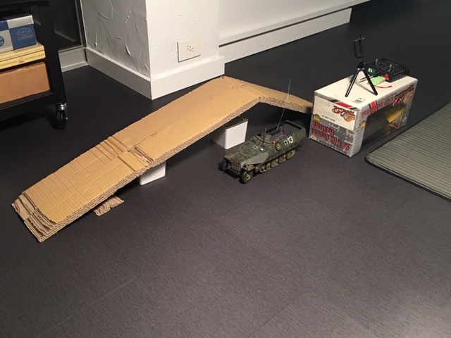

I will do a "ramp video" of this vehicle when I get a chance. Need to get a 2 cell lipo charged up for this one. :)

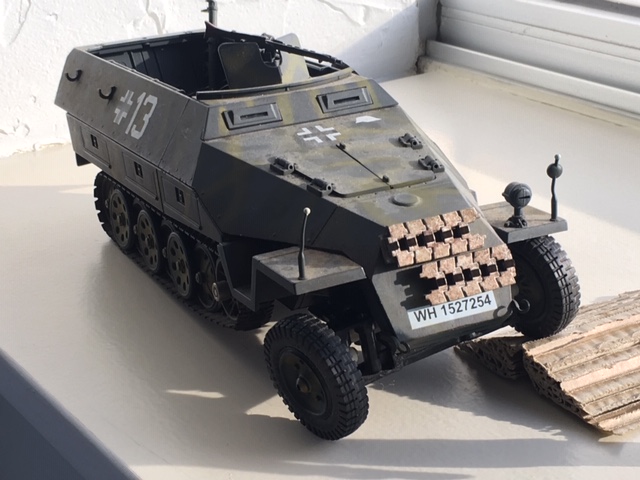

1\18 VS 1\35 halftracks

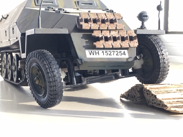

strait axle has good deflection.

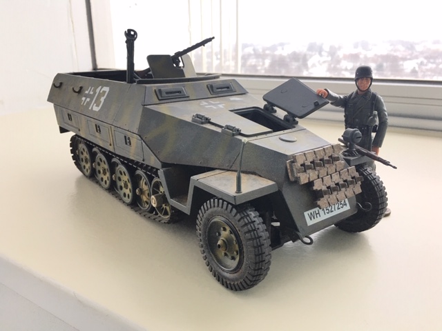

This is my favorite model soldier ever.

square4 wrote:Nice work, looking forward to see it running. :clap: :clap:
Ok, I just figured out it runs best with a 5 cell ni-mh battery. It was jittery with the 2s lipo.

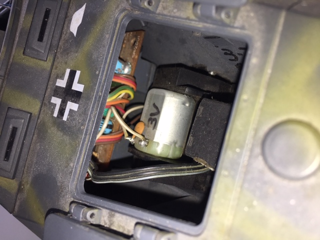

Twin 130 motors are under the hood.

I used a Toy Tank drive line for the dual motor track drive. The steering is from from Toy grade radio control truck. Steering is done by a standard HG servo. Speed control is a modified servo amp with a bridge drive from a Jeep toy. You can buy an ESC now for $5 lol. Back when this was built, radio control electronics were still expensive.
The toy's that I scavanged parts from plus the two servo's cost $75. The model cost $20. So the whole project cost about $100. That was a lot 20 years ago but I think was well worth the money to build.

Hobart would like this mobile bridge test ramp.

Twin 130 motors wired in series provide power to the tracks via a twin gearbox. Modified brass sleeved drive sprockets with locking collars (fully removable and serviceable driveline) couple power from gearbox to tracks.
checking under the hood.

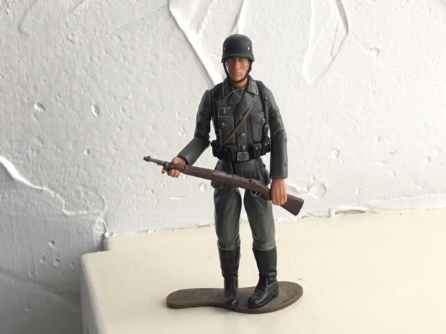

Both Arms, Shoulders, Legs, Hips, Neck have movable joints for posing the soldier.
$20 model from Toys R US. They probably cost a bit more now lol.

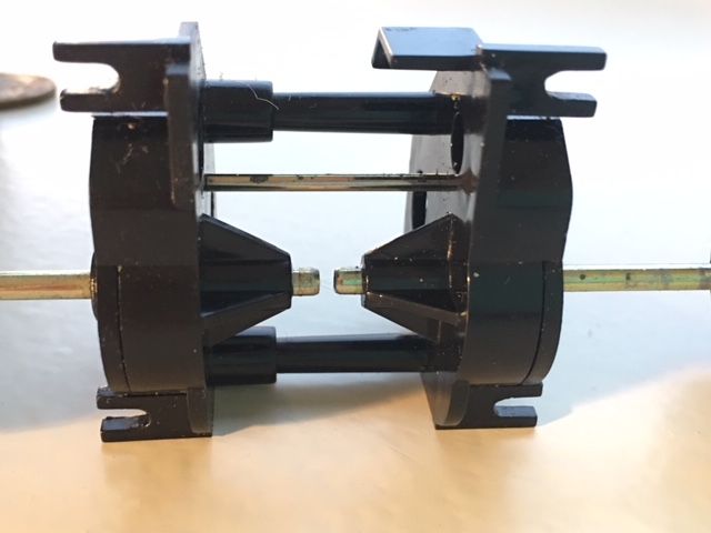

This is the largest military model in my collection for sure. I used to have a 1/16 Tamiya Leopard years ago and I ran it into the ground. Took the gearbox out then modified it for a twin prop PT boat. I still have the boat but the Leopard Tank got lost in the moving shuffle in the 80's. Anyway below is a picture of the gear box used in the Halftrack.
This came out of a goofy looking tank Toy. I bought two of them just to get the gearbox's back in the old days. I will if I can find a  picture of the Toy. It had rubber tracks. I am trying to find those too.
here is the dual motor gear box used in the build. It uses twin 130 motors. I will assemble this unit back with motors and update the picture.
