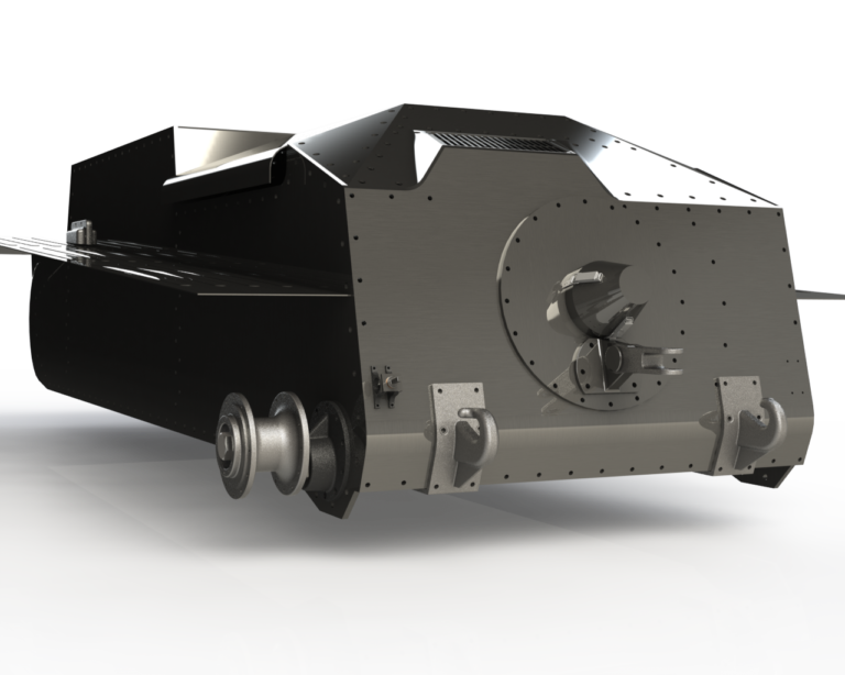

Hey all! A little while ago I started piecing together my own project of making a 1/4 scale Panzer 38t ausf A for the funs of it all. I can make a empty box easy enough but command and control systems are a magical mystery to myself so that's how I discovered this forum, which I've spent hours lurking in.
I'll be detailing the process as I go along, I'm new to most everything I'm doing and any suggestions or ideas are always welcome

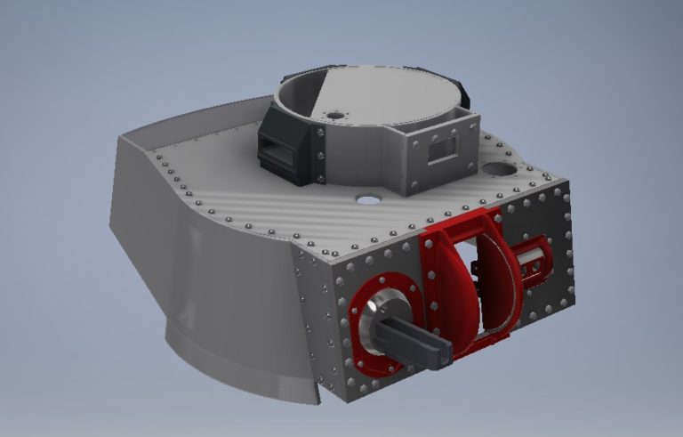

I've been doing research and building CAD files of all the cast pieces and assemblies. Originally planned on 3D printing in ABS but after a wild bout of masochism I have decided to do sand casting into aluminum once a part is printed.
The first part I finished designing was the turret. The plates are designed as flat patterns so I got some 11guage steel cut at a local place now I have to bend the steel to the correct curve. Maybe a wooden mandrel or form will be used. Maybe. Might just hammer it out on an anvil.
So yeah as it stands now I will got most of the tank designed and some parts printing, it's gonna take a lot haha.
I've also got all the plate steel cut and a basic frame designed, although I gotta redesign some parts before I try again. I'm also a terrible welder so that's going to be an issue

Re: 1/4 scale Panzer 38t
Looks good. Could you rivet it together? Welding thin plate isn't easy (not that I know how to weld).
Printer I am using is a Crealty 10 S5 Plus. I got the biggest I could find haha, so far PLA but I think I'll switch to a wax based print to cast for the aluminum parts such as tracks and tow hooks
Rivets... Possible. The frame was designed to accept rivets at full scale and didn't really like being scaled down, and furthermore 11guage is an eighth inch thick, easily weldable says my welder brother. We will be gluing rivet heads on post process haha.
Let me finish some of the printed parts and yeah I'd love to have a remote printer! If it pleases you I can give you the entire projects STL files for your help... Although I'll be putting it up on Thingiverse once I'm done too
Question: scheduled to be over 250lbs, where to source the motors?

1/8", I'd assumed you were using thin sheet: yes that'll weld. Think that's thicker than my Land Rover chassis.....
