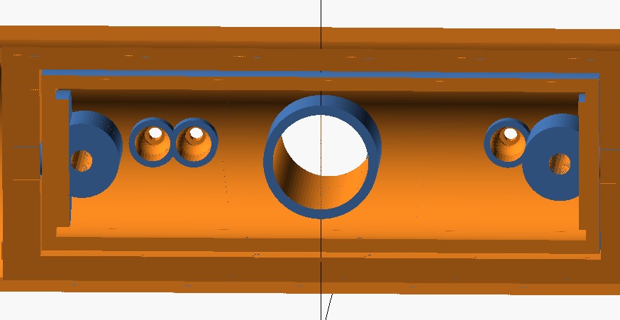

I am trying to fit the IR emitter and the FPV camera side by side in the gun sight holes in my Panther Ausf D's mantlet as i would like them to be hidden

if it helps this is the only image of the mantlet i have so far, Woz is 3D printing a large number or parts for me so that i can make my Panther as accurate and detailed as possible It has 5mm holders behind the holesTiger6 wrote:Short answer - not really much you can do other than try it? Maybe having the emitter close against the back of the mantlet would give you a reasonable brightness and cone angle against near targets, but I was advised that too short of a emitter tube would just cause the IR signal to wash out in bright sunlight (indoors you might do better?)

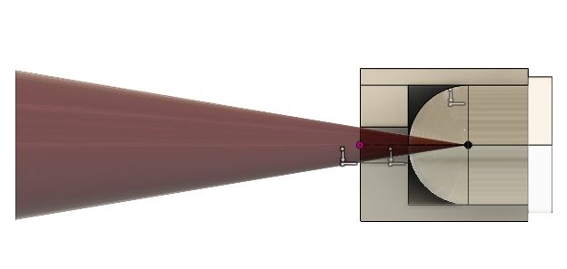

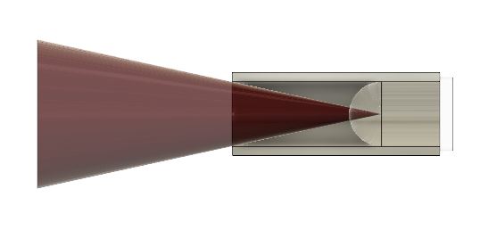

Best way I can describe the problem
The standard club set up looks like this: Your set up would look like this - notice the significantly narrower cone: (the LED and tube shown are the same size, just the picture is more zoomed in)

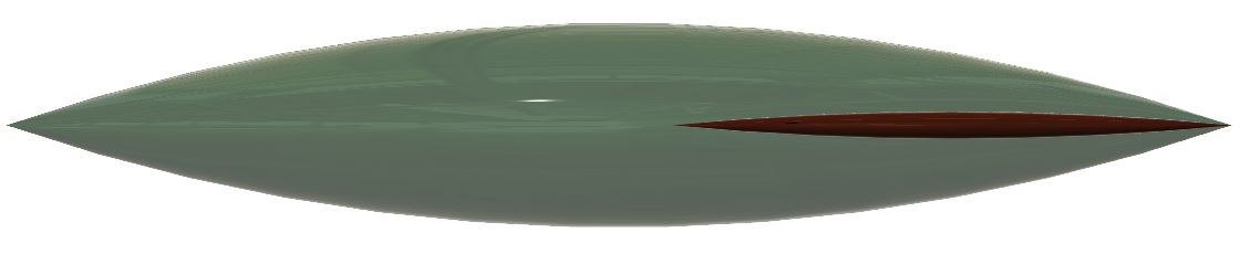

Testing by others (and Tamiya's own documentation) demonstrated that the IR beams have a roughly eliptical shape (or area of effect if you prefer). The stock Tamiya (and El-Mod) shoot out past 120ft (green area), systems with smaller emitters or different tube lengths will get a different cone - for example the red area is an approximation of how I originally set up 2 DBC equiped tanks back before I joined a club, 3mm emitters in about a 20mm long tube of ~3mm diameter. It all worked great battling in my own living room with my own tanks, but suffice to say that as soon as I tired to face tanks built to the accepted club standard (i.e. the stock Tamiya IR configuration) they mopped the floor with me to the point where the tanks were immediately ripped apart and rebuilt before the following meeting. I guess the question is - what do you want to do with your tank? If you want to FPV in your own basement/living room/church hall against your own tanks your arrangement might work ok?

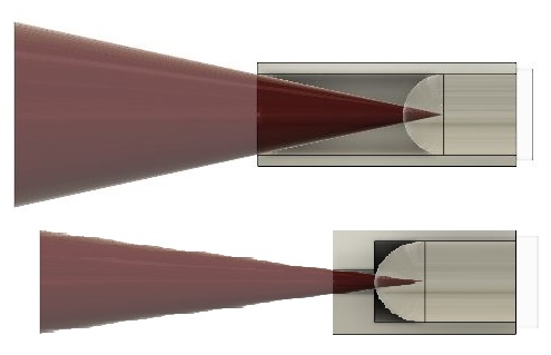

Let me scale the comparison a bit better here:
