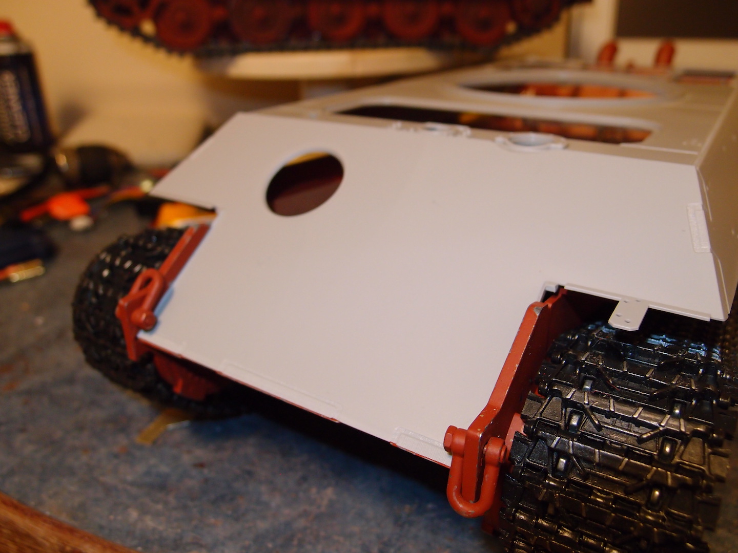

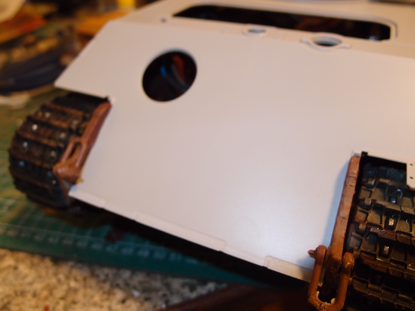

Hey there. Did you already try to mate the Tagen and Trumpeter hulls, do they fit?
ronnie42
Posts: 834
Re: Panther
Post by ronnie42 »
Front almost ok small gap viewed side on. Little off the lower hull and it may slide downand reduce the gap.
Hi Soeren better late than never

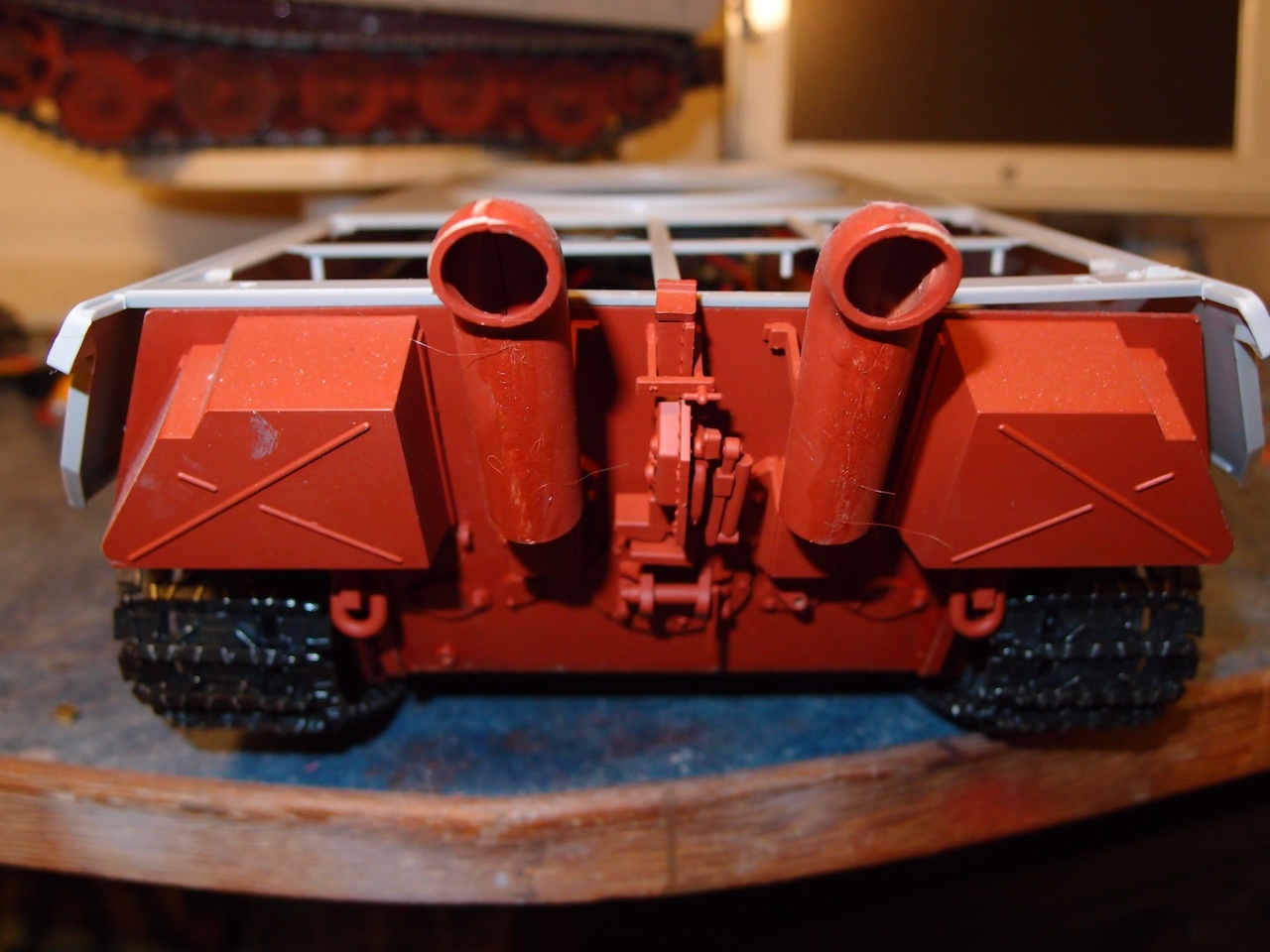

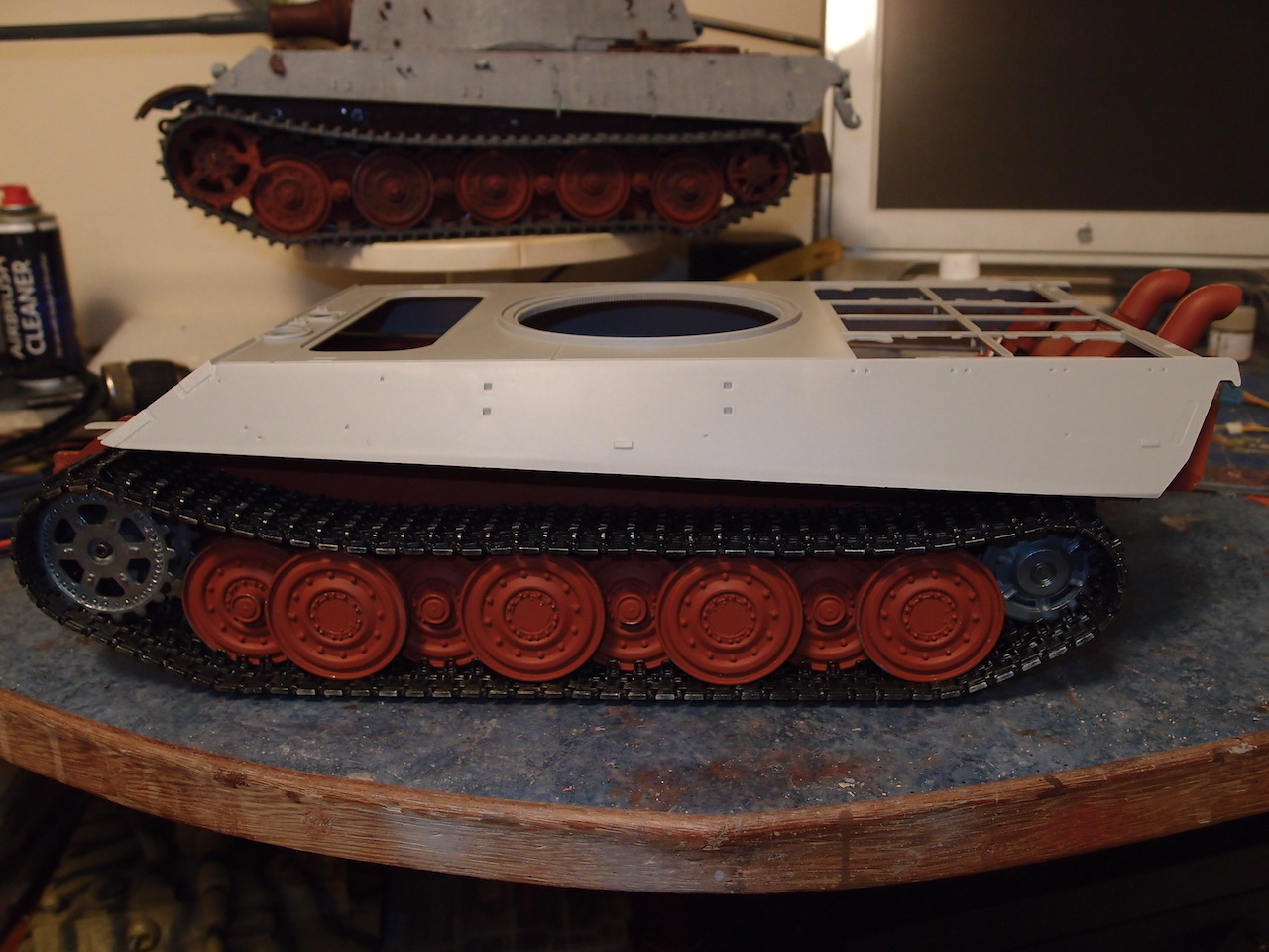

Hope this is OK. A few pictures . The Taigen is not quite as long, only the width to the rear plate shorter. The Taigen at front looks good, at there rear the trumpeters slightly wider but the kit might have inner parts to fit for scale armour plate. Fire away with questions if you need.
Side ok
Side ok
Looks bad but rear has a bow due to all the cutouts for grills etc
Gap
Gap
Sitting on rear plate so should drop down
Rear gap is less if you hold deck down.

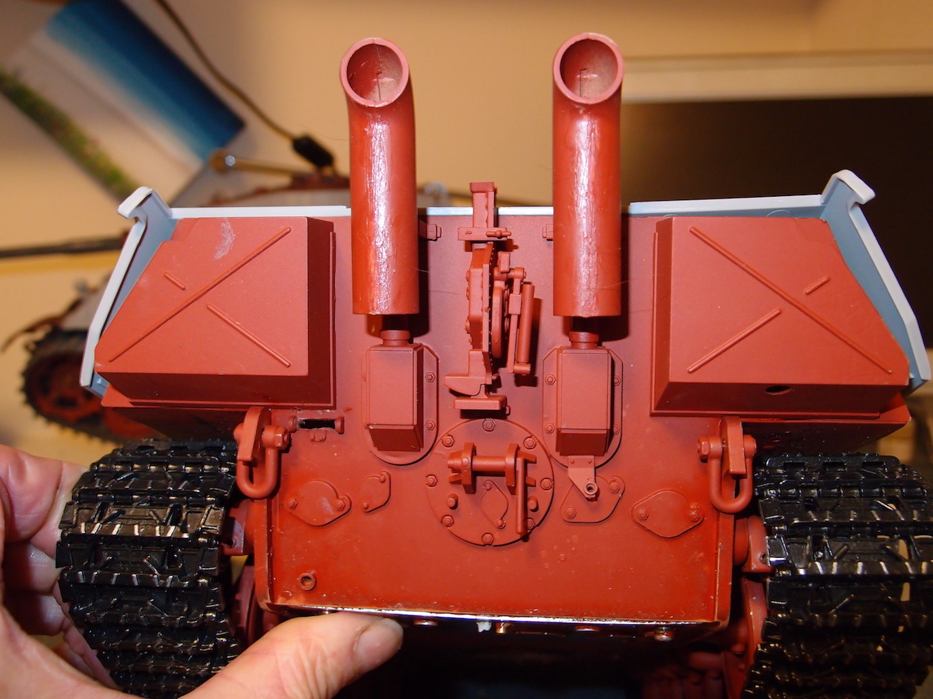

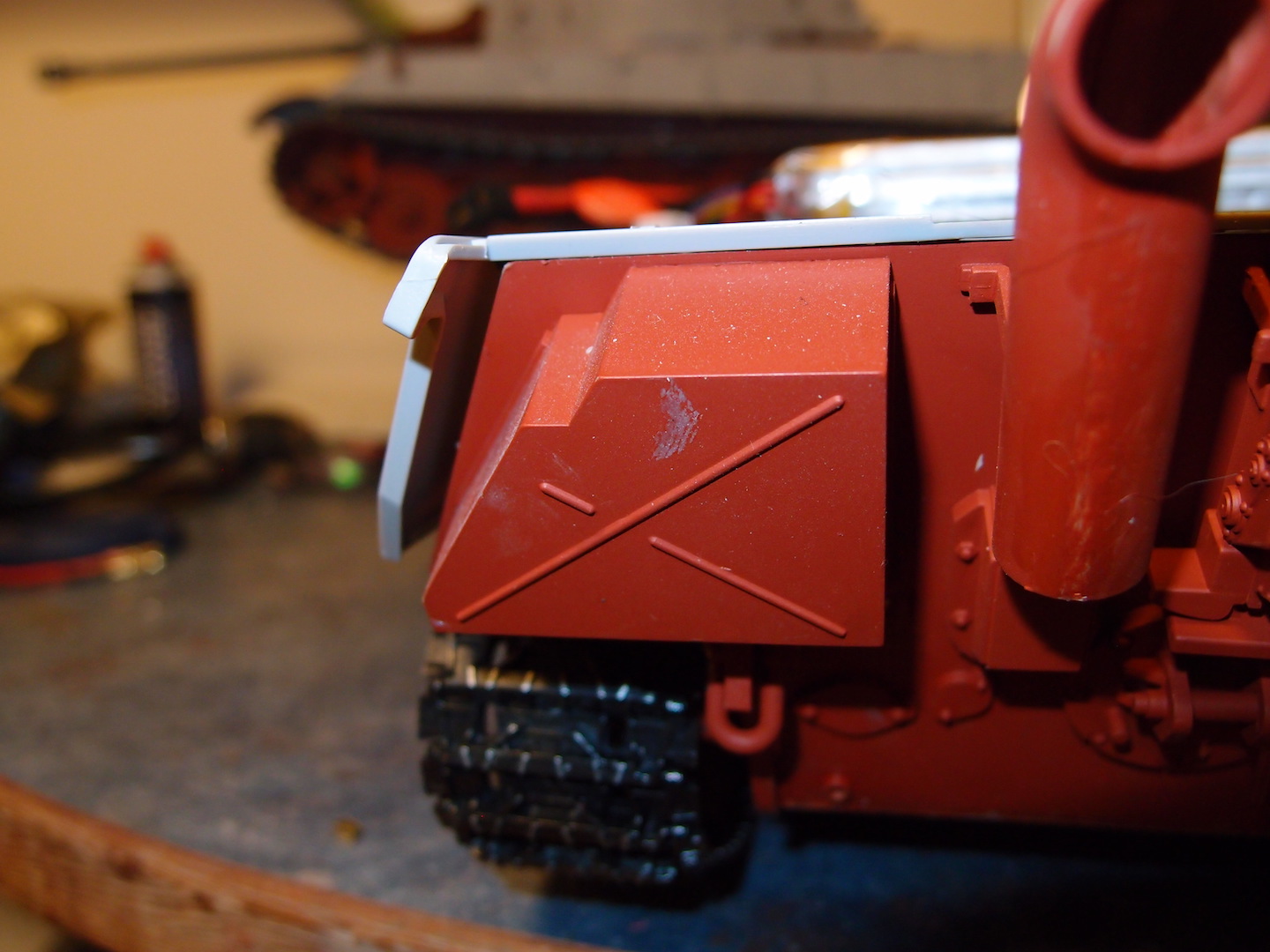

Hi Soeren

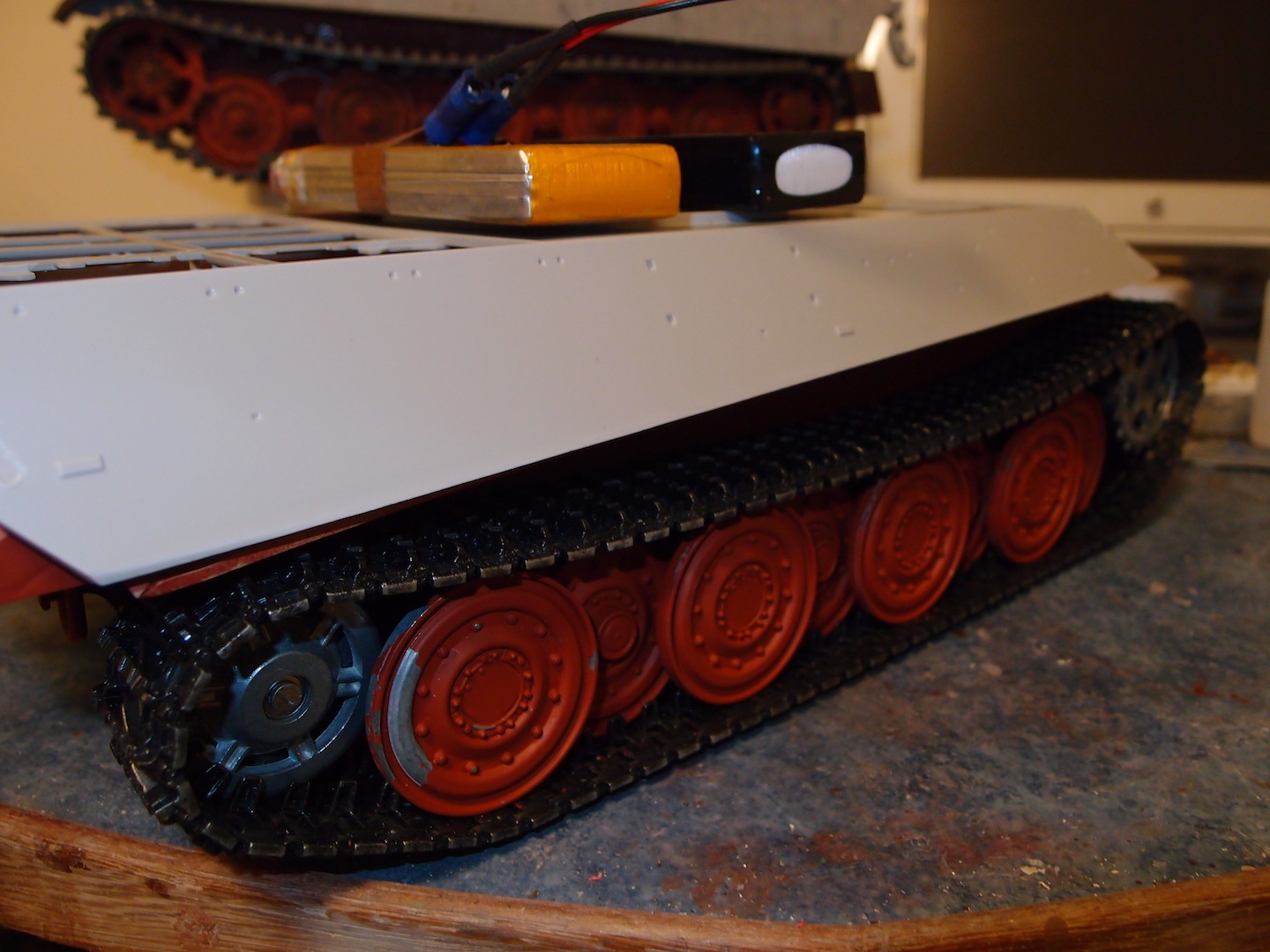

Tried Trumpeter upper hull on my HL Panther , it has had the front lower angled plate cut out and has a shallower angle now. Taigen base to top of sloping front plate is 35mm measuring vertically , Trumpeter is 31.5 mm.
Pics of the HL its a better fit due to the front angle change .
rear gap 1
rear gap 1
rear gap 2
rear gap 2
Shows fillers for scale armour to fill gaps at rear
Better fit on HL Panther, after front end slope was made shallower
2/3 mm overhang , could redo sloping lower plate
almost perfect fit at rear

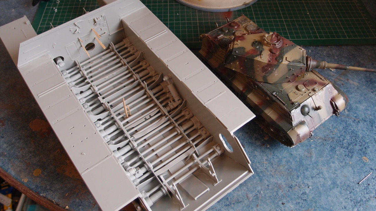

Started build ,ready for stage 7 painting the lower hull suspension. This is going to be a long build 7/122 stages and a massive parts list. Some have used metal rc tracks, saves building tracks with 4 parts per link :( .
Torsion bars work on the road wheel side.
