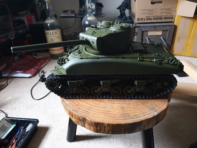

I've just bought a Mato Sherman and am very pleased with the detail of the tank.
My only issue because I got it cheap because its basically a empty shell, I cant figure out how to release the deck from the hull?

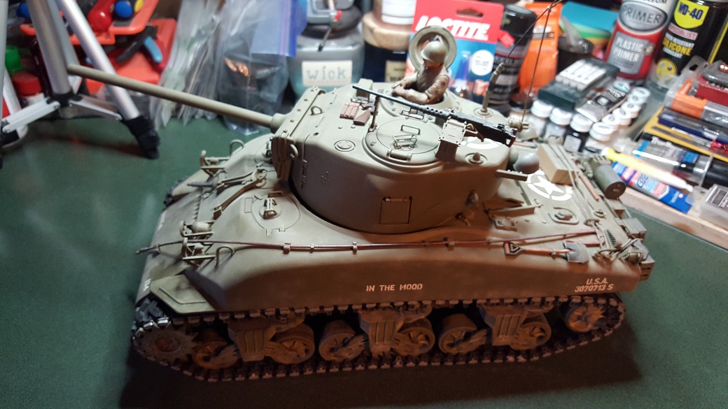

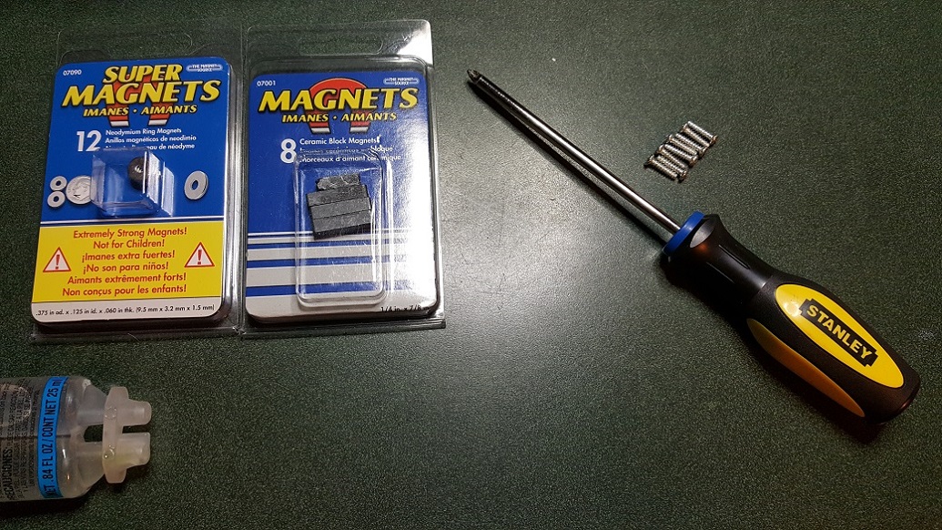

Four to a side. They can be removed with a thin, Phillips screwdriver without taking off the tracks. Thereafter, you may want to consider magnets for catches. These Shermans are getting rare and really lend themselves to extra detail. They make fine tanks with a little attention.

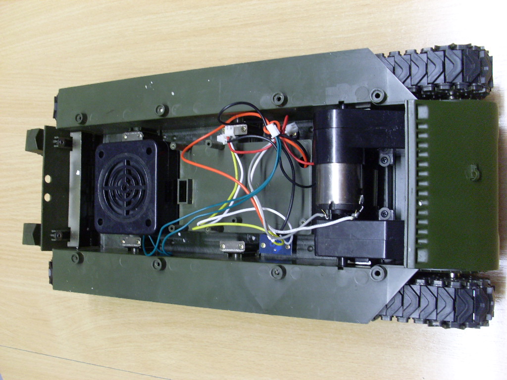

I can't really believe I got it for the money I did . Now having got inside (Cheers guys!)it has all the electrics that I wasn't expecting! I thought it was missing all these. It seems all thats missing is the transmitter.
Looking further I notice the main ounce is 12 pin and not the usual 9 that Taigen ir HL use. So can I get a transmitter or what aftermarket boards can I use ?
As it happens I've got some magnets coming today so I can finish off my King Tiger early turret, so that will be the 3rd tank to get that treatment. The Torro and Tamyia dont need it as you're aware.
