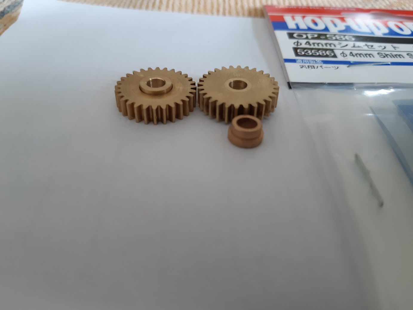

This article refers to the latest Tamiya transmissions/gearbox with the black plastic covers and is not for the required for the Pershing.I was disappointed to read of all the failures of these gearboxes when looking at them they looked well engineered so i did some research. Buy E.T.O gearboxes if you are into battling but i am not and just wanted reliability out of the stock units. First Google [ Tamiya King Tiger RC 1/16 Tank Gearbox Problem] and watch video He has installed Daryl Turners gearbox brace plus Schumo axle support bearings and still failure. Final drive gear is the culprit. Then I found this old add with a great two page article with a fix for this problem .Google [Daryls tank upgrade parts-Custom RC models.]Go down column to ALL Bronze bushing rework and read both pages. Final drive gear is the culprit. Daryl no longer produces these parts so do not ask as he does not have time and has long moved on and uses E.T.O gearboxes. I looked at my brand new Tamiya gearboxes and one was not to bad but the other had more wobble in the final drive gear than it should have when moving it with my finger. Time to find a replacement bush and carry out the modification that Daryl used to do. After searching I found [ Traxxas Oilite bushing kit x10 part no 1547]Seems like these have the correct I.D and O.D but will still require some machining to fit. I have ordered some. I will produce another article with the out come of this with specs, what i had to do and photos so if any one else wants to complete this modification they may. It is a very easy process to remove the final drive gear. Remove C clip holding axle shaft assembly and remove this section. Next remove C clip holding final drive gear assembly and move shaft sideways. You will be able to remove the final drive gear with its bush. You do not have to remove the black plastic cover to do this. This is not a fix for a destroyed gearbox as you will realize after you look at the video and the article mentioned. Regards

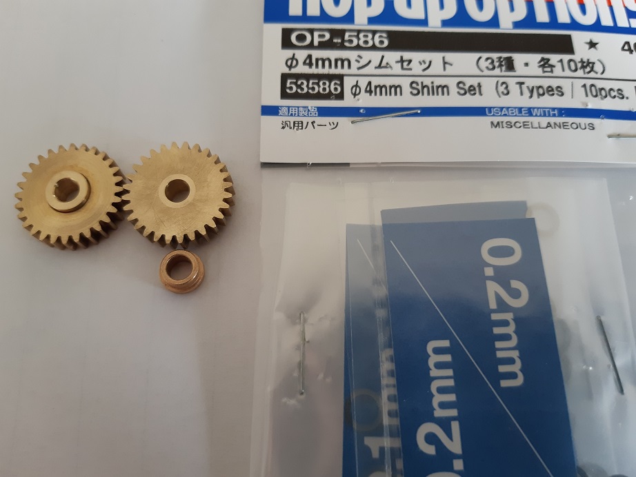

Part two of this article: Unfortunately the Traxxas bush does not have the correct dimensions so I had a engineer make me some bronze bushes copying Daryls bush which also have a interference fit with the drilled out the centers of the drive gear. After stripping a gearbox completely i found that Tamiya used the same bush in question throughout the gearbox in the other clusters. They work with those configurations but the final drive gear should have had a full length bush as we have now have made. Tamiya. One bush suits all. Cutting corners is what I call it. I also purchased a Tamiya shim kit and shimmed each gear cluster to get rid of the very loose tolerances and so each gear face matched each other rather than being offset which some are just because of excess sideways movement in the gears. I have posted a photo of the modified gears both sides, the culprit bush and the shim kit I used. In the first photo ,you can see the Tamiya bush and how much it is missing in length to fully support the gear it inserts into.

Indeed the tamiya units are bad designed from factory and they fail in the point you mention. I have them fixed with a steel bushing there.
Sorry for the tamiya hardcore fans, but all units but pershing are just bad designed and will fail.

And it happened to me. The rest of the gearbox was fine except that wheel and the one next to it, just because the bad design. In the rest of my tamiya tanks I installed a steel bushing and they are running perfect for years.
It is indeed a massive design flaw that they corrected in the pershing unit...

One thing i know from my past profession is a oil based grease will weaken plastic and nylon through soak from the oils.You cant see this happening by the human eye but it is so that is why Tamiya recommend their ceramic grease for their gearboxes.It is not oil based.There are plenty of greases out there that are not oil based.When you kook at Tamiya;s early style of gearboxes they were heavily dependent on plastic/nylon gears so ceramic grease.The latest series of gearboxes still has some nylon gears and the turret and elevation motors also, so what do they recommend.You guessed right.All i know is if you apply oil based grease to plastic/nylon drive gears you may not realize it but you are helping towards premature wear and failure.Regards John.
