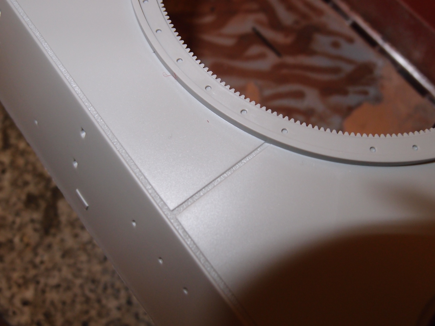

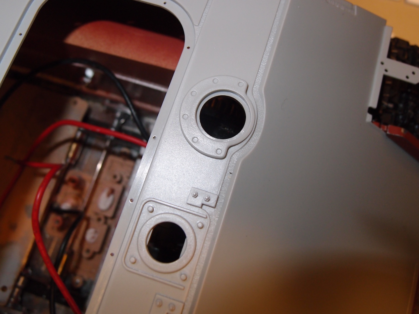

Hi Wardog Thinking about doing my Kingtiger welds , now i have the Trumpeter Panther 1/16 kit the welds are rather neat .
That why i am thinking of 1/35 zim strips doubt i could manage a subtle weld line with milliput . Here are some pics of the welds. I wonder if a 3d printer could produce fine strips of weld lines , then that might tempt me to buy one ?

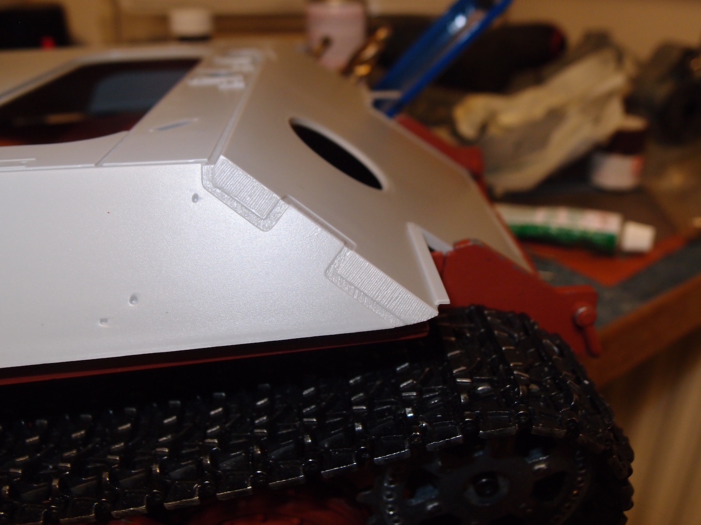

Weld lines give you a lot of bang for the buck. They can be tedious to do in the beginning but once you get the hang of it they are relatively fast and easy. Your first step is to research the tank you are working on and get a good idea of the quality, location and size of the welds.
Attached are photos of welds I've done. I do knock them down carefully with mild sand paper after the putty sets. I use the two putties imaged, and I use on the putty tubes fresh, read new, gel ACC glue tube ends. Practice first on scrap. When you begin a line, make sure you have a shallow dish filled with water and a narrow straight blade screw driver. Before the putty sets, dip the screw driver blade in the water and use it to form the ridges in the weld line. Again, I stress, practice practice practice before you start on the model.

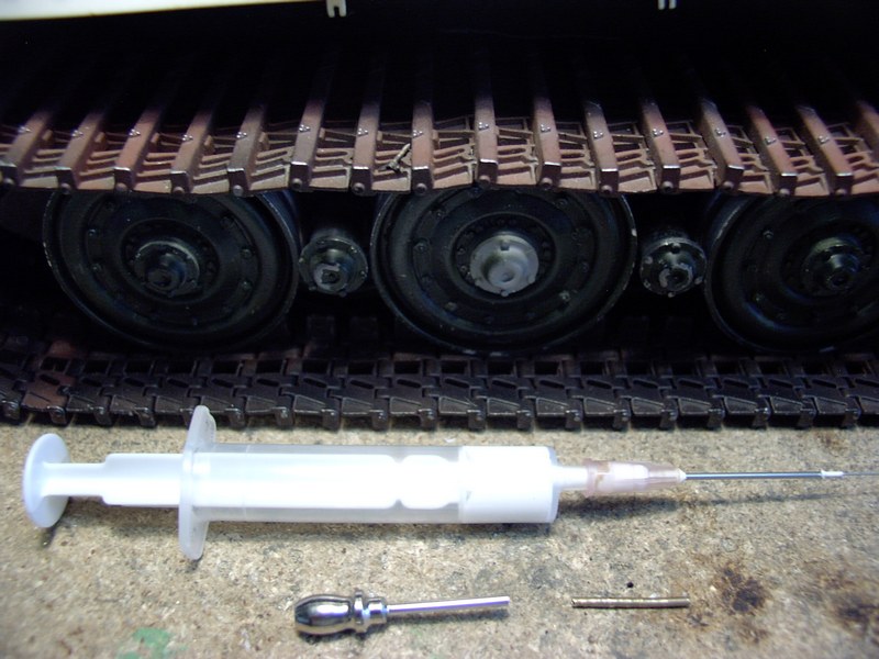

I don't know how 'available' syringes are for most of you, but we can pop down to Abteka and get whatever we want. For large weld lines, I've been known to speak to our vet and get larger needles than are generally used on us two legs. Works, and the larger needles are easy to clean after the work. The very thin needles, syringes are dirt cheap so when it's used, cut the actual needle off, bent it up and trash the needle and syringe. I cut up the actual syringe body and the piston, too.

Wardog, in this AO, vets can and do sell to their clients, but reality is the only thing I've ever needed from him is the horse needle imaged above. My wife knows enough about dogs and their needs, we've got more than one, to have syringes and almost a full apothecary on hand. Any time I need a syringe it's a simple 'where are you hiding them now' deal. Syringes also make excellent pinpoint oilers for getting in to the nooks and crannies of the transmission.
