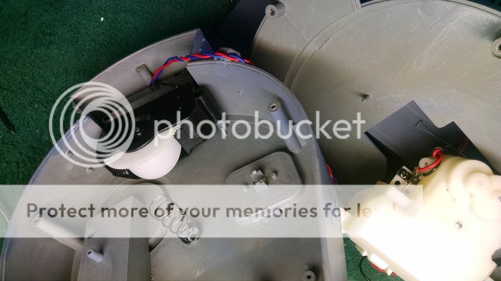

I drove my Tiger into my couch barrel-first and managed to break the servo that raises and lowers the main gun. This is a new 2018 Tiger 1 with the latest 2.4g radio system. I pulled the turret and took the servo apart but couldn't find any stripped gears. So I reassembled it with my best guess of the position I should use for the cam gear, but it was only able to lower the gun and not raise it any longer?
I noticed two things, one that there is a stop molded in the cam gear and the case of the servo, and two, that I had a small washer left over after reassembly.
Now I'm wondering if I can disassemble the servo again, remove the molded stops and use it like the previous 2.4g system, where lowering the gun causes it to rise again? Or did I just assemble it wrong? Any thoughts appreciated!

I describe the black box at the back of the turret behind the airsoft unit which drives gun elevation as a servo, although there is no doubt a better name for it within the ranks here.
I'll attempt to take some pix when I have more light and have it apart again in a few hours. Maybe then what I describe will make more sense.

Thanks to all for the helpful suggestions. It is indeed the old version with the large gear with cam atop. I spent a pleasant hour removing the unit and found that the motor would only respond in one direction, to the down position on the left stick of the radio. Because this was supposed to work both up and down on the stick (and did for two days), there was a molded stop in both the large gear and the servo casing. Quick work with dremel and cutoff wheel removed these. Reassembled, the unit now works the same as the earlier 2.4G radio system. Holding the left stick down continuously will now cycle the unit (and the gun) down, then up and so forth. An easy fix to a mysterious problem!
