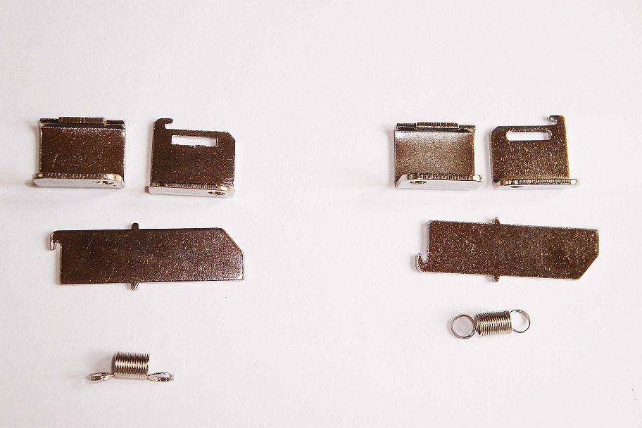

Does anyone have any detailed photos of the spring- loaded quick release mechanism for the Taigen Panzer 111? If you happen to have the model, maybe you could take a couple of shots and post them here. :thumbup: It's not the most intuitive of arrangements, it has to be said, and involves using a screwdriver to press in two release levers located in slots to the rear of the lower hull..
The bits arrive in a packet and, I can only find three return springs; where one possible arrangement suggests there should be four. :think:

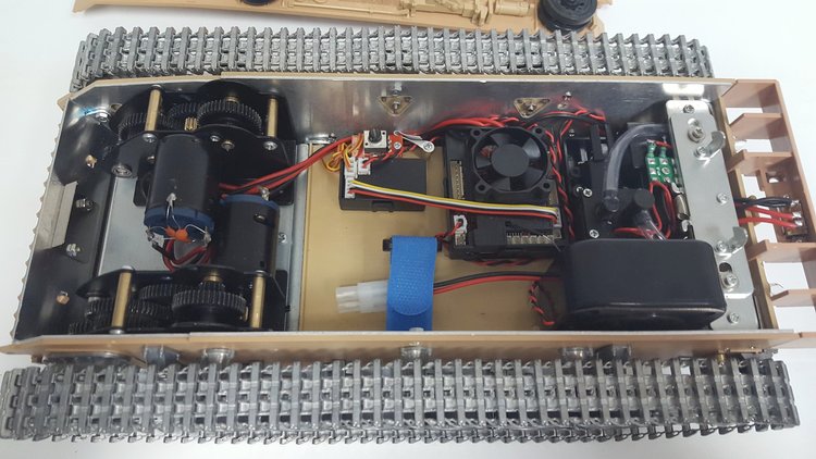

This is what the revised locking/latching lower part looks like:
Taigen 'Metal' ed Pz 111 with V2 electronics...
Taigen Panzer 111 Metal ed with V2 electronics.jpg (78.51 KiB) Viewed 1463 times

This is what the hull looks like, when you buy it for an upgrade from the plastic version, or for a home built project. You can see the latch mechanisms on the right. In the description, though, it states that the hull is suitable for the 'Metal' edition. However, there's no evidence of the sliding plate latching system here, we see in the new version above. I'd wondered, in fact, whether the latch setup supplied with the hull is actually incomplete, and this is the reason why it's so unintuitive to fit....but I think the answer is that it is complete. Well, there's always the magnet option. ;)

Here's the older system that still comes with the new hull when bought as an extra:

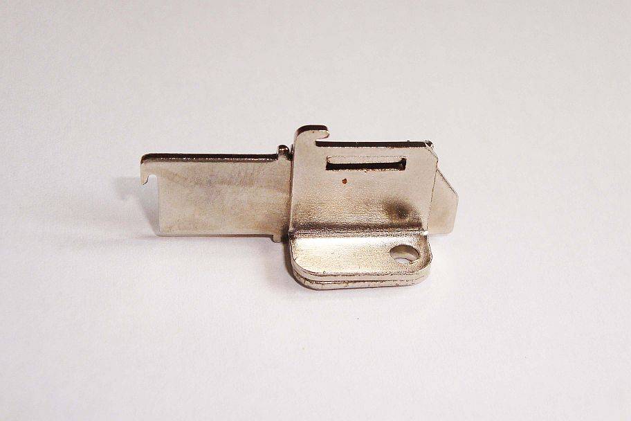

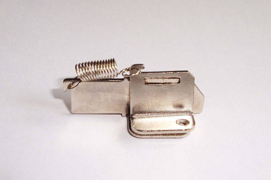

Panz 4_zps3wa8cn6k.jpg (59 KiB) Viewed 1419 times
Panz 2_zpsscbo3cc8.jpg (46.51 KiB) Viewed 1419 times
Panz 3_zpsqpe4fatl.jpg (47.56 KiB) Viewed 1419 times

Many thanks, Dave, that's just what the doctor ordered :thumbup: Very clear.
