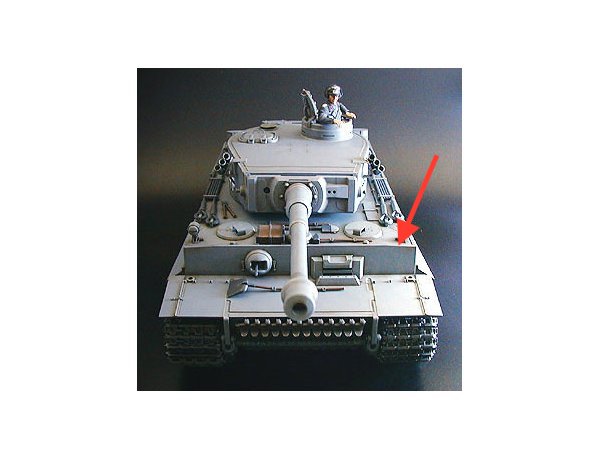

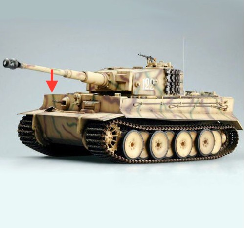

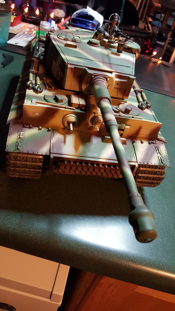

Is there a chance that Trumpeter might have a more accurate upper hull, Shaun and Lert? At least they've managed to get the bevels on the top of the front armour plate right, as have Tamiya. Taigen/HL have a straight edge there, and it's completely wrong.
Taihen Tiger 1 with straight edge to front armour plate
Taigen Tiger 1.jpg (76.15 KiB) Viewed 2208 times
Tamiya Tiger one with sloped edges on top of front armour plate
Tamiya Tiger 1.jpg (32.86 KiB) Viewed 2208 times
Trumpeter Tiger 1 in 1/16
Trumpeter Tiger 1-.jpg (41.05 KiB) Viewed 2208 times
I think 'Hobby/Boss' also get that detail right. Maybe they get some of the others right too..
This anomaly is one of my bugbears; but otherwise I'm pretty happy with my two Taigen Tigers...
