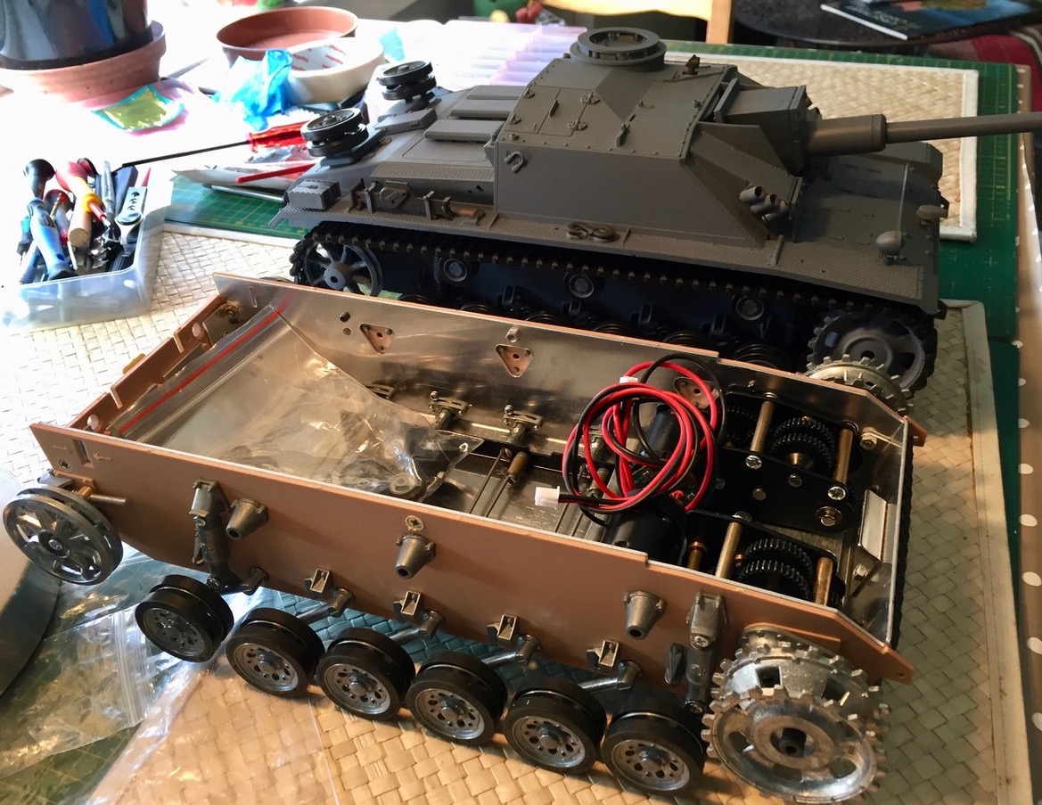

This might evolve into a build thread, but for the moment, it's more of a product review. The Taigen StuG 11/Panzer 111 alloy and plastic lower hull is something of a bargain, I think.
Our esteemed Forgebear sells it:
https://www.forgebeartanks.com/store/p4 ... Scale.html
But the version I got, with all the bells and whistles, came from rctank.de
https://www.rctank.de/Panzer-III-StuG-I ... res-system
They both represent value for money, and a great start to a build; but I opted for the rctank's offering as it comes with virtually every component of the lower hull. Dave at Forgebear can also supply all you need. :thumbup: As an incidental, I was buying other stuff from Dominique at rctank at the time, so it made sense to get it all in one package.
I only wish Taigen had produced an alloy/plastic hull of this quality for the Panzer IV. I went with Asiatam's ill-starred alloy offering, and whilst it can be made to look good; nothing fits as it should, and you need to be signed up to the Magic Circle with a talent for sleight of hand, and a Dremel, to get a decent result. :|

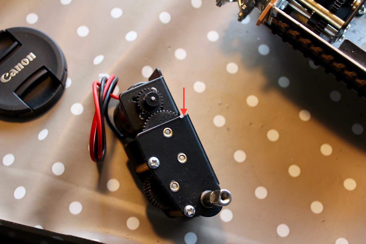

So I'll just mention a few issues you'll likely have to deal with if you use this Hull for your pet Panzer 111, or StuG 111 project.
The first concerns getting the gearboxes to sit squarely on the Taigen mounting plate, so that not only the fixing screw holes line up properly, but also that the output shafts are plumb centre in the gearbox casings.
Estniches solution was to enlarge/ relieve the holes in the gearbox flanges.
But I found the source of the problem was a screw head protruding into the gearbox zone (The screw holds the suspension arm bump-stop in place)
This is the one, indicated by the arrow:
Taigen StuG 111 project- gearbox fitting problem

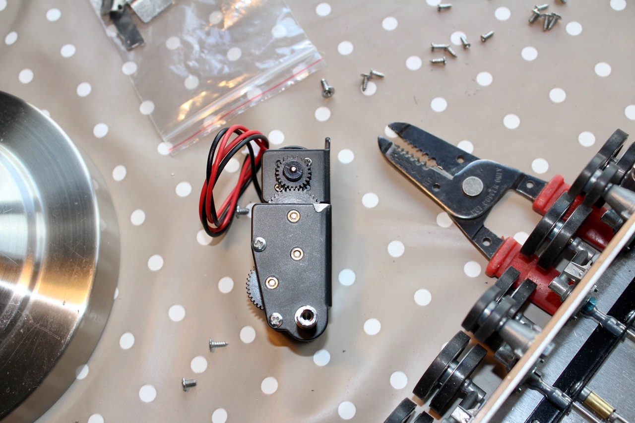

In this instance, what I did was to grind a little off the screw head, with my trusty Dremel
Then I ground a wee dip into the gearbox casing (having marked it first), sufficient to relieve the screw head.

I used the same fix on the other side, although the screw was in a slightly different position. The arrow indicates where it made contact with the gearbox side:
Taigen StuG 111 project- gearbox fitting fix

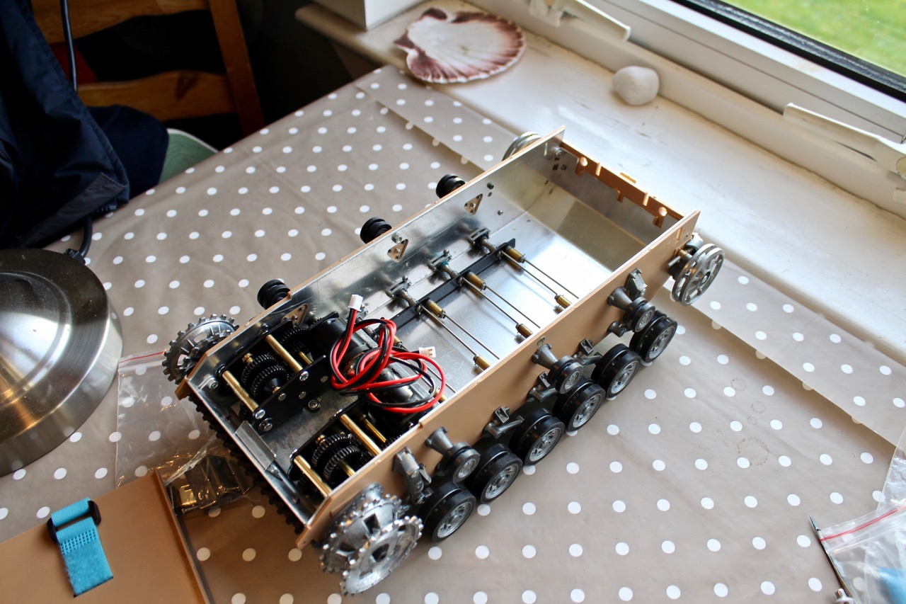

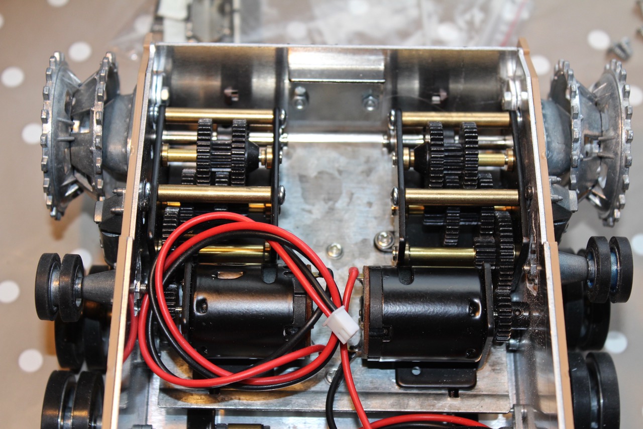

Both boxes fit well:
A spot of grinding (without the bumps.. :) )
Taigen StuG 111- gearbox fix pic E
Taigen StuG 111-gearboxes properly aligned
Yippee

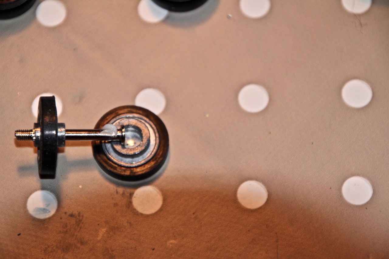

The other bits and pieces that come with the package fit pretty well. Taigen have even tried to improve the return roller fittings. If you've used the ones from the Asiatam/Taigen days, you'll know just how niggly it was to bond to two parts of the rollers together, without glueing the shaft solid at the same time. >:< ... then the next problem emerged of the roller shaft having no real means of being locked in place. Tightening the locking not on the inside of the hull wall, also tightened the pull on the roller..creating annoying friction. Tamiya rollers, by comparison, are a joy to fit, as the shaft has a 'D' profile milled in at the locking end, corresponding with a 'D' recess in the roller housing. Early iterations of the Taigen.Asiatam setup had none of that refinement. Often when whole thing would spin round...even after the judicious use of thread locker.
Now the revised shaft has fluting on the inboard side, which wedges into the plastic of the hull, where the plastic acts as a sort of lock washer.
Taigen StuG 11 return roller A
But first, it's necessary to relieve the inner (female) part of the outer wheel, to accept the stub of the inner one. I use a slow speed 6mm hand drill for this, and also had to file off a visible burr on the inner stub.
It was a fairly tight fit, but then I greased the shaft with Tamiya ceramic grease, and having dabbed some strong thread locker on the mating surfaces (ooohh.. tank porn, eh? :haha: ), pressed them together with some force.... and pliers. the Tamiya grease ensures that everything spins as it should. :wave:
Taigen StuG return rollers pic B
