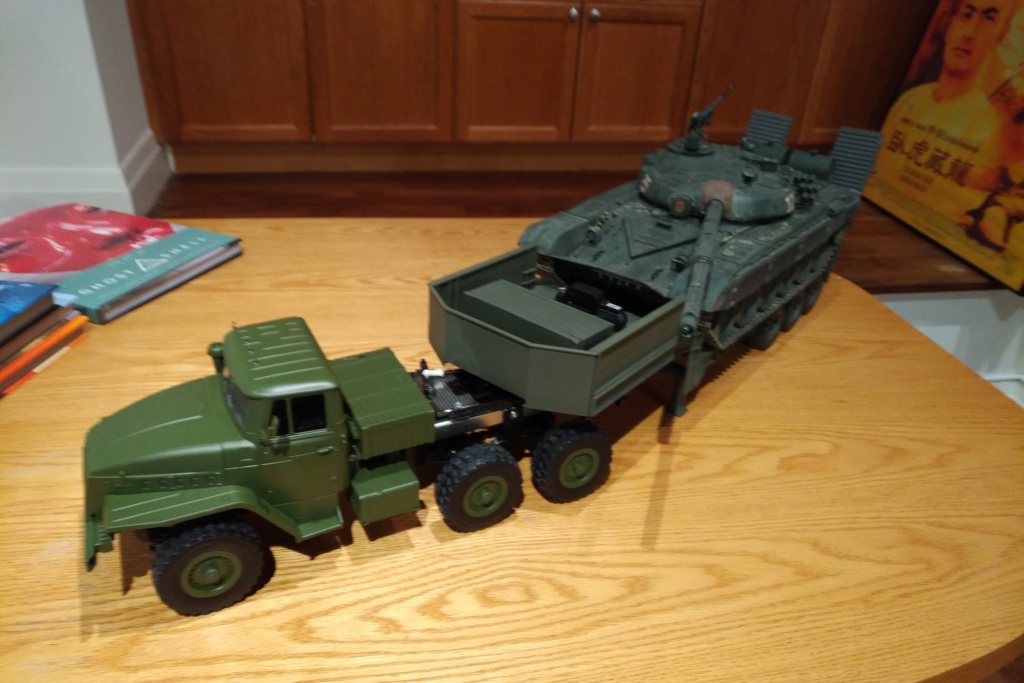

Here is a converted Bruder with a WPL Ural truck. Probably a little short for a Chally but you can give it a go.

Well that's a great heads up especially if all you want is a longer trailer but to carry a modern MBT it needs to be widened as well as massively beefed up
I have tried to modify a pair of Bruder low loader trailers and the biggest problem in my experience is the Plastic that Bruder use is very brittle,
Carrying a JJRC 6 wheeler is no problem but a fully loaded (sic) PZ4 asks a lot from it,
It is after all a cheap (£30-ish) childs toy.
The lack of any sort of suspension is another weak point.
My solution is I fear a trifle too extreme for some,
An HG 802 8 wheeled r/c 1/12 articulated truck and an HG 806 r/c 1/12 Multi-Axle Trailer,
Both items are nearly all metal and electronics but that brings an inevitable downside and that is the approx £800 price for the two items but the truck does include a multi-channel transmitter and receiver
The trailer can be bought fully assembled or save £60 and buy the kit, (Doddle to assemble)
The 1/12 scale is not as far out as it might seem,
My 1/16 Heng Long M1A1 Version 6.0 Abrams looks just right riding on the trailer whereas it is massively oversized in the presence of the 1/16 Bruder trailer.
