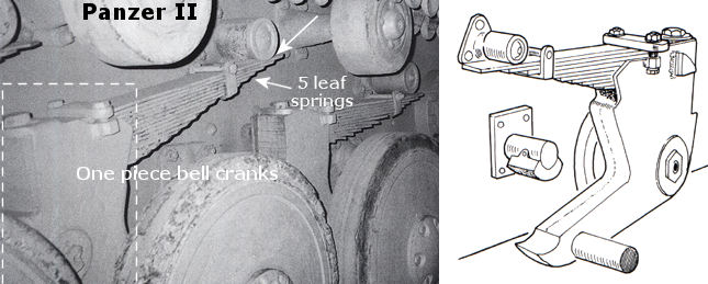

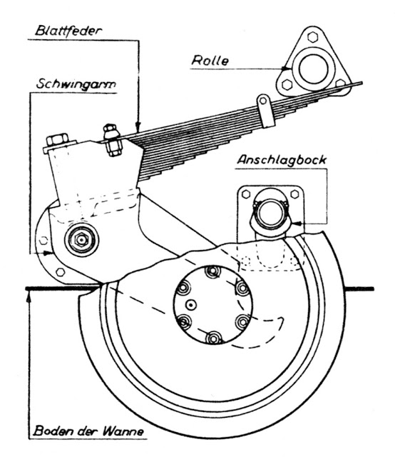

Although i'm not at a stage where I will be mounting suspension on my Panzer II hull I am in the research stage!
I find myself needing to source flat Leaf Springs for the suspension and at the moment all I have in mind are Bow Saw Blades which will need to have the teeth removed. I have looked online for sources but can't find anything suitable or in quantities in need.
Each Panzer II has 10 Swing arms and each swing arm has 17 leaf springs. The longest is 120mm and the shortest is 30mm. There is a bolt that travels through all of the Springs before fixing into the swing arm. So what I need is Annealed Leaf springs 15mm wide and 1mm thick that I can cut to the necessary lengths.
Does any one have any idea where I can get the materials I need? (Photos added to give an idea on what i'm blathering about?}
