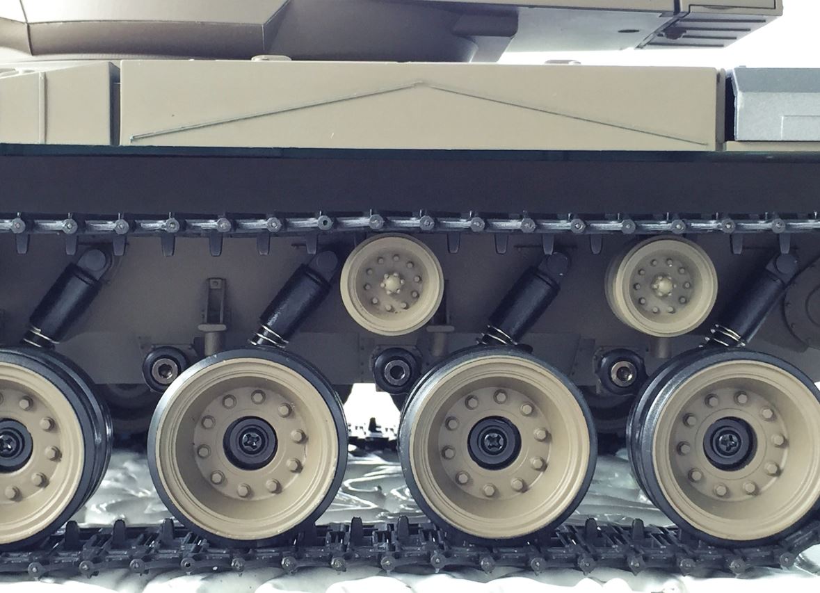

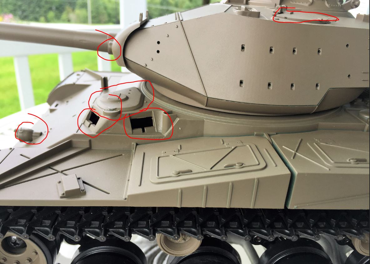

Presenting my new project, something a bit more main stream and simpler, the rebuilding of a Heng Long M-41A3 Walker Bulldog in ARVN markings. We all know the model is full of flaws, and fixing a lot of them will be core of the project. I used to own an M41 when it came out a long time ago that I modified with new gun and a few fixes but I was never happy with it and as soon as the electronics gave up, I put it in pieces for spare parts. This time, I am more experienced and I am going all the way.
The model will feature;
- reworked hull and fenders
- resized tracks
- new gun barrel
- gun recoil and flash
- TK-22 control board
- headlights and taillights
- Tamiya M2 MG
- general detailing

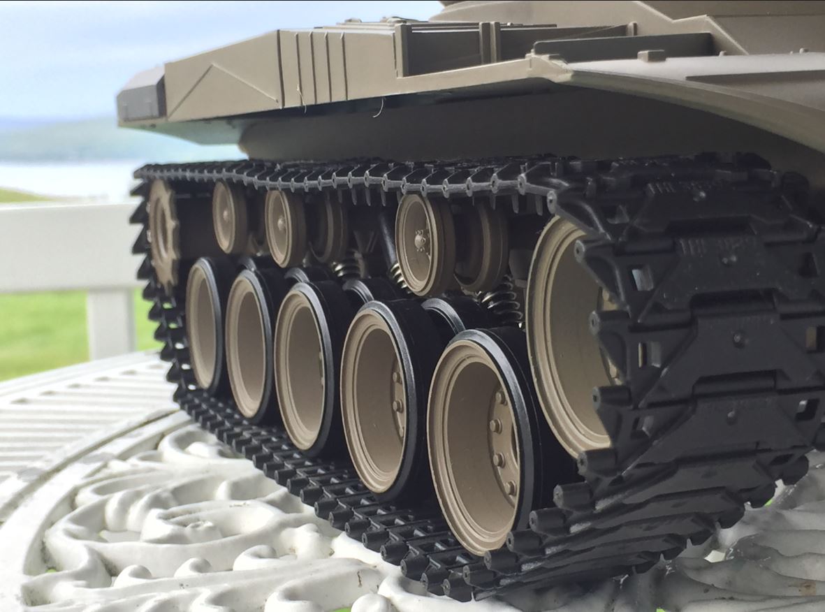

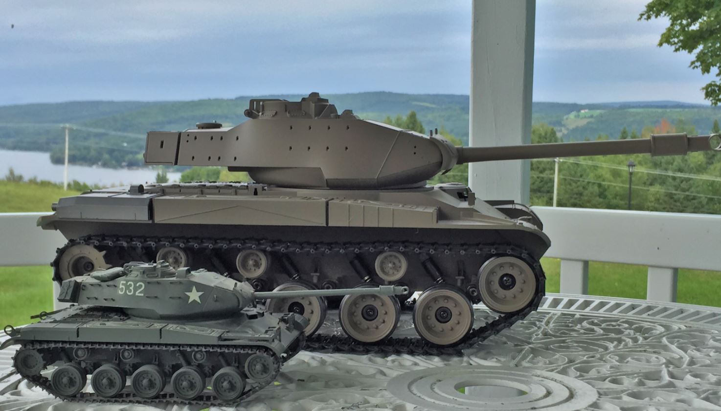

I was happy when i noticed that the M41 was shipped unbuilt with all the details and accessories still on sprues, it will save a lot of time and allows for easier modification and reuse of these. And I will be helped by documentations and my faithful but old Tamiya M41 that I build as a young kid in the 80s. It will be useful mainly for hull dimensions.

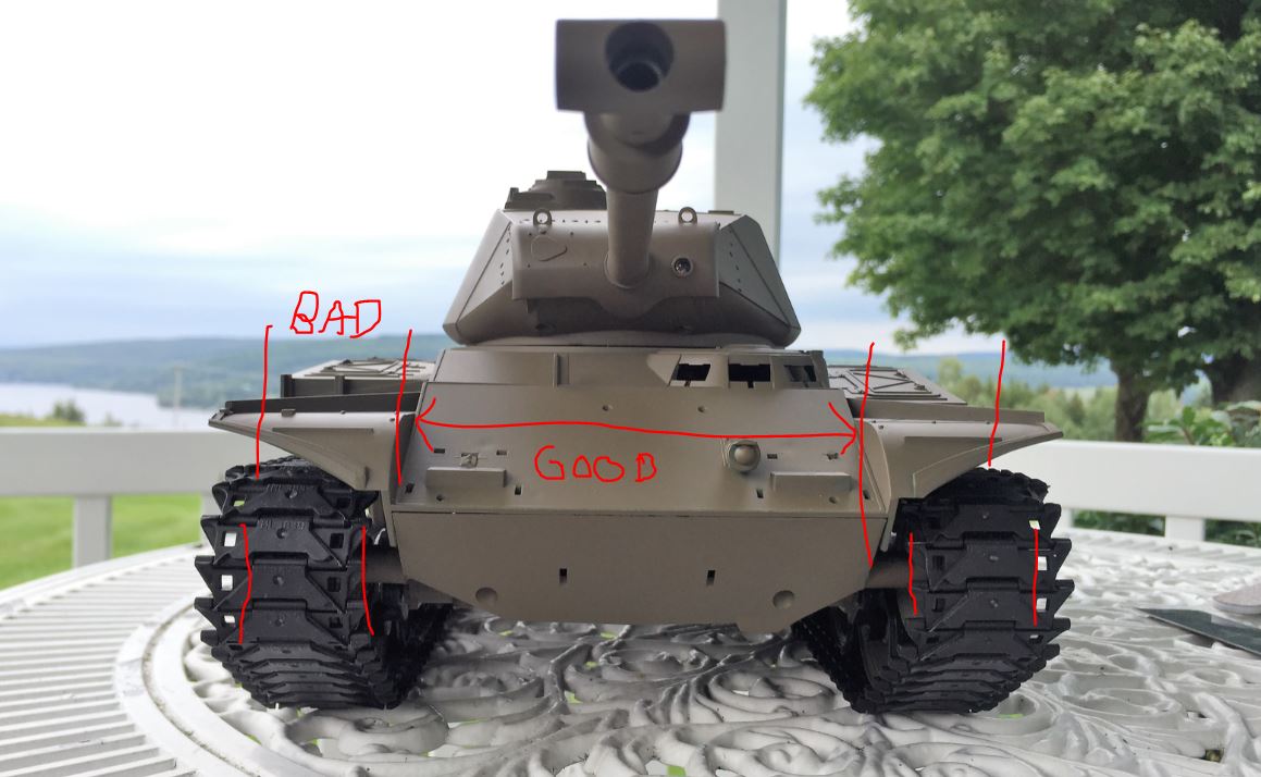

The good news is that the hull width is of the right dimension. The fenders and tracks will need rework.

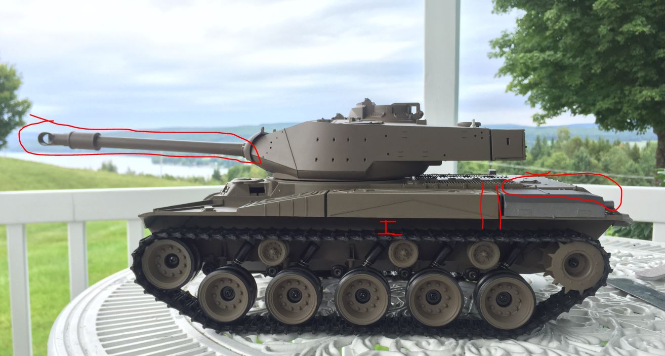

Barrel will be replaced, hull lowered and shortened as much as possible, and the slope on the back battery plate will be fixed. I found the turret shape and size to be incorrect, too short and too narrow.
I've seen builds where the modeller removed up to 10mm in height. After a lot of picture and plan analysis where the space between the tracks and fenders always seems to be different, I have determined that I should remove between 7 and 7.5mm in height.
I have a plan to get rid of the shock absorbers on wheel no 3 and 4, more about this later.
Lots of modifications planned in key areas. You will not recognize the fenders when I am done with them.
M41 gearbox needs replacement because it is too high, a HL Jagdpanther gearbox should fit well in its place. Notice the notch at the back of the hull, this is a factor to account for in the resizing and reshaping of the hull.
This is it, let's go.
Regards, Louis

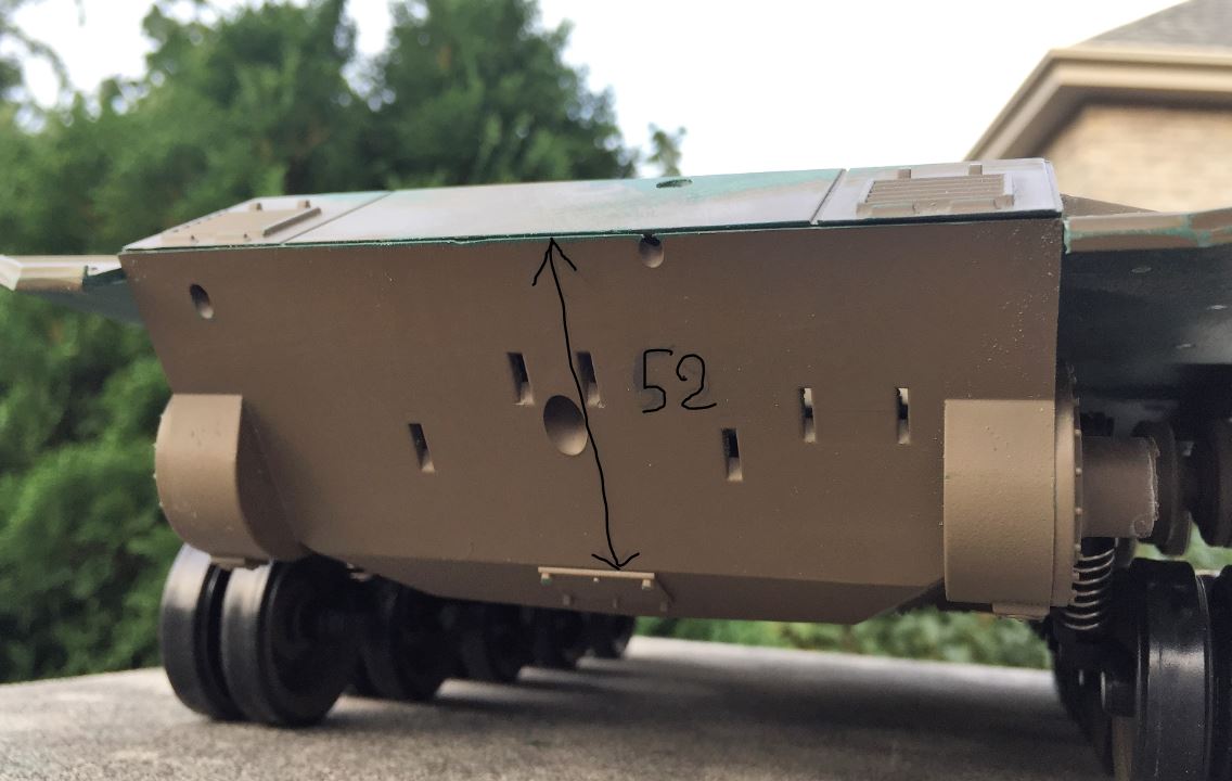

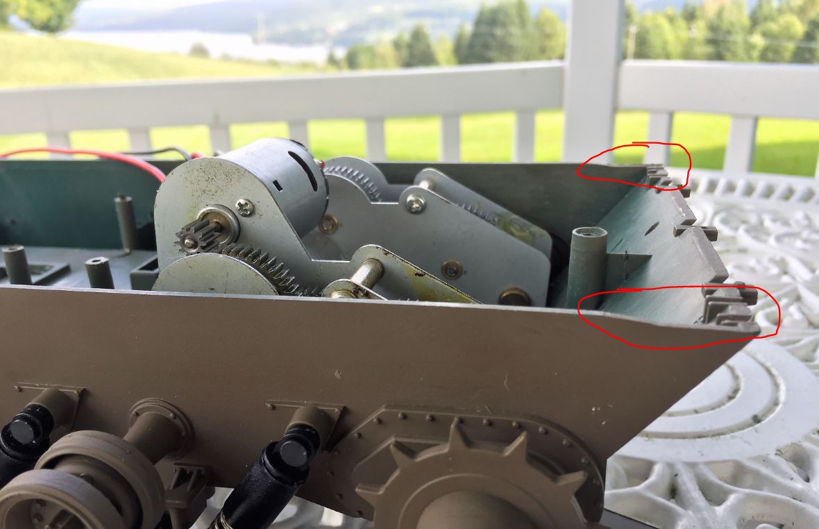

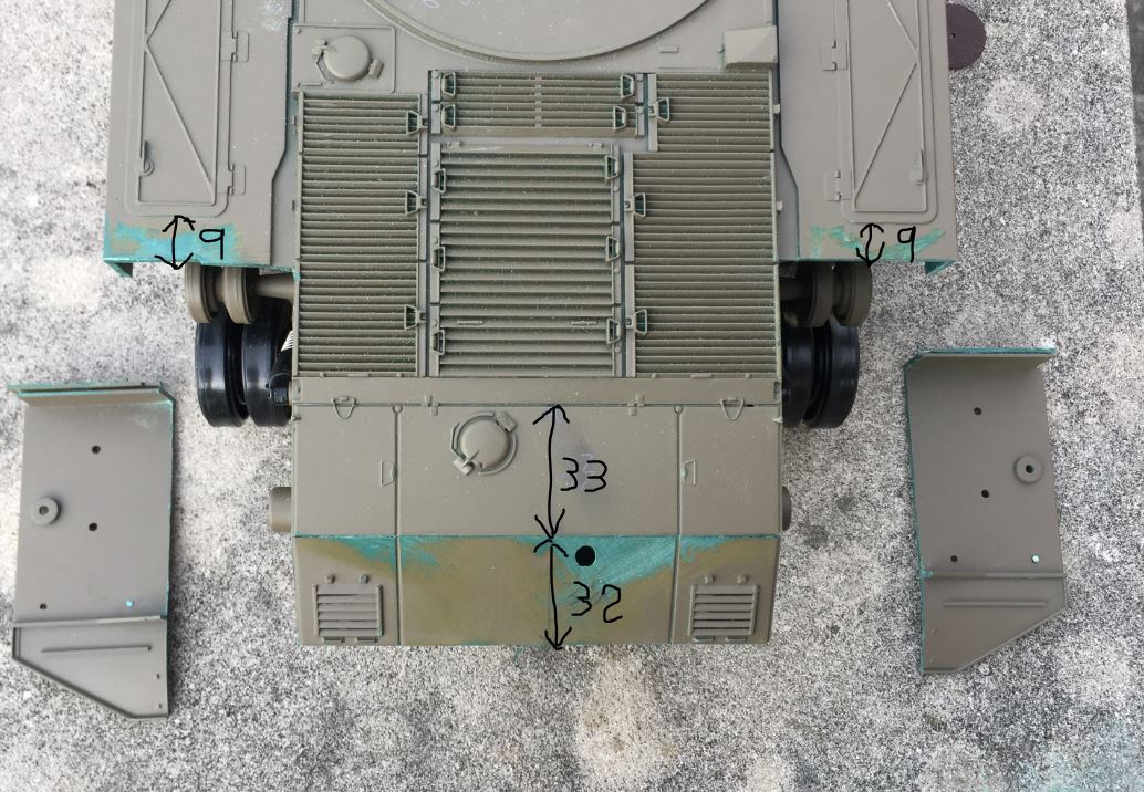

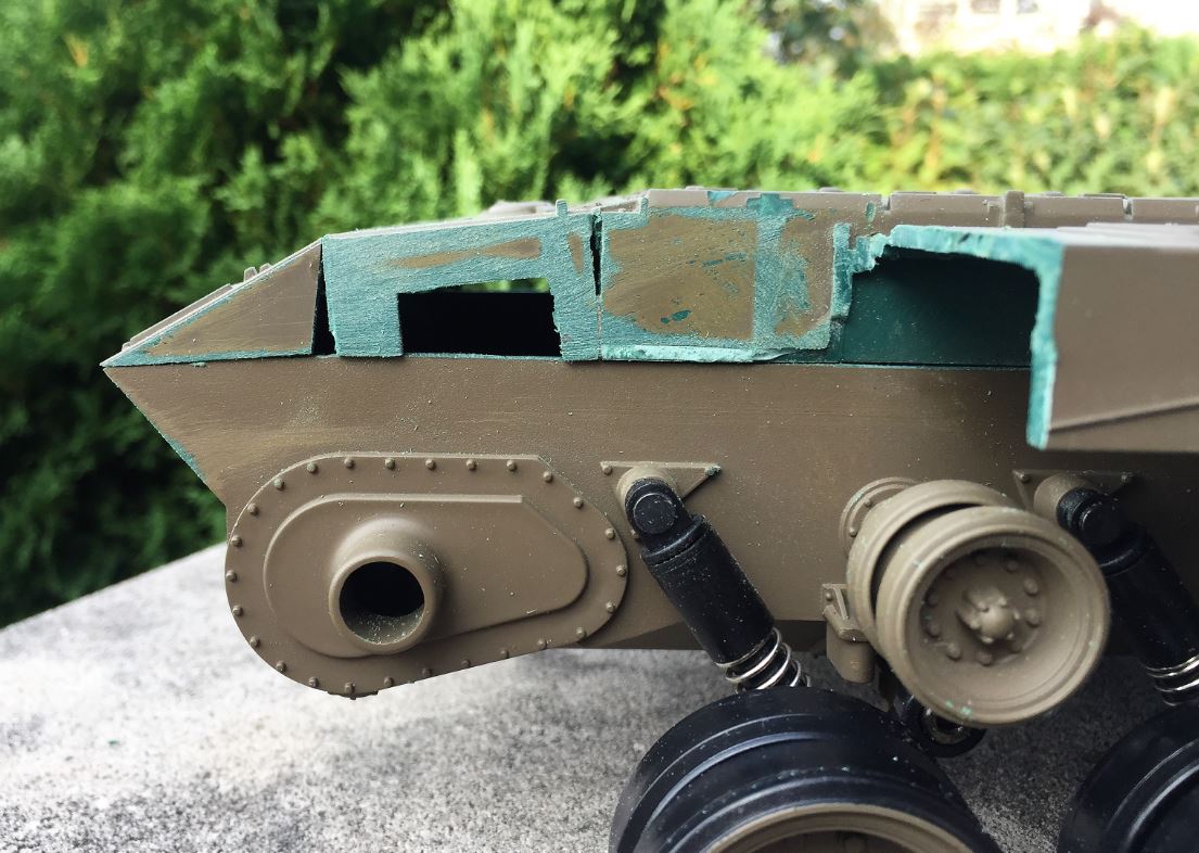

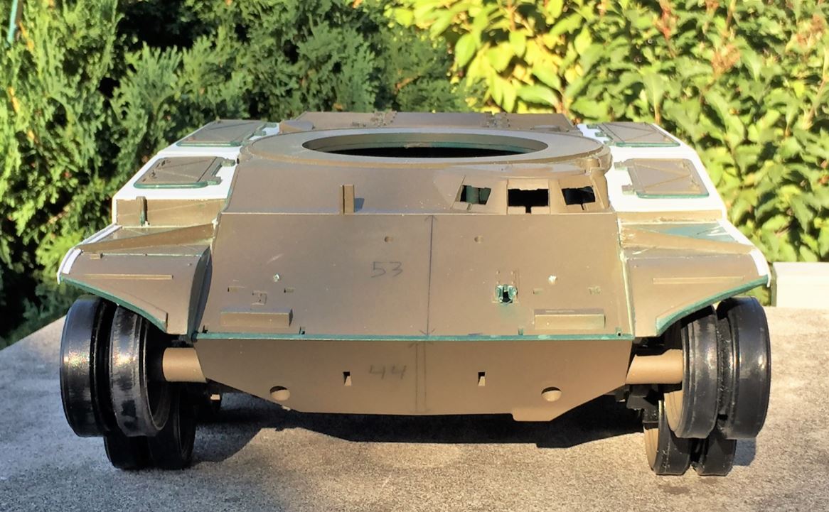

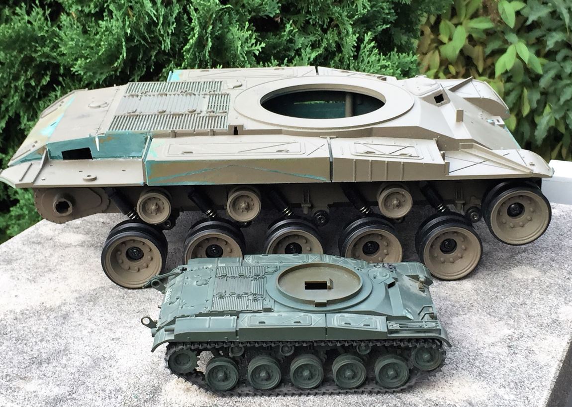

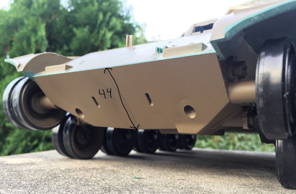

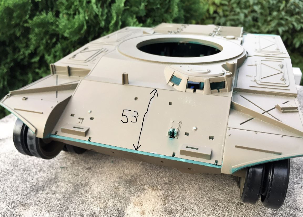

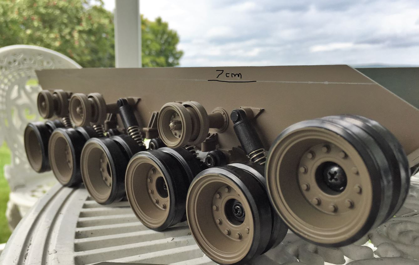

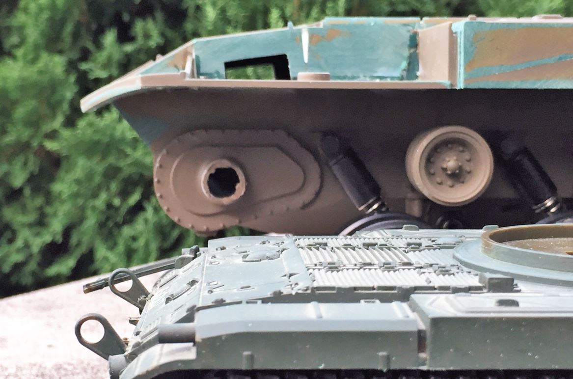

This is the rebuilding of the main hull, my way. For sure, there are other ways and likely many guys did the same as me or maybe better. What I did is shown here.
I made a cut 7mm below the tip, allowing for some sanding that brought down the hull height by about 7.5mm. What is not obvious is what happens next to the rest of the hull at the front and back.
After thorough analysis and slow progress one mm at a time from all angles, I left 53mm to the front glacis with the extremity resting on the lower plate.
44mm at the front bottom
Lower rear has 52mm

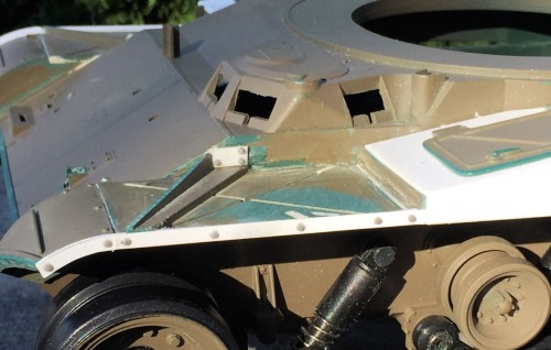

The rear top plates needed a lot of modification for size and angle. They were cut to 33 and 32mm respectively and glued back in place at the shown angle. The rear fender were cut as shown and to account for the hull reduction at the rear, the main storage box (which are too long) are reduced with 9mm left between the trap edge and the box edge.
Rear hull reinforced and rear fenders are glued in their new position. Lots of sanding and preparations is required.
Through all the hull cutting, the Heng Long screw holes at the front (2) and in the middle (4) were kept aligned. It is only at the back that the single screw hole is no longer aligned. This process of keeping the screw holes aligned really helps in the cutting process, stability and solidity of the model.
The new hull compares a lot better to the Tamiya kit. Getting there.

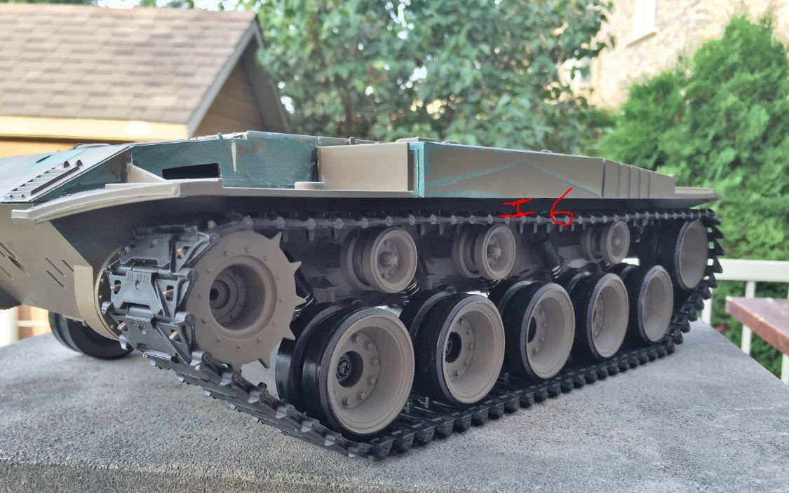

Testing of the track height is required at all time. There is about 6mm left between the tracks and fenders with the above process.
The next step is to take care of the fenders.
Regards, Louis
Lower rear has 52mm

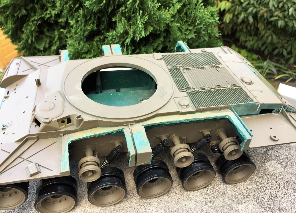

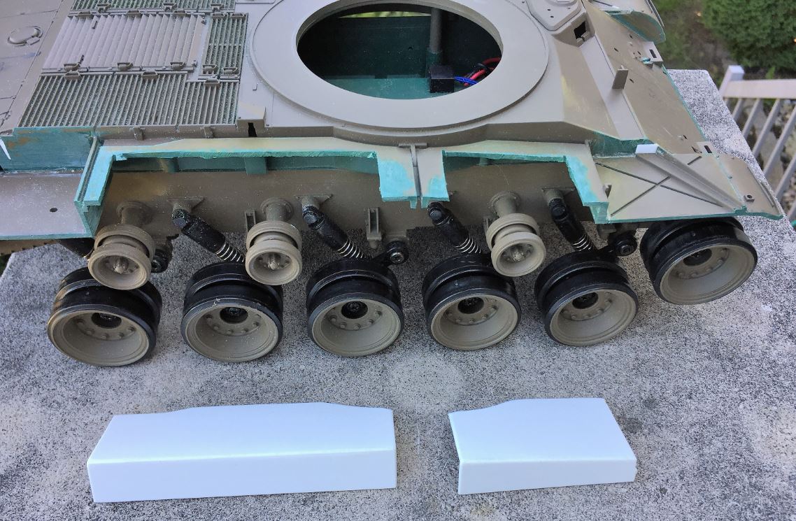

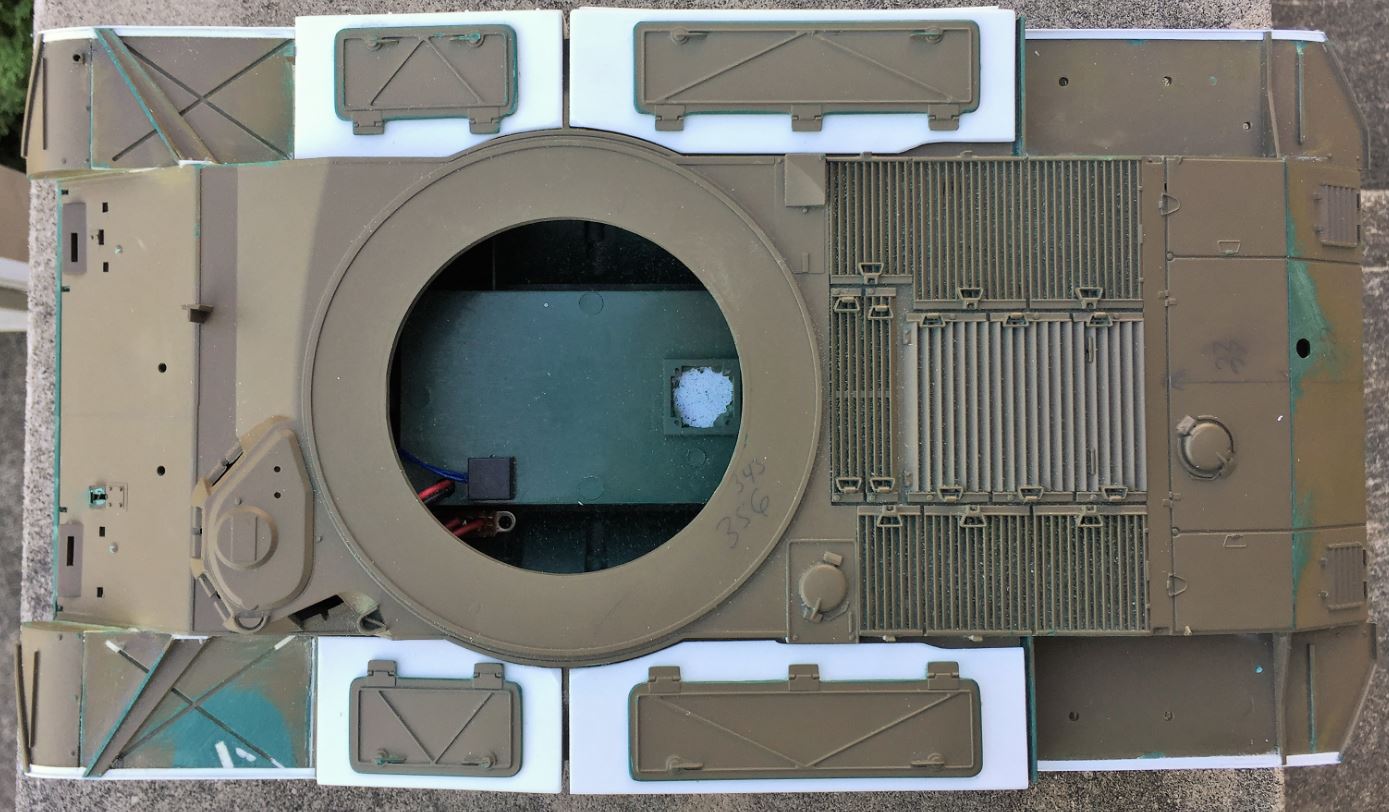

Re: M-41A3 Walker Bulldog - ARVN Vietnam 1970s - Build

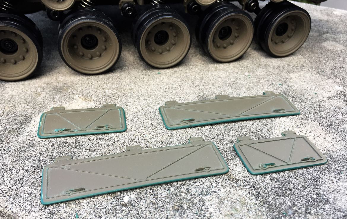

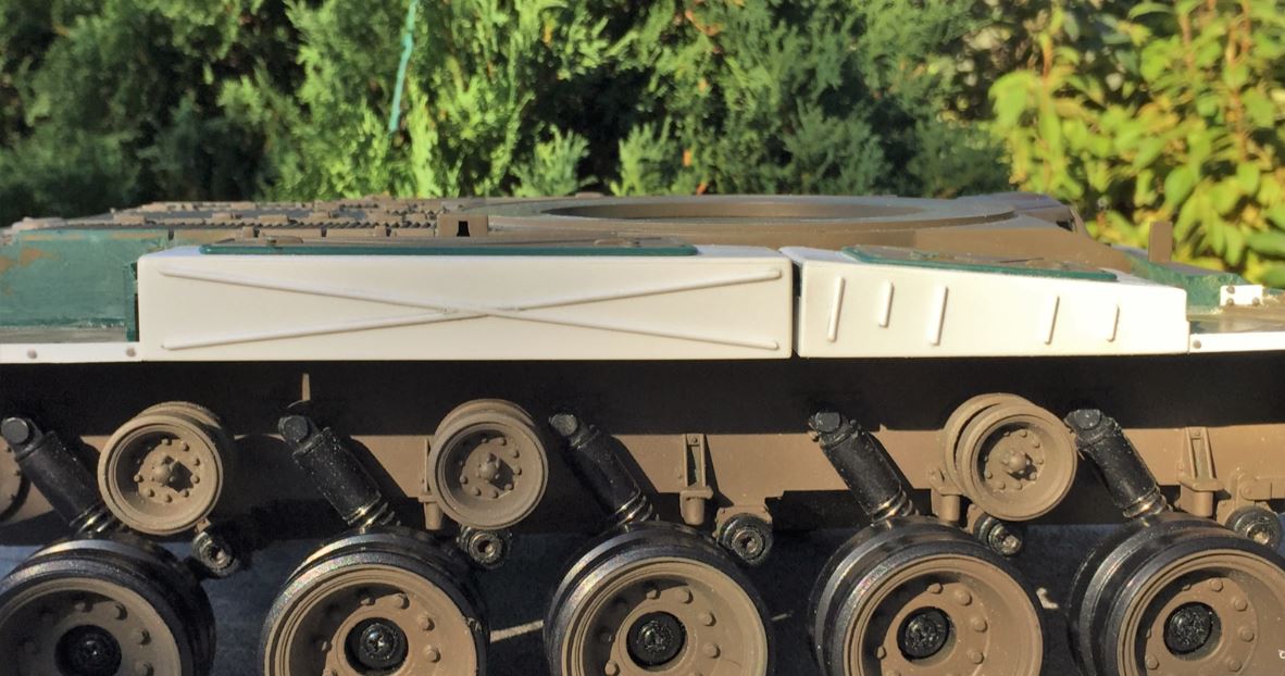

Hi, thank you everyone for your encouragements.

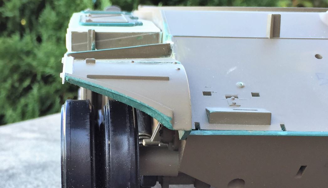

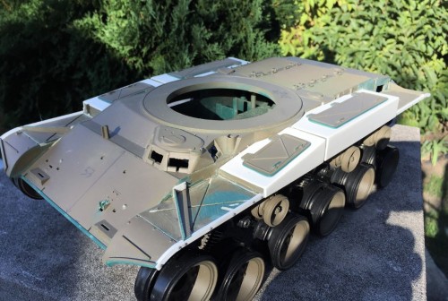

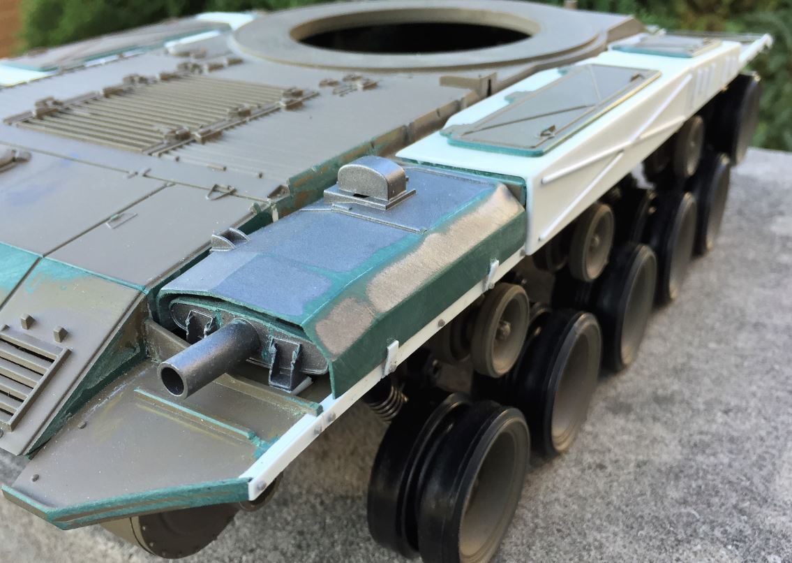

This post is for the new fenders, part 1.

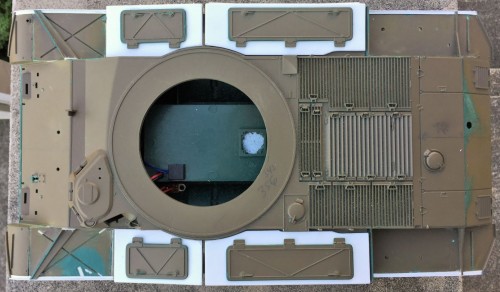

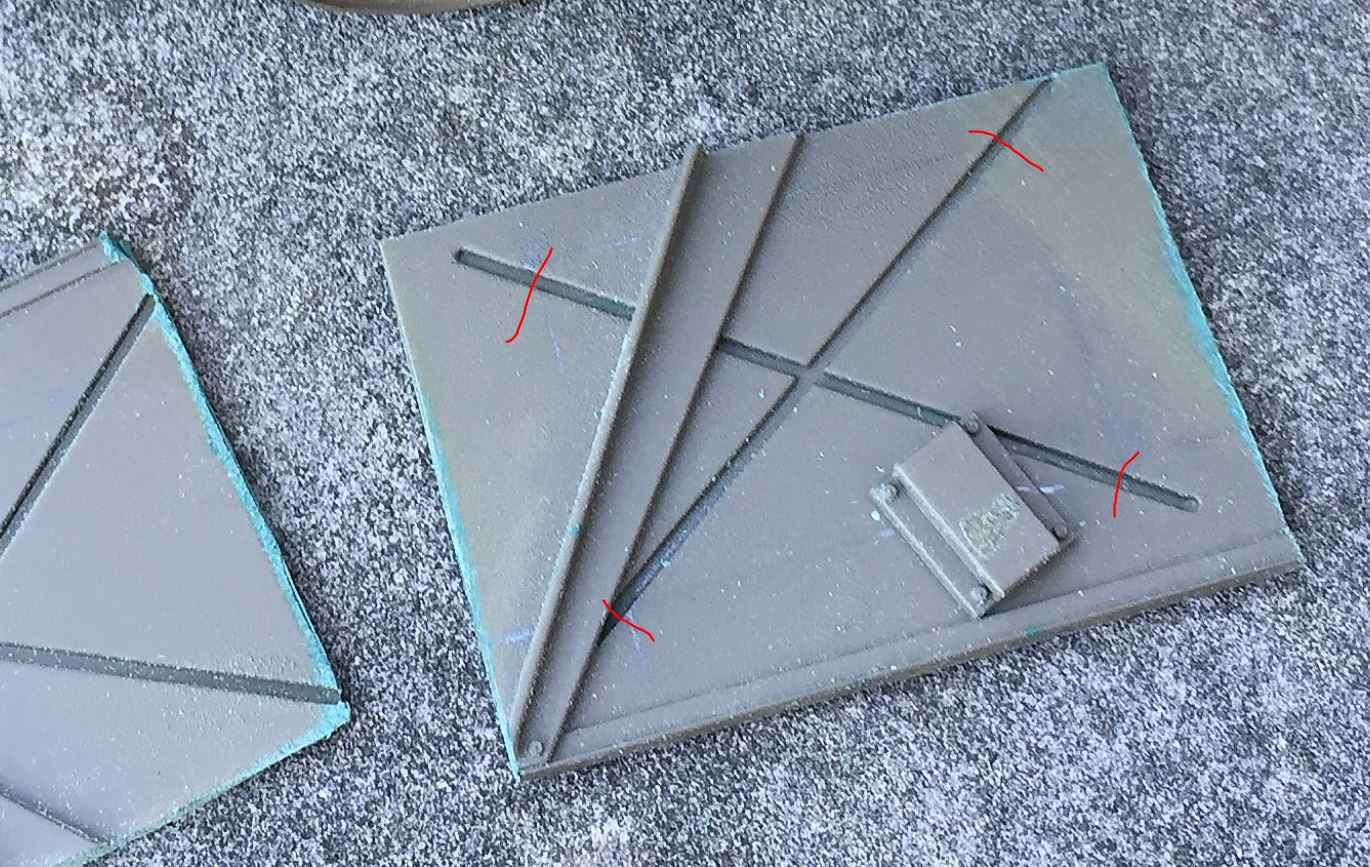

Here, the fender box lids have been cut from the main body for reuse. Each fenders will be reduced by 10mm from the outside.
After a lot of preparations, the new fender box lids are ready. They were made a bit ticker than before by keeping more material under.

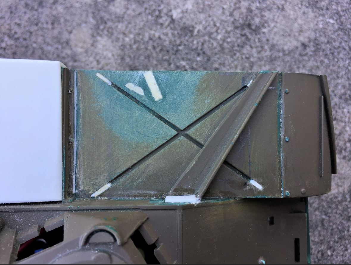

The front fender had to be cut from the main body so that the X that you see can be repositioned centrally by removing 5mm on both sides, otherwise, it will not look good.
The X on that side are too long compared to my reference and will be made shorter with filler.
New Plasticard overlay of the right size will be glued to the top of the remaining fender skeleton.
Front fenders are replaced with the X showing in a central position. It would have been difficult for me to re-scribe the X ino the plastic.
New fenders body and lids are installed.
The overall width of the tank was reduced by 20mm or so, a bit less because the overlay boxes add about 1mm each on that area.
Fender's fixing continuing on next post.
Louis

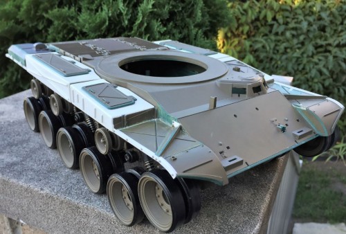

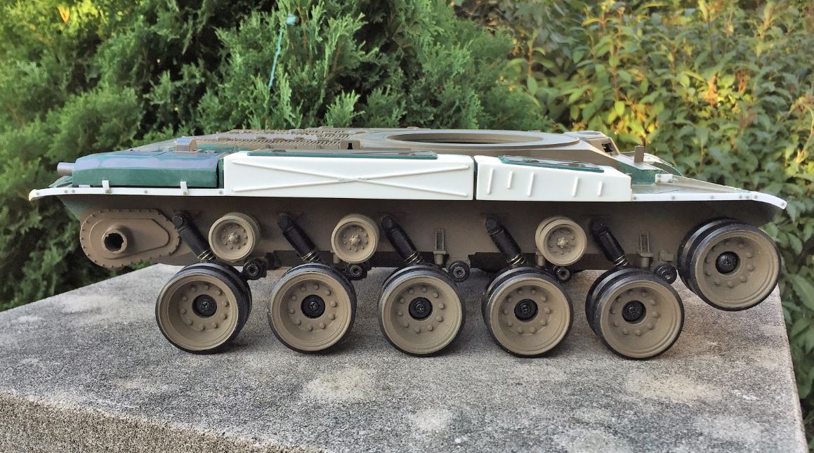

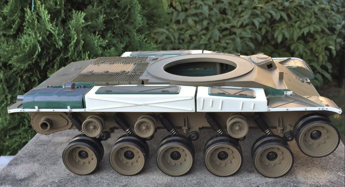

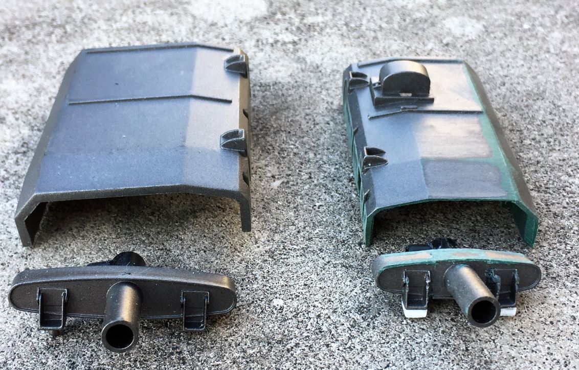

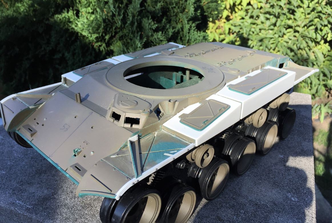

Hi, this is part 2 of the fenders
The embossed stiffeners on the fenders, and specially the large X on the side, are very important to reproduce, this is a trademark of the M41 Walker Bulldog. Sadly, I did not have enough 1mm half rods to complete all the stiffeners so more rods are on order and the rest will be completed later when the shipment arrives.
The mufflers and cover had to be reduced and modified, original on the left, resized one on the right. The extremities of the covers should be thinned because these are supposed to be light metal, not armored covers.
Mufflers and covers are installed as seen in references.
The next step once I finish the other muffler is to realign the road wheels centrally with the fenders by moving them about 4mm closer to the hull. It is planned that the new tracks will be between 32 and 33mm wide instead of the current 40mm.
Here is the overall look of the model as it stands today.
Regards, Louis
Regards, Louis
