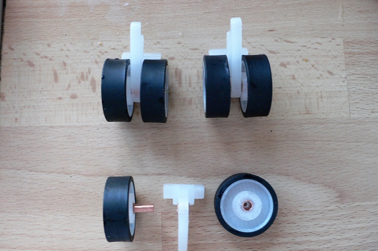

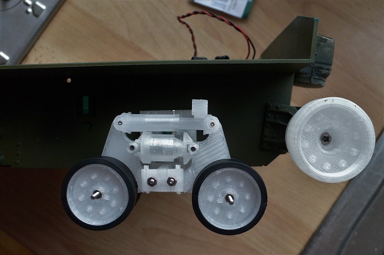

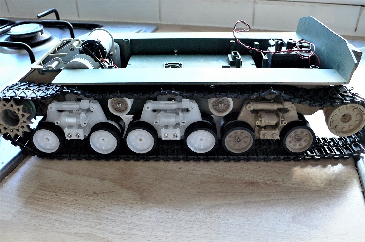

got this set up a bit since,just a heads up if any one is thinking of getting one its not for the faint hearted lots of work involved to get it something like...patience and skill a must ?

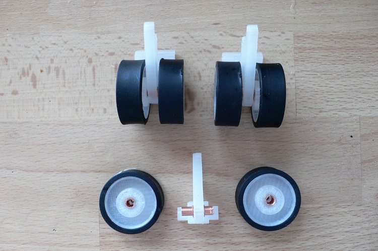

needs bearing ete that fit and do the job and no missing parts poor kit in long run

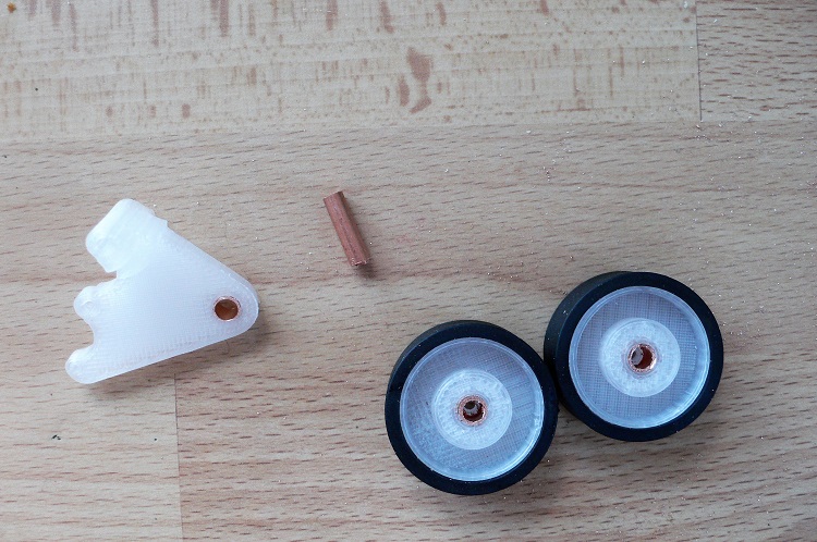

the bearings to axle if that's what you could call them did not match so I had to do modification and bushed the whole lot not worth the money

B_Man wrote:Is it as fragile as it looks? I'm not convinced about the longevity of plastic running gear.
some of it is pretty solid but think they are over engineered ? most of the printed parts are ok its just that the bits ,are to me after thought' s need bearing axles ete ete toss em in a bag away you go ? they just did not fit far to sloppy wheel /bearing set up ? a slim bolt as a axle ? bits missing so hence the mod took some doing but better for it ? IF hooben did a kit form with bearings of there take on the HVSS might be a winner ?
