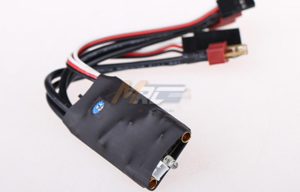

Hi Wayne, Thx! It does put out a lot of 'smoke.' Fan speed is semi proportional. It is a 5v fan which runs off the motor power wires off an ESC. These small fans require a certain amount of voltage before turning on, so a little off time before kicking on allows the coil to heat the fluid a bit. I tried a few of my own coils and they worked well. I used about a 1" length of hair drier heater wire. This was 'ok' but not great.
I then switched to Burn Effect V3 heater coil and coil driver unit which I ordered from China. They sell the coil and energizer circuit separately, or you can buy a whole unit for about 40$. I used an aluminum rc crawler radio box for the heater coil and fluid. Fluid is "fog Juice' for the big dance club foggers. works great. My fluid bottle is 15yrs old and still smokes fine! Site for parts is :
http://www.rcmart.com/burn-effect-21303-p-68732.html
Metal container for the heating element holds 10-15ml fluid . Added a diode to the neg side as the brushless 5v fan only likes to run one direction and will get hot w/reverse polarity. Designed a special plate inside the smoke box to hold the heating element and to keep fluid from sloshing around. I 3D printed this in abs .Just add fluid through brass angle when needed.

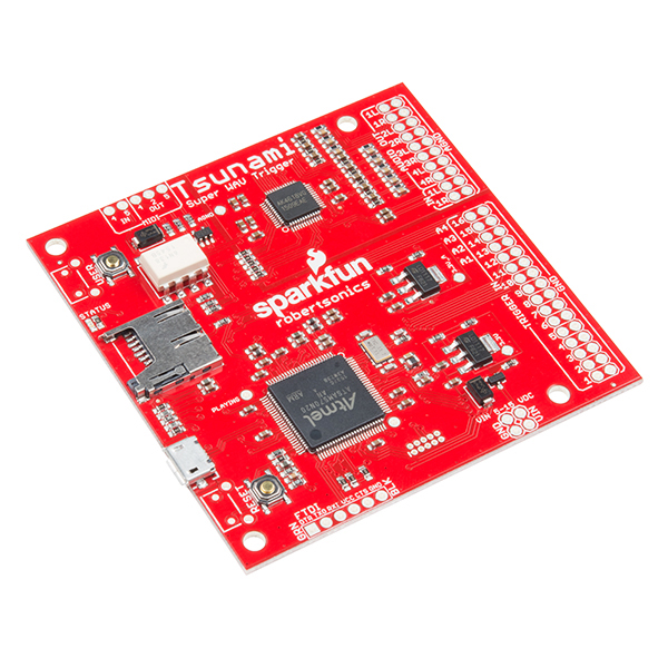

Decided to try TSUNAMI from Robertson electronics. Polyphonic sound board. 5-20msec sound track boot, 4000 tracks, looping, fading, multitrack playback at one time(!), multiple triggers including switch and serial, seamless loops at any track length, and all libraries provided. Much more than needed, BUT, everything is already built in the library code, so makes my life easier. Processor is the issue. Cheap and small footprint. Maybe a teensy 3.2 (w/3.3v logic).....might be able to get away with NANO 3.0 but less memory, slower processing, and will need 5v to 3.3 v ttl converter (which slows down data transfer) . Would be nice if I can run serial mode AND switch trigger at same time on the Tsunami. will have to find out.... That will save on code writing time.....

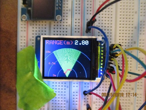

NEW DEVICE:
So with a bit of coding, I combined and Adafruit 1.8TFT with a teensy 3.2 and a TFMini 'lidar' device. Came out great, Just need to add sound and and some button actions to change range from 10m to 5m etc...
Right now, the TFMini is hot glued to a servo aimed into a corner. The distance is pretty accurate. It originally is decoded into cm's. I converted this to decimal meters. Also, some of the original code for the scan display was set to 40cm, so this had to be modified, as well as all the code to convert ping.h to TFMini.h. Some of the original code was designed for the sparkfun ultrasonic transducer, which of course has way too short a range for my needs. This TFMini transducer is pretty accurate (within 1cm) when I first tested it.
Honestly, the hardest part was just getting the teensy to display on the TFT. Had to update my libraries....

Thx! Rad. Basically, it's an IR range finder displaying as a radar scanner. Could put one on a modern type RC tank or boat and transmit data back to the Tx..... possibilities......
