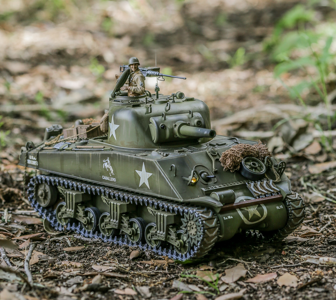

I have my first RC tank, an Heng Long Sherman M4
I have an issue with it since yesterday, it doesn't go straight forward, the right track is not moving as fast as the left one
I checked if something was wrong with the tracks or gear box but nothing.
I inverted the wires from the motors to the transmitter and the problem switch to the left.
What can I suspect now ? A transmitter or crystal problem ?
Thank you
