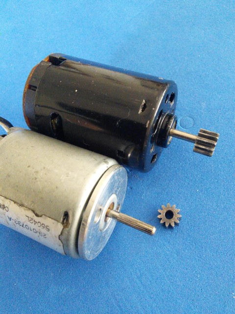

This is the original motor.As can be seen the shaft is knurled.Also the new motor with a new pinion.

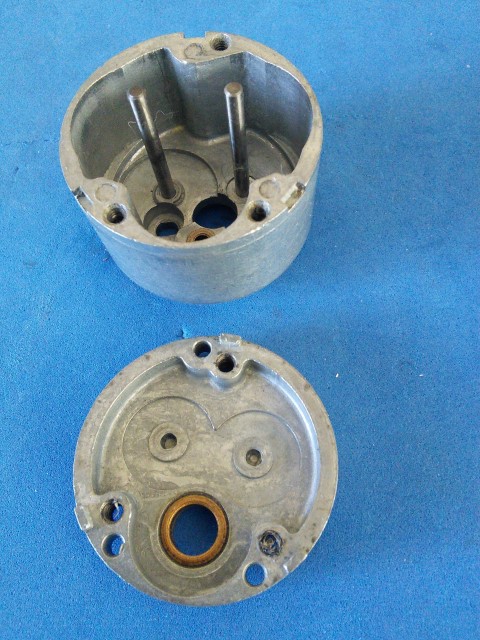

Gear housing and cover.

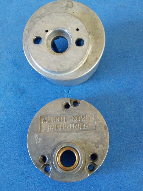

All gears removed.

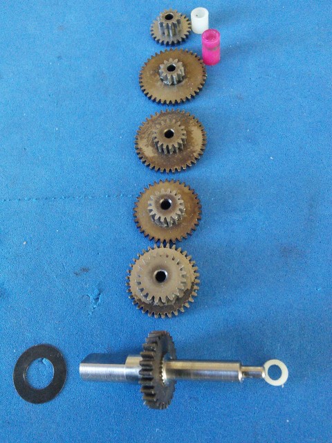

All the gears.

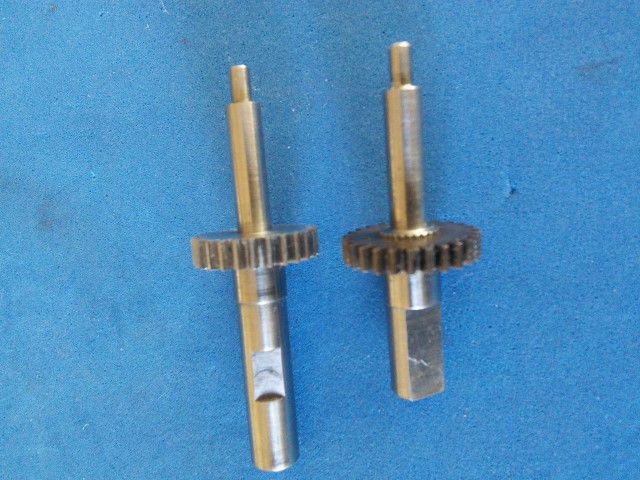

Old and new main gear shaft. New shaft is 10mm longer.

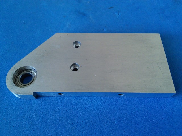

Side plate. It also will be used to fix the gear box to the side wall of the tank.
IMG_20180604_111642 (Small).jpg (79.18 KiB) Viewed 6589 times
