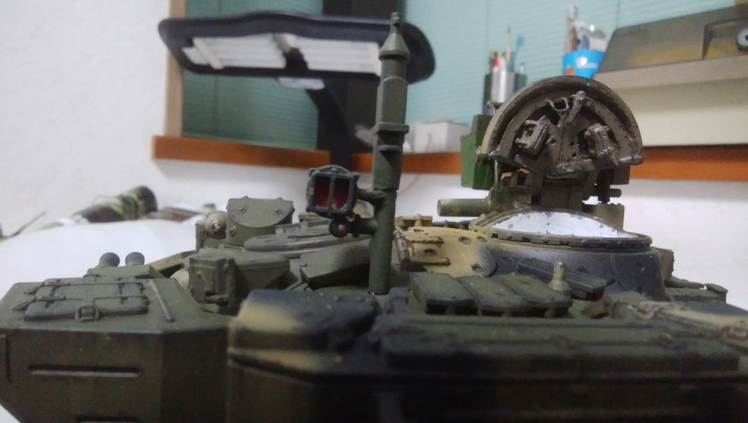

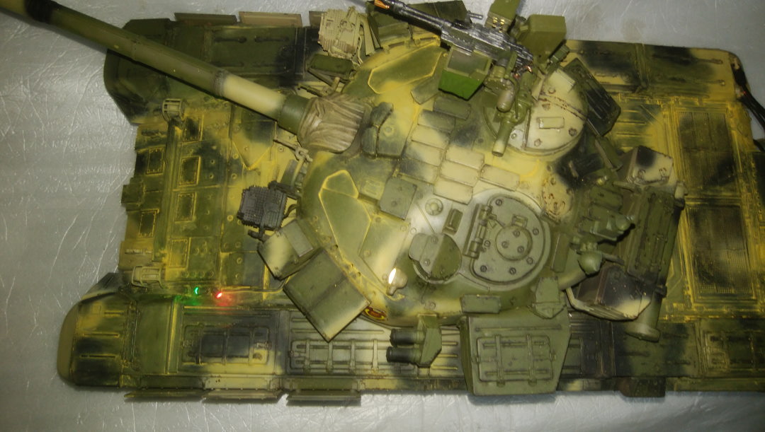

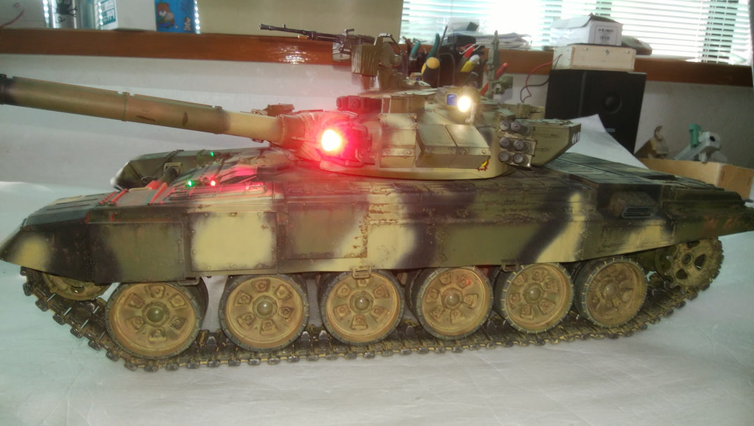

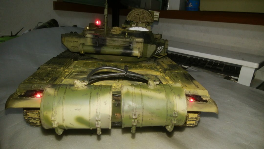

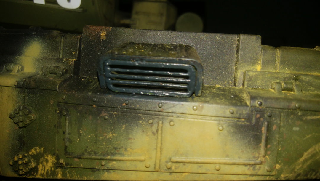

Hello everyone.
I detailed up my HengLong T-90 tank.
I installed BEIER-Electronic 's sound board USM - HL 2, downloaded the actual T 90 tank sound from YouTube, and edited it using Audacity. The remodeling is as follows.
• Convert BB spec to barrel recoil and gun flash specification
• Gun flash of anti-aircraft machine gun on cupola using chip LED.
• 360 ° turret rotation using slip ring
• Added periscope
• IR Shtora, marker light, side marker light, added rear headlight on wind sensor pole, searchlight on turret, and brake light were remodelded to light up.
• Added rectifying fin board to engine exaust port
• Change the stock headlight guard to brass wire
• Detail up the back of commander cupora hatch
• Speaker exchange
•Removal of molded front fender fixing rod and making it by brass wire •Since the vertical space inside the tank is narrow, remove the battery box.
•Change upper and lower hulls to removable magnet type

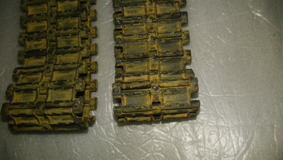

I sprayed the surface primer of oxide red on a metal track, and sprayed AFV TRACK COLOR (No. 06) of MODEL KASTEN COLOR with an air brush. For expressing dust, I painted conte pastel shaving powder dissolved in PETROLE.
After attaching this track to the tank and running it several times, the painting of the contact surface of the track with the ground and wheels will peel off and become more realistic.

- Rear headlight & commander hatch
- DSC_HL0523_01.JPG (98 KiB) Viewed 11778 times

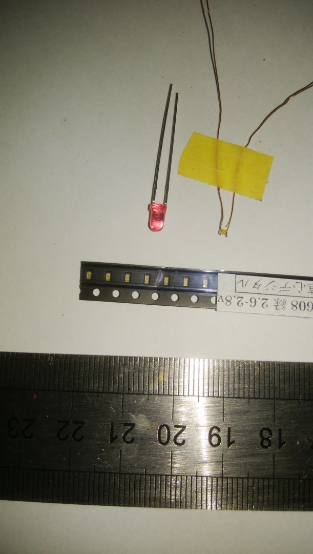

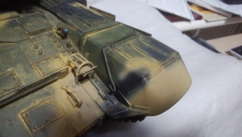

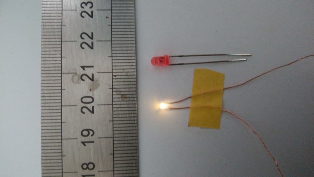

What I used for Cupora gun and brake light is 1608 LED Chip of 1.6 mm × 0.8 mm × 0.6 mmt, not 3 mm LED. I soldered 0.3 mm enamel wire to this. The following is a picture of the lit Chip LED, 3 mm LED and brake light.
I'm sorry. Tip LED is wrong with Chip LED.
- Brake light
- DSC_0234_01.JPG (62.95 KiB) Viewed 11663 times
- Chip LED & 3mmLED
- DSC_TipLED0541_01.JPG (84.46 KiB) Viewed 11663 times
- Chip LED & 3mmLED
- DSC_TipLED0536_01.JPG (66.96 KiB) Viewed 11663 times

Is that so. Since it seemed to be difficult for me to make lighting and external AA gun flash using glassfiber, I used this chip LED.
Indeed the Chip LED is very small and initially I thought that soldering would be difficult for me. However, since the Chip LED is very inexpensive (since it is about 2 dollars for 20 pieces, the shipping fee is higher), so even if you fail this work would be less damaging. I placed the Chip LED on a flat plate with a double-sided adhesive tape and also positioned the end of the enamel wire (plated with solder beforehand) with a double-sided adhesive tape, and soldered it carefully so as not to too heat much..
