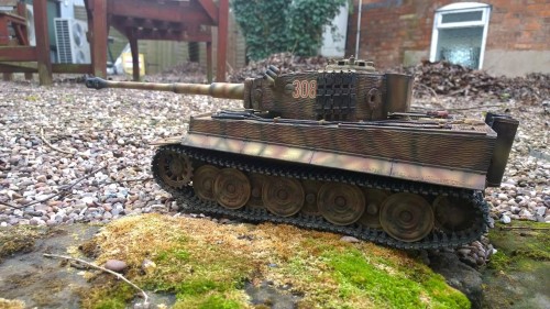

Well everyone is different but I have mine running from the front sprocket too just touching the top of the second road wheel
Hopefully you can see what I mean here, you may have to adjust abit one way or the other with abit of trial and error, hope this helps!

The accepted measure for a Tiger 1 is the tracks come off the front sprocket, miss the first wheel set just graze the second wheel set and touch down on the third wheel set. These being metal tracks.
Re: How tight should I have my rear idler/tracks?
Spongehoob has it right, you'll want some slack but not too much. Not so tight it puts tension on your wheel arms, but not to loose it runs off the roadwheels. You should be able to easily lift the return track from the roadwheels a few cm with your pinky.
