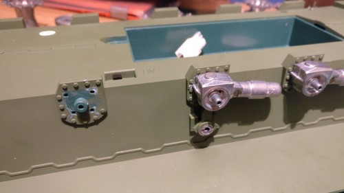

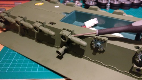

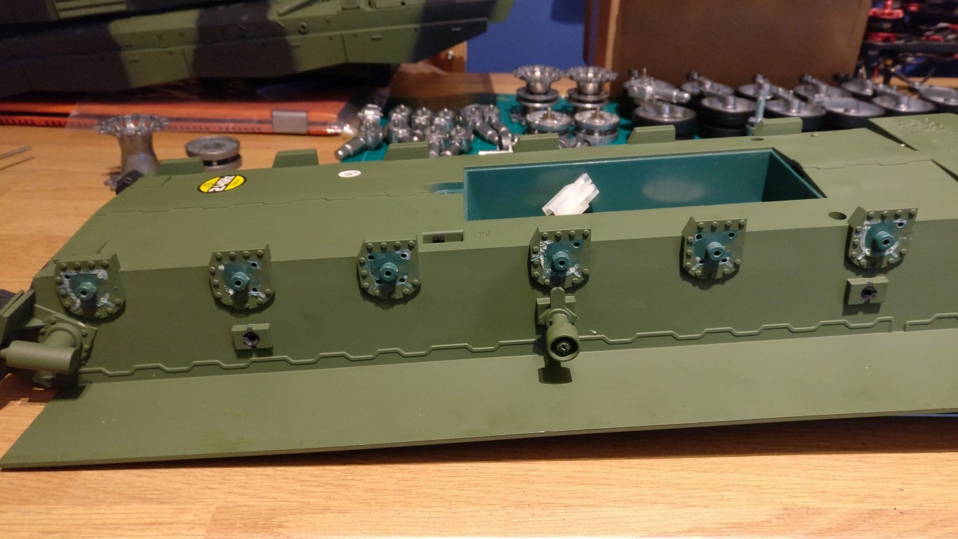

1st job, strip everything down ! Once disassembled you have to remove the existing pneumatic suspension arms, again thre are no guide lines so here's a pic to help:-
There's a small hole in the rear face, slot a small screwdriver in behind it and use the old part lever it off the hull

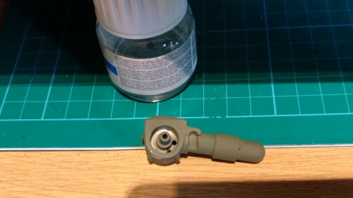

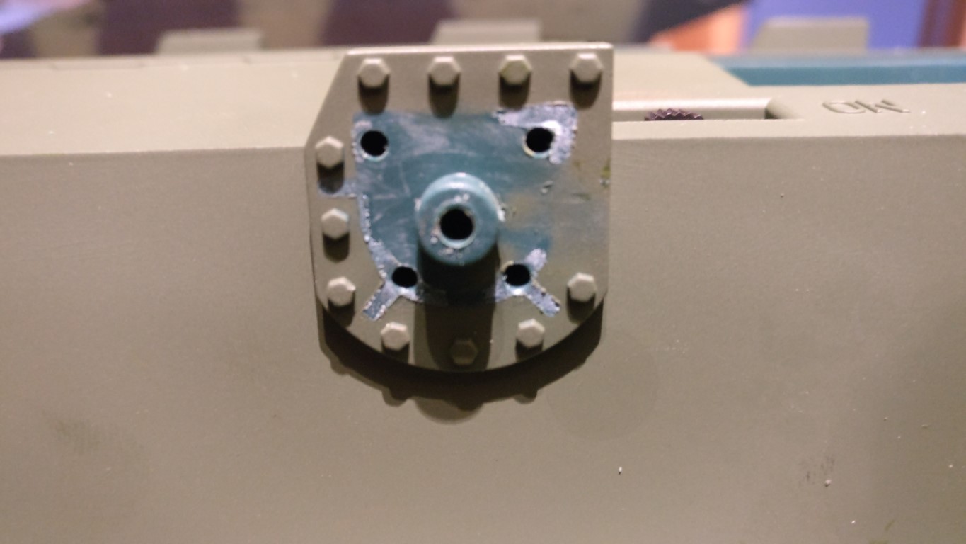

Once removed, you are left with the stub axles, cut these off and clean up the mounting holes

Once you have cleaned up all the surfaces and re-drilled the holes, you'll need to drill out the support holes for the track support rollers with a 6mm drill. Do this by hand as the plastic is very soft and excessive heat will just melt the surrounding area.

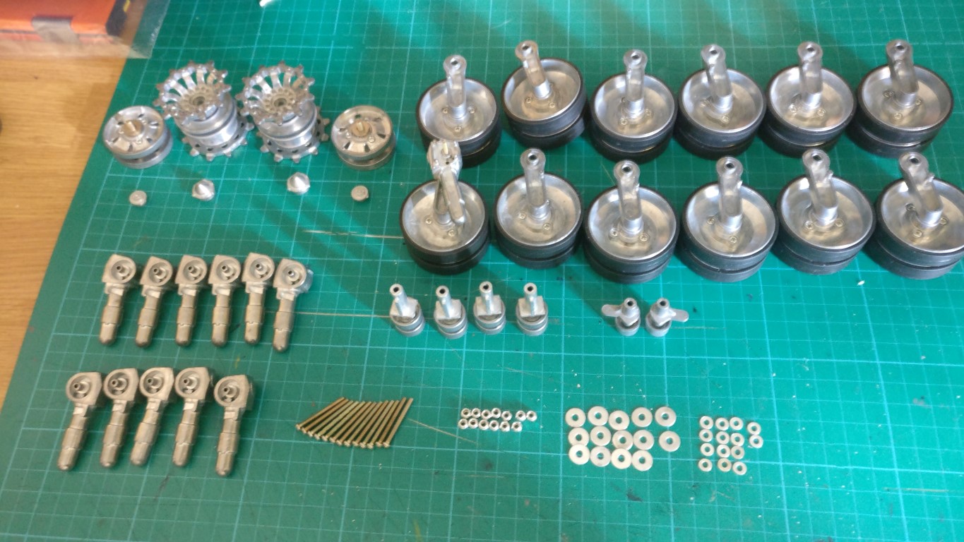

Test fit the new metal suspension arms and drill through so that the attachment bolts come through into the inside of the hull.
Make sure you have 12 x 2.5x50 Bolts and the same of nyloc nuts (mine had 14 so expect extras)

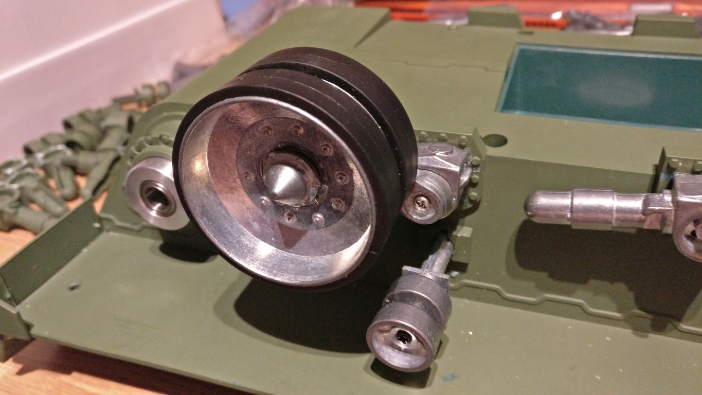

I test fitted one complete wheel and suspension assembly..
Here you can also see another addition, its the axle support assembly from Legion (via ForgeBear) it looks like you could fit this to the inside of the hull, but it makes refitting the gearboxes really difficult.

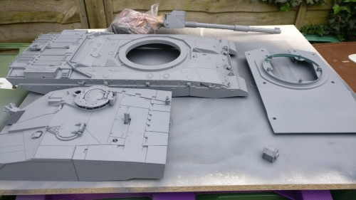

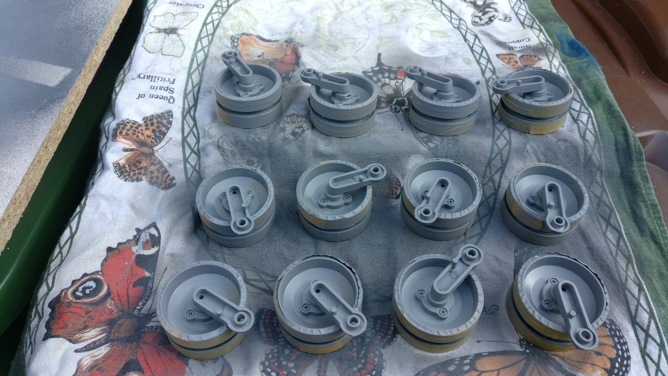

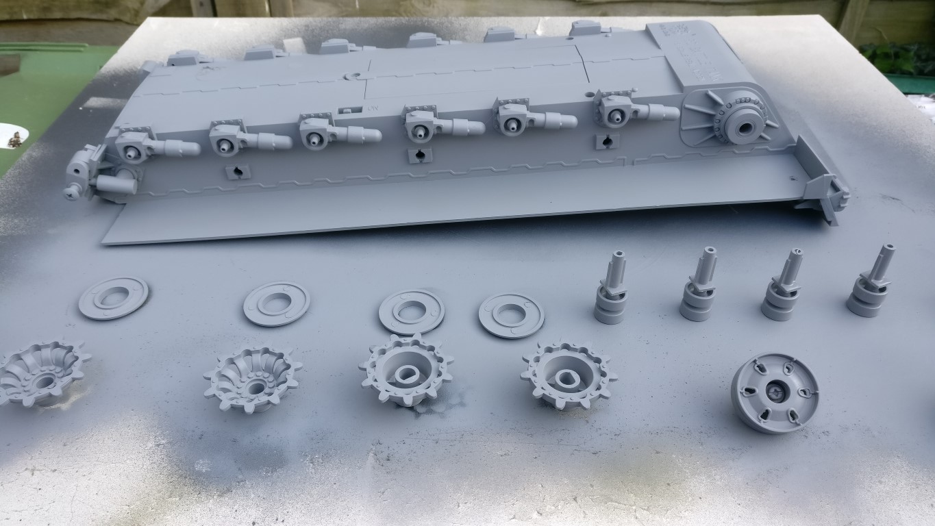

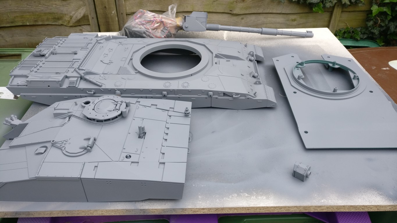

Next mask all the tires and everything gets an undercoat of Halfords grey primer
Excellent spraying weather for once!
And all the hull and other bits

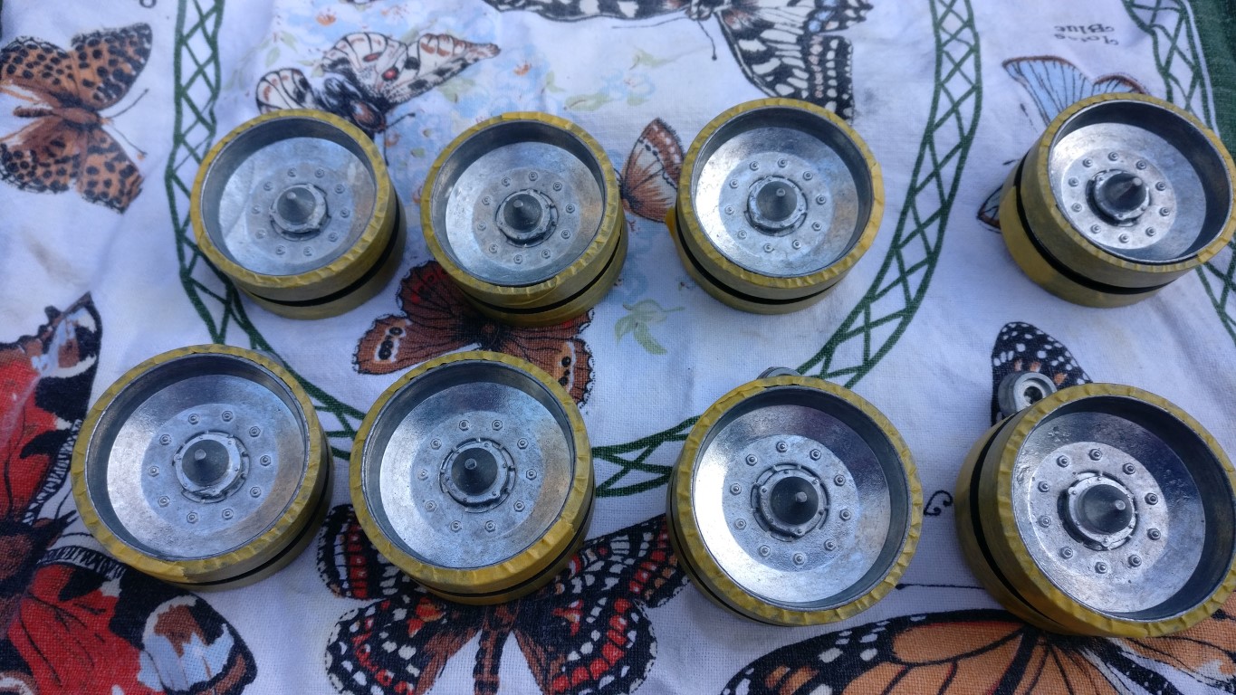

Its interesting to see the suspension units being put on and the whole thing coming together. Can I ask, whether the metal wheels have much wobble to them (runout) when spun or do they spin quite true? I only ask as I bought some early wheels for my KV-1 but sent them back and stuck with the plastic ones I had as they wobbled so much.
Thanks
Guy
IV(AC)
Posts: 35
Joined: Sun Apr 08, 2018 10:08 pm
Re: My Challenger 2 Build thread
Post by IV(AC) »
wyvern wrote:Its interesting to see the suspension units being put on and the whole thing coming together. Can I ask, whether the metal wheels have much wobble to them (runout) when spun or do they spin quite true? I only ask as I bought some early wheels for my KV-1 but sent them back and stuck with the plastic ones I had as they wobbled so much.
Thanks
Guy
No they seem fine, each wheel has tow stainless steel bearings on the axle...some wobble but seem to spin freely and true...

Halfords Primer
Top coated

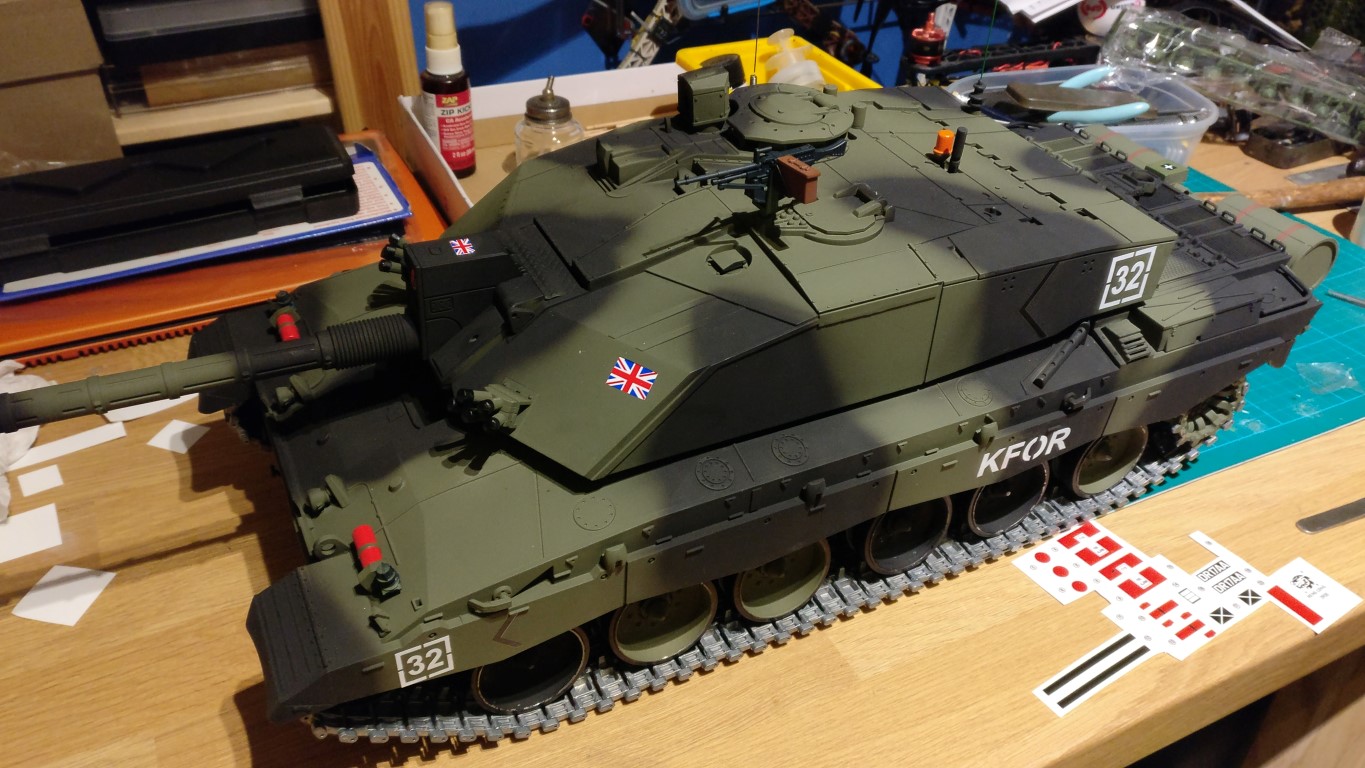

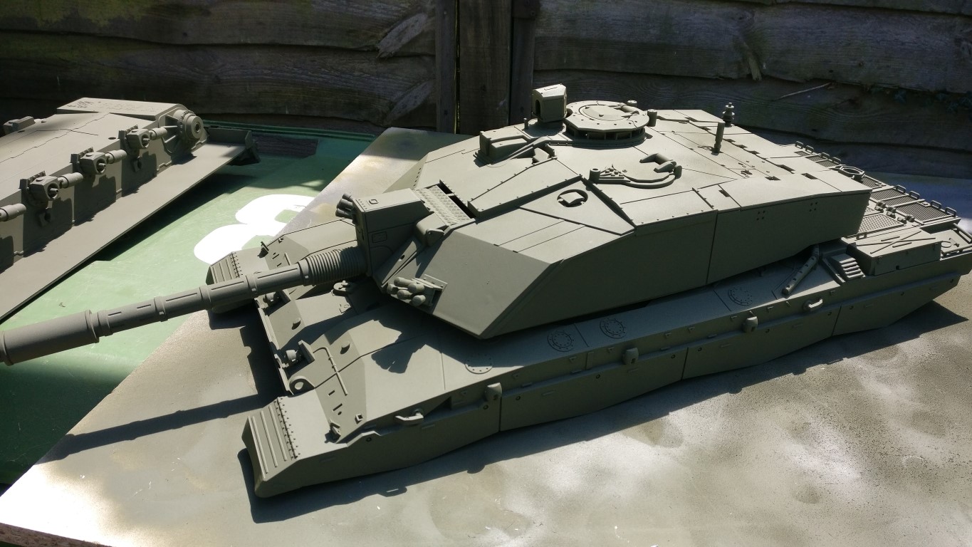

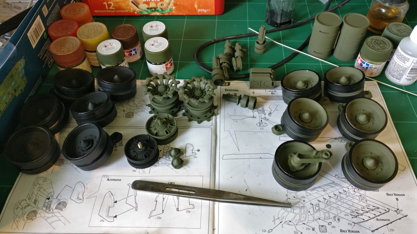

Turret with side ID panel removed

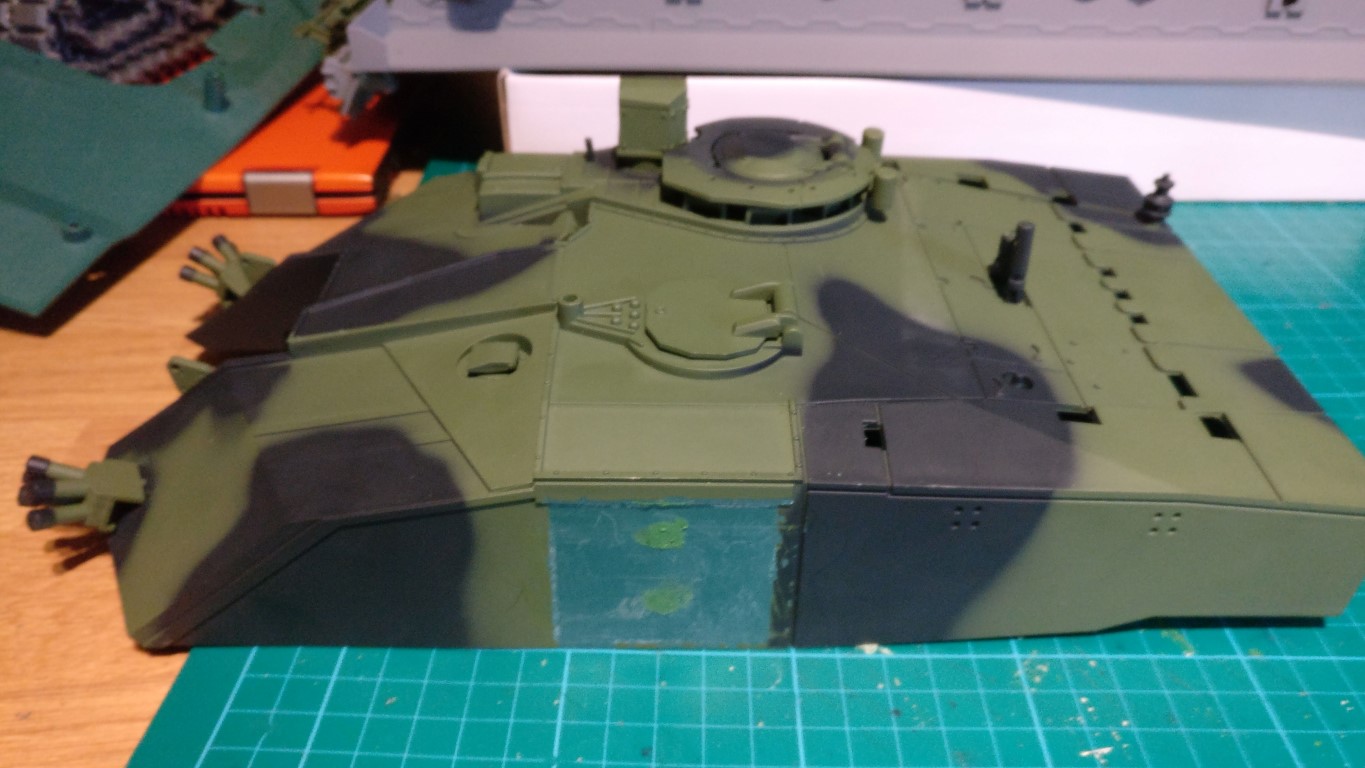

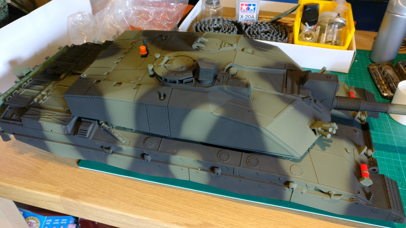

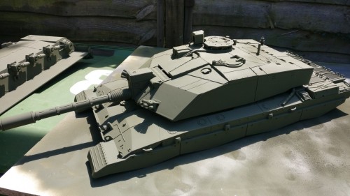

Upper Hull with Tamiya Acrylic black
Base colours done

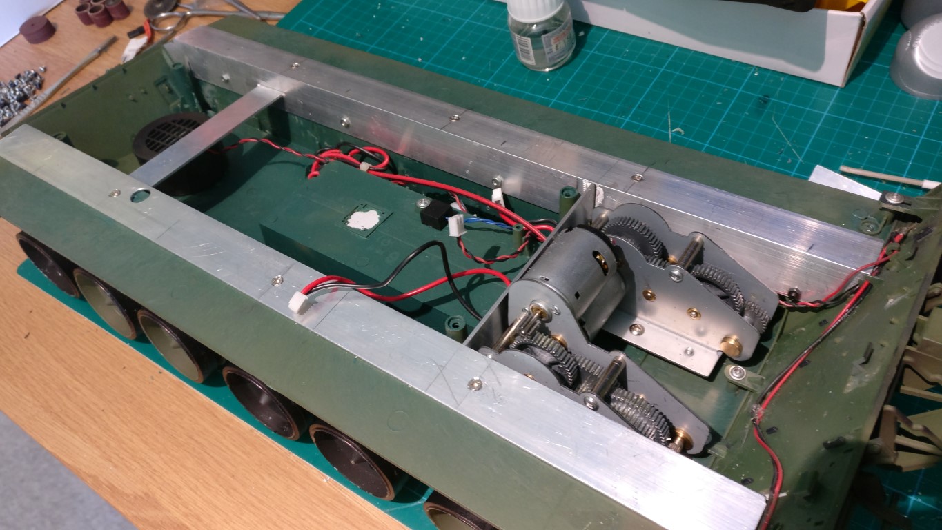

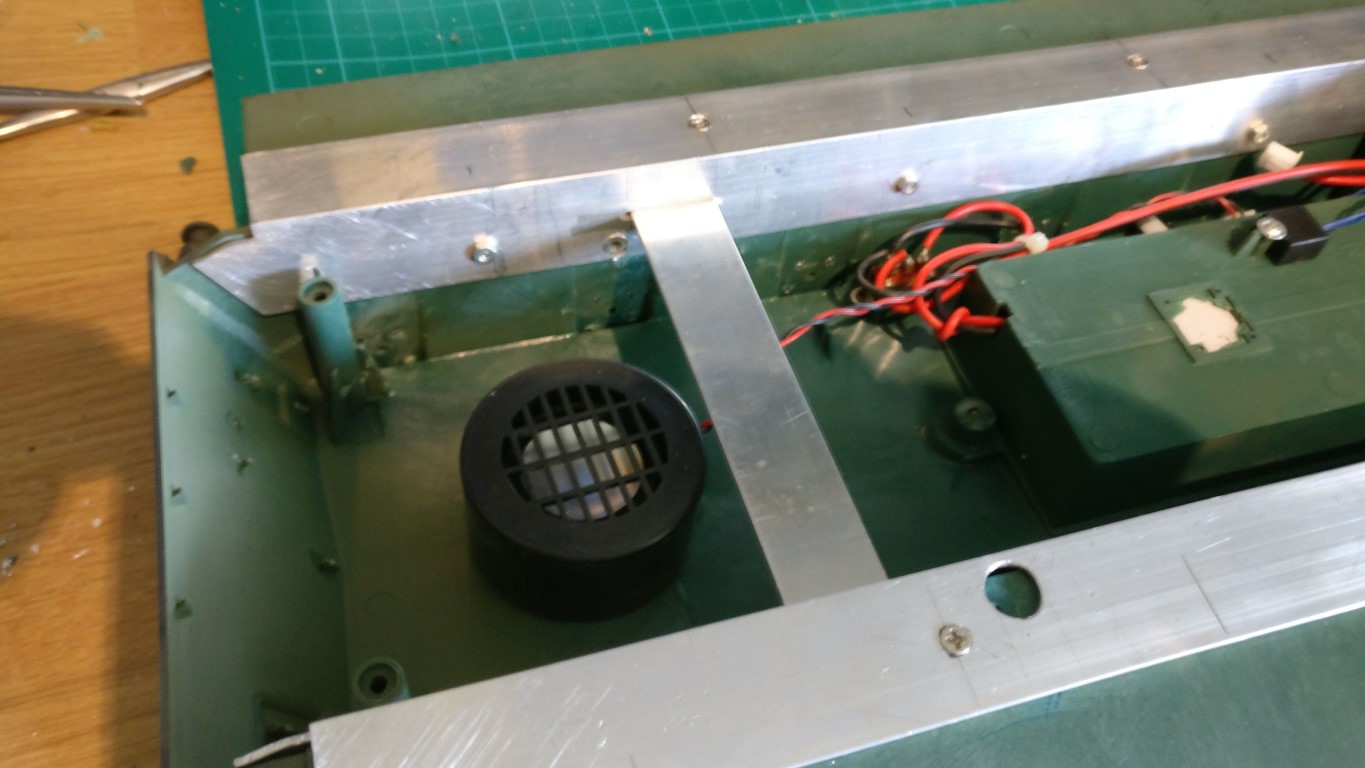

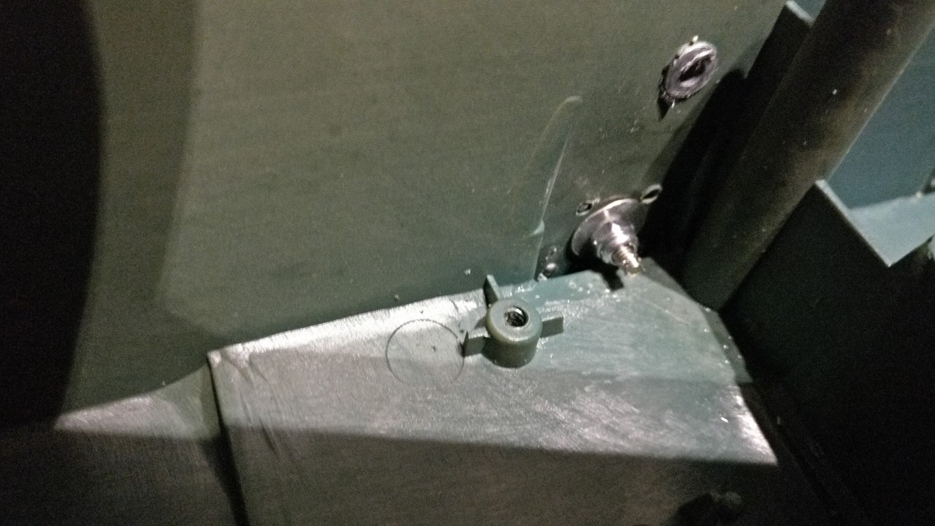

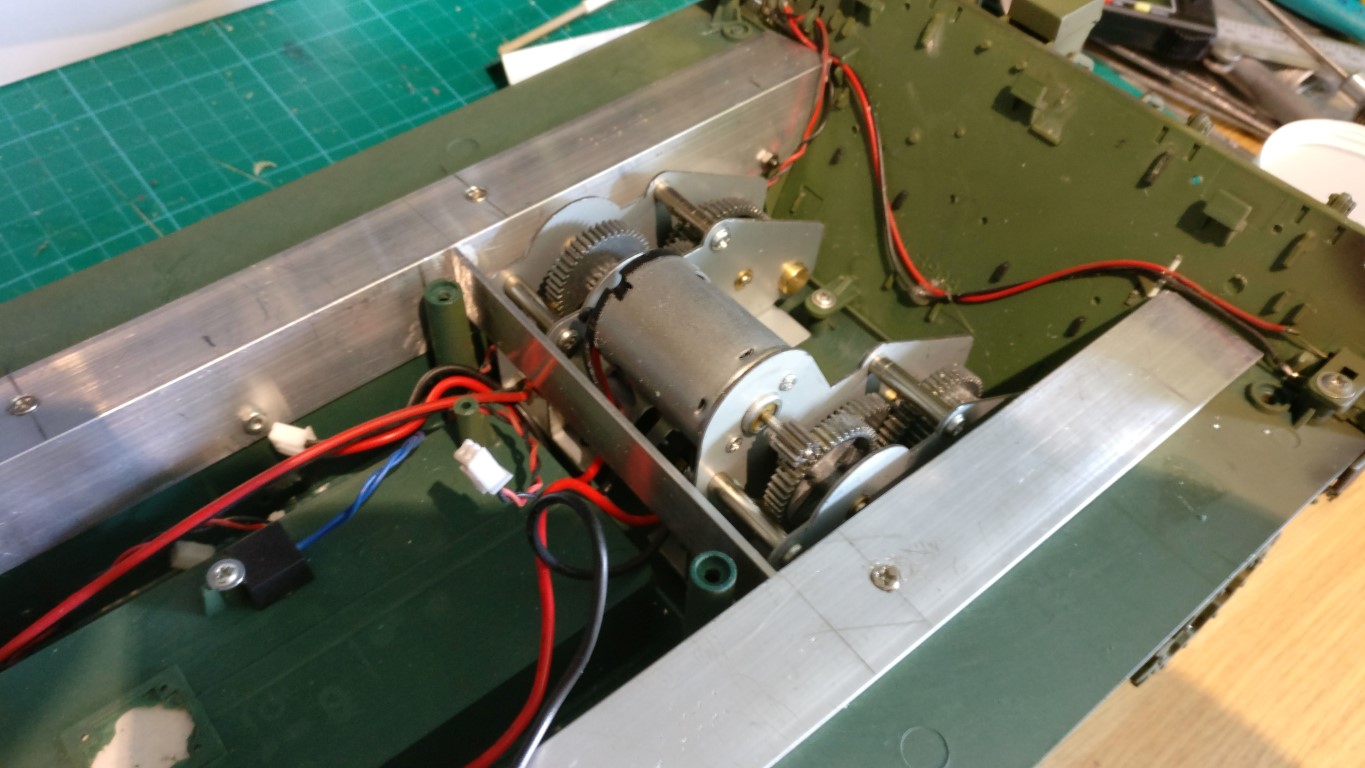

Decided that the main hull needed some reinforcement following the addition of all the metal extras
