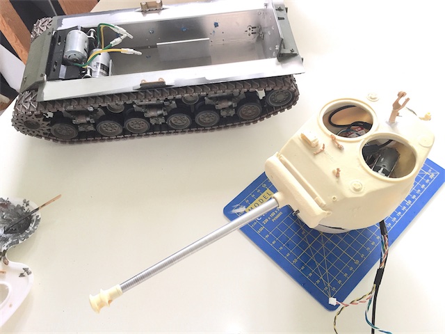

During my introduction to this site I informed you that I purchased an easy-eight conversion kit from Nick Agular and started to combine these kit parts together with the Tamiya IDF Super Sherman. Now I am so far to show you some pictures about my progress in building together the turret. As you can see I am using only the rotating ring from the turret and I made it fit into the turret which was provided by Nick. I already tried out the recoil mechanism, the gun flash, turret / coaxial MG (I am attending to have two guns: the coaxial and the bow machine gun) and the elevation of the gun. I am also thinking of smoke coming out of the gun after recoiling has taken place.....I am looking forward to have some ideas from you about this....
Hope this inspires......
- side view: Gun and tower.
- Sample_002.jpeg (8.21 KiB) Viewed 7772 times
- Turret from the top: You can see the Tamiya kit parts for recoiling and elevating the gun barrel. Turret hatches are work in progress
- Sample_001.jpeg (10.97 KiB) Viewed 7772 times
- Turret from below: I combined turret ring and Nick's tower and used a lot of glue and putty to do so
- Sample_003.jpeg (14.63 KiB) Viewed 7772 times

As Niels Jansen commented, there indeed is not much space to build in stuff in the tower. However, the bottom hole in the tower base is large enough to build in the gun recoil system (Tamiya), turret MG and the barrel motor (Tamiya) and the complete wiring: recoil cable, MG cable, barrel motor cable, gun flash cable and even a 3-5mm hose to enable smoke come out of the gun barrel after firing a shot.
Next to that I can reach these parts via the hatch openings on top of the turret. As long as the hatches are not build in, there is plenty of room (even with my thick fingers) to do adjustments. As I decided to use an IBU 3 board to control my tank I have to modify the tower somewhat. I will use a led flash instead of the high-voltage flash set from Tamiya. Other additions/changes to the tower are (and are work in progress):

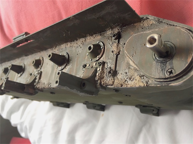

After spraying all the metal parts with a primer, I air-brushed the lower hull, the tracks, and all the metal parts of the idlers, sprockets wheels and suspension sets.

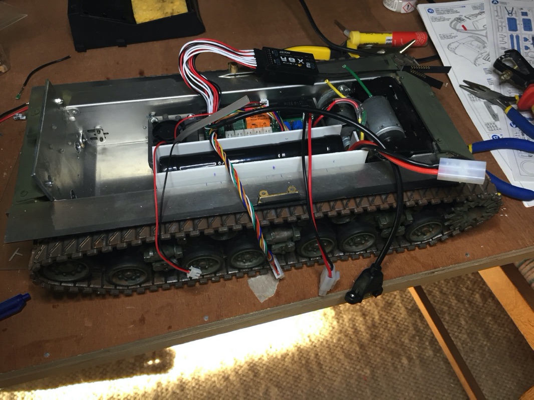

my project in the current state: lower hull and tracks ready.

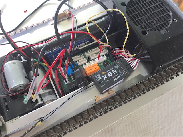

It was far too hot in the Netherlands (and elsewhere) to sit on the attic to continue with the build of my Sherman. So I introduced a summer break and do "intellectual' stuff like programming my transmitter and to set up the IBU3 module.
The picture below gives a good impression of the easy-eight project: tracks and lower hull are nearly finished. As all of you can see I am using an IBU3 module in combination with a Taranis X9D radio and X8R receiver(s)
The set up of the radio and the IBU module has been done and all is working perfect. If you guys are interested in a full description of my set up and programming (mixes, curves, outputs) I will post it here.....

Re: My first easy-eight----> IBU3 electronics
IBU3 Controller set up
Hardware connections for Tamiya Sherman M4A3E8 (super Sherman based).
I purchased an IBU3 board to control en steer my Sherman. During summer holiday I figured out how to get this board working in combination with my Taranis X9D transmitter. The whole set up is working now and I wanted to share the electrical part with you: how to connect the IBU board to the standard Tamiya mechanisms (turret motor, recoil unit, flash) etc. This is the electric wiring diagram how to connect the board.

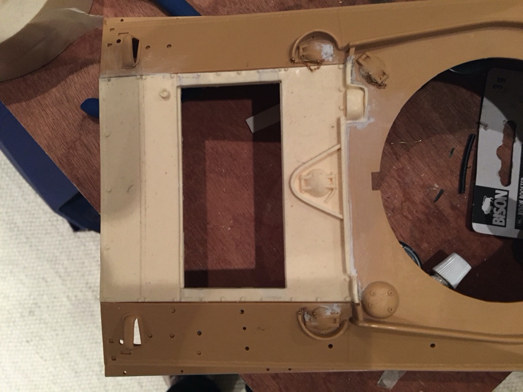

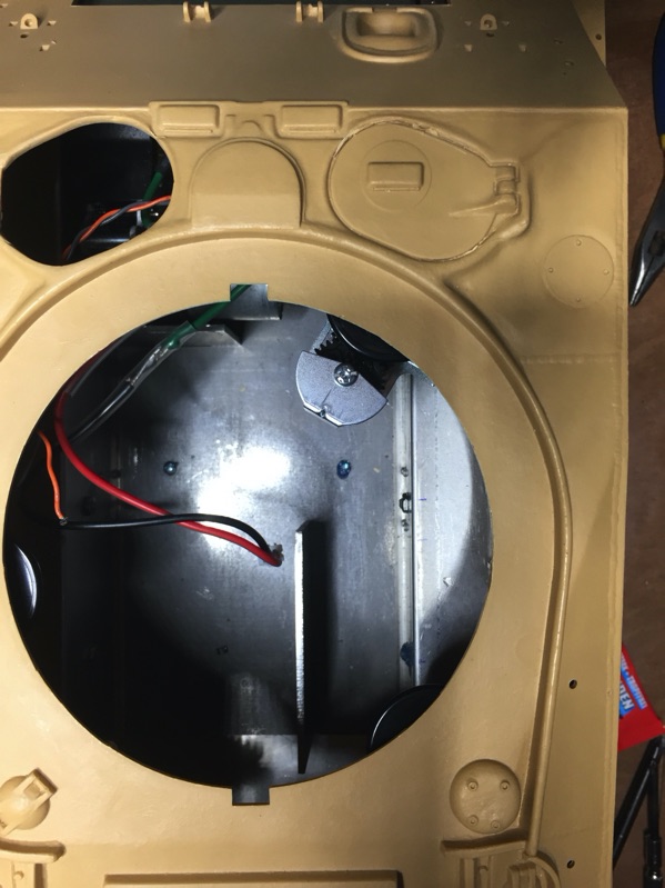

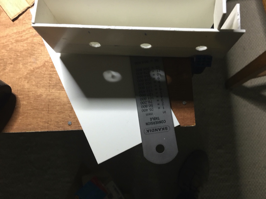

After some work with the tower I now share a few updates on the upper en lower hull.

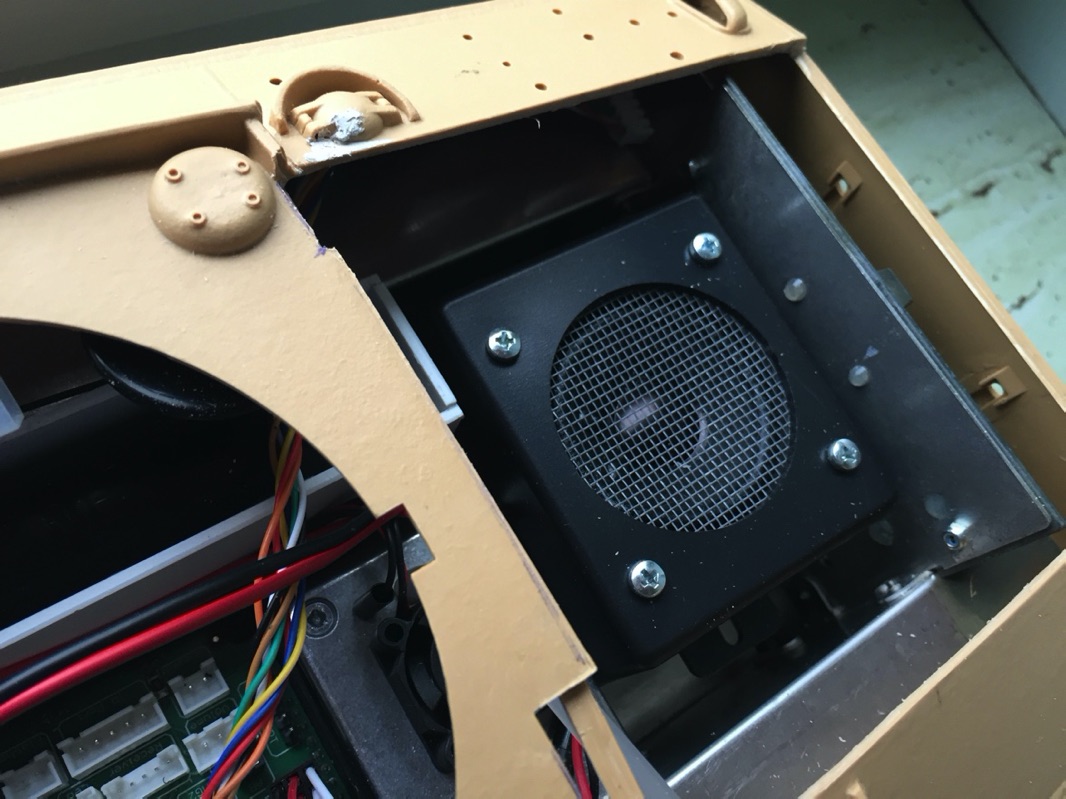

The Sherman has very limited space in its lower hull. It is quite a challenge to build in (next to the two engines) a speaker, a smoker unit, a tank controller - in this case IBU3 -, a battery and two receivers.
For protection I glued a few plastic sheets together to have a battery case and attached it into the hull with double sided tape. So it is a semi-permanent connection. If it is needed it can be removed. The picture below gives an overview of the position of most the items that are planned to be placed in the lower hull.
The open space, back in the tank will be used to contain the 10 Watt loudspeaker, the smoke-hoses leading to the exhaust pipes and some electronic components such as the relais for the tower light, connections for USB and battery loader and power on/off switch. The two FRSKY Taranis X8R receiver modules will be attached on the sides right above the tracks. As both receivers are bound to one and the same transmitter I have 16 channels on board.

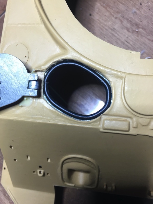

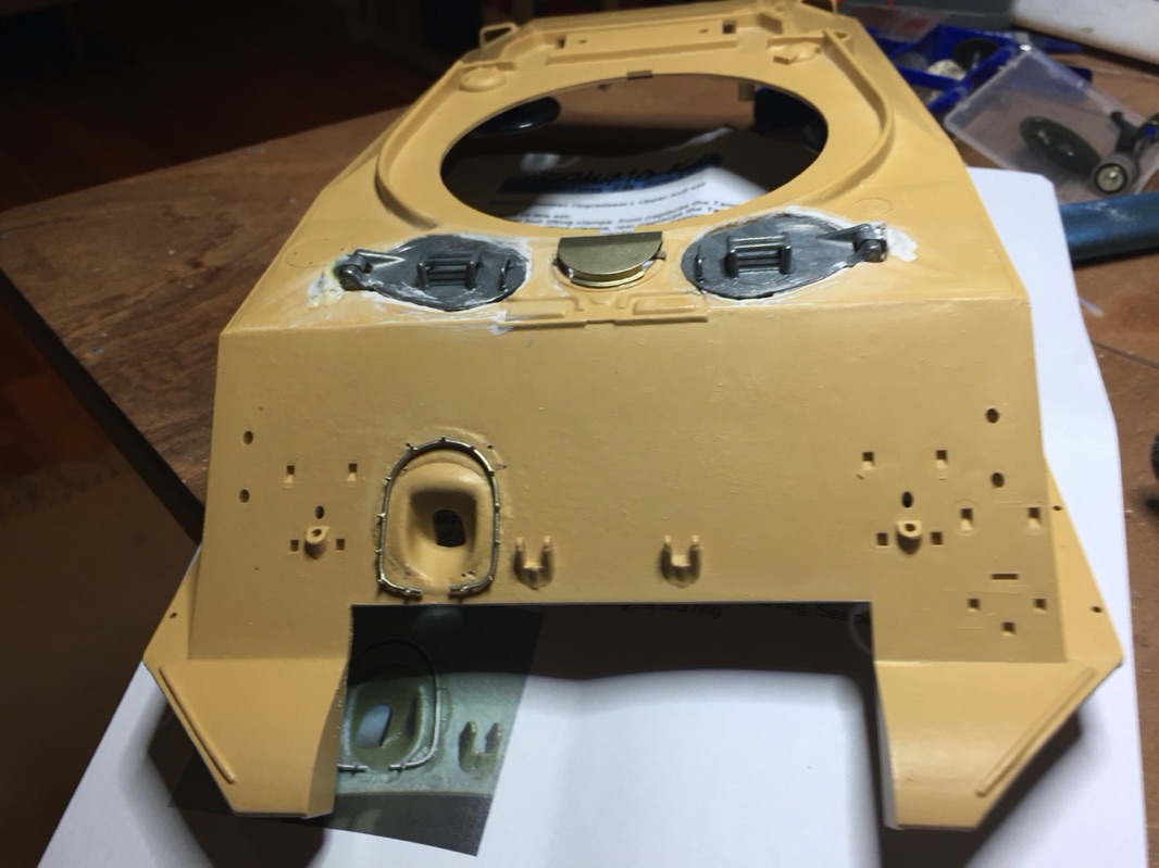

Standard Tamiya delivery is a welded upper hull. Basically the hull offers many details but I want to add several after market products, like hatches that can be opened or an infantry telephone box. So I started to cutting, filing, drilling and grinding.
To create more realistic hatches, that can be opened, for driver and gunner I had to cut out the plastic. The metal Mato hatches are complete with periscope and hinges.
To enable that hatches can be closed properly and that the opening has a nice rounded shape I bend some electrical wire (electrical wire that is use in normal electrical home installations) and glued it into the openings. I used a 2 component glue for that for fixing the wire and the hinges.

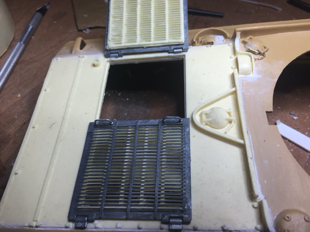

The second mayor upgrade is the replacement of the engine deck. As I wanted to build a M4A3E8 that deck must be replaced. Next to the tower, Nick Aguilar provided me such a deck with two large engine doors. But again you have to cut out all what is not needed.
