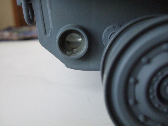

Re: Transmitter question
A view of the original arms. It clearly shows the angles of the road wheel axles.
- IMG_20170508_115905 (2) (Small).jpg (83.73 KiB) Viewed 1598 times
This shows the alteration to take the idler wheel.
- DSCF1329 (2) (Small).jpg (60.28 KiB) Viewed 1597 times

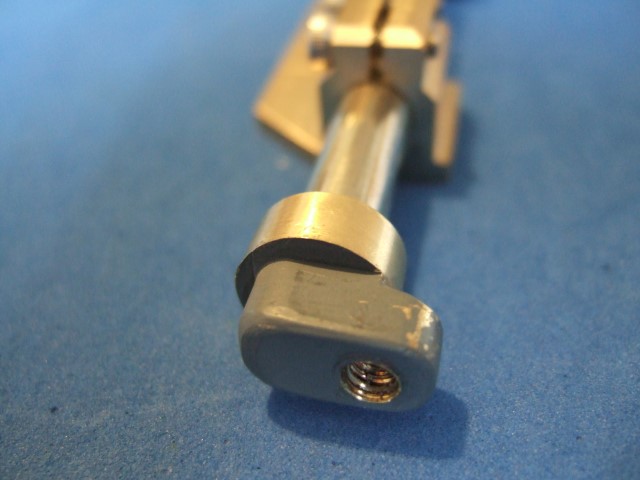

Another view.
- DSCF1358 (Small).JPG (45.93 KiB) Viewed 1596 times
The idler wheel arm.
- DSCF1371 (Small).JPG (55.44 KiB) Viewed 1613 times
