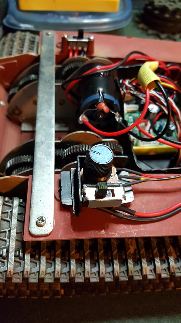

I have been building the Taigen Tiger 1 kit for the last few weeks. I am at the stage we’re the model is built and painted and I have the ibu2 electronics inside and all is working. My question is this. Is there a better way at changing or charging the battery?
I have installed a lipo battery but to charge it I have to take off the top of the tank and obviously this is quite tricky because of all of the wiring etc.
Another question I have is placement of volume and on/off switch. Both are connected but are floating around loose inside the tank at the moment. I would like to have it so that maybe they might be in hatches or hidden around the outside of the tank so was wondering if any one on here has done anything similar?

One thing that I have done is replace the volume control with a better pot and mount it under the drivers hatch with 3M clear doublestick tape ( servo tape ) or scratch built mounts out of rubber or plastic tubing. There should be a ready made mount for the On\Off switch under the radiomans hatch already.

that makes sense. I was thinking of attaching under the front hatches but thinking that I would need to attach to the underside of the upper hull thus making it even more difficult to take the top of the tank. your way is better because all of the wires are in the bottom of the hull.i will do it the same as you, it can be tonight's job
