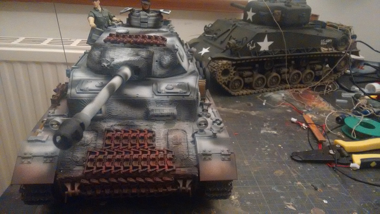

Yellow or white milliput and a plain screwdiver works like a charm for me. Absolutelly no need in zimmerit tools.

I dislike the wheel way a lot. It looks so symmetric and so perfect that is way way unrealistic. Also in some tanks you cannot use it propperly, just because some areas are unreacheable. Im my opinion to use the wheel is just for saving time... And about the resin Zim... I just wont never ever use them. Nothing can beat the look of a screwdiver. I just love how it looks in my tanks. This PIV is for sale just in case someone falls in love with it, lol.

I used milliput on my Panzer IV. Put a few drops of water onto a sheet of cling film, add a roughly flattened sheet of putty, then another sheet of damp clingfilm and roll it out with a rolling pin. Then it's really easy to cut to shape and stick onto the tank. I had a small plastic tool from a smartphone repair kit that I sanded down to a wedge shape and alternated the pattern on each column of zim. It took a while but wasn't difficult and I'm happy with the way it turned out. I would upload a photo but the forum is only accepting .png files under 350KB for some reason and all my pics are jpegs.
