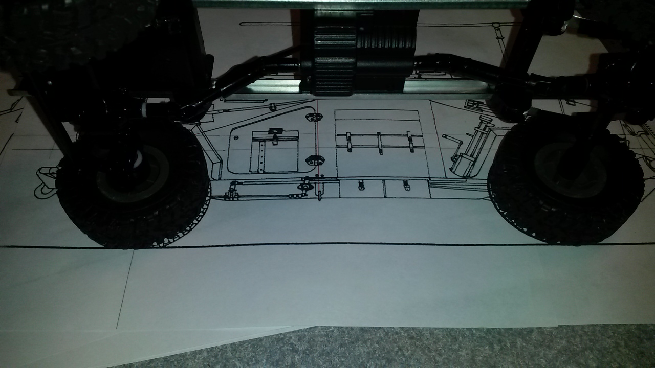

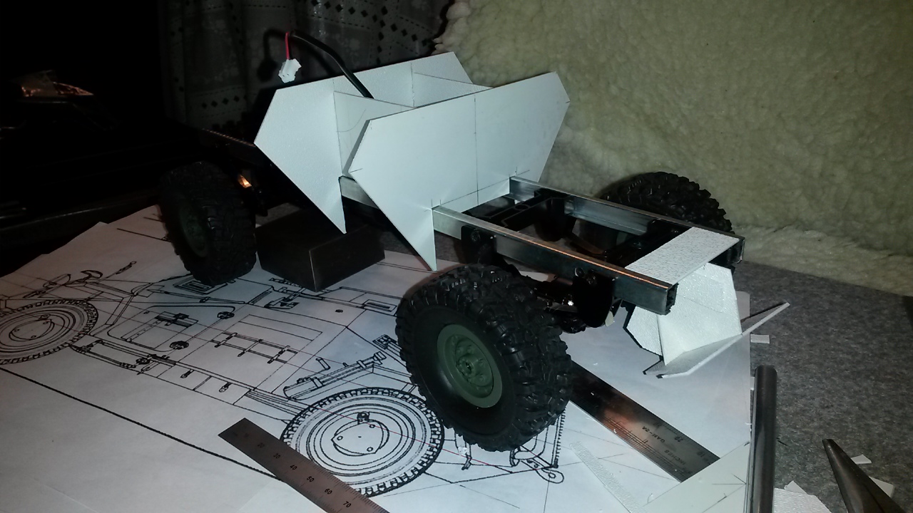

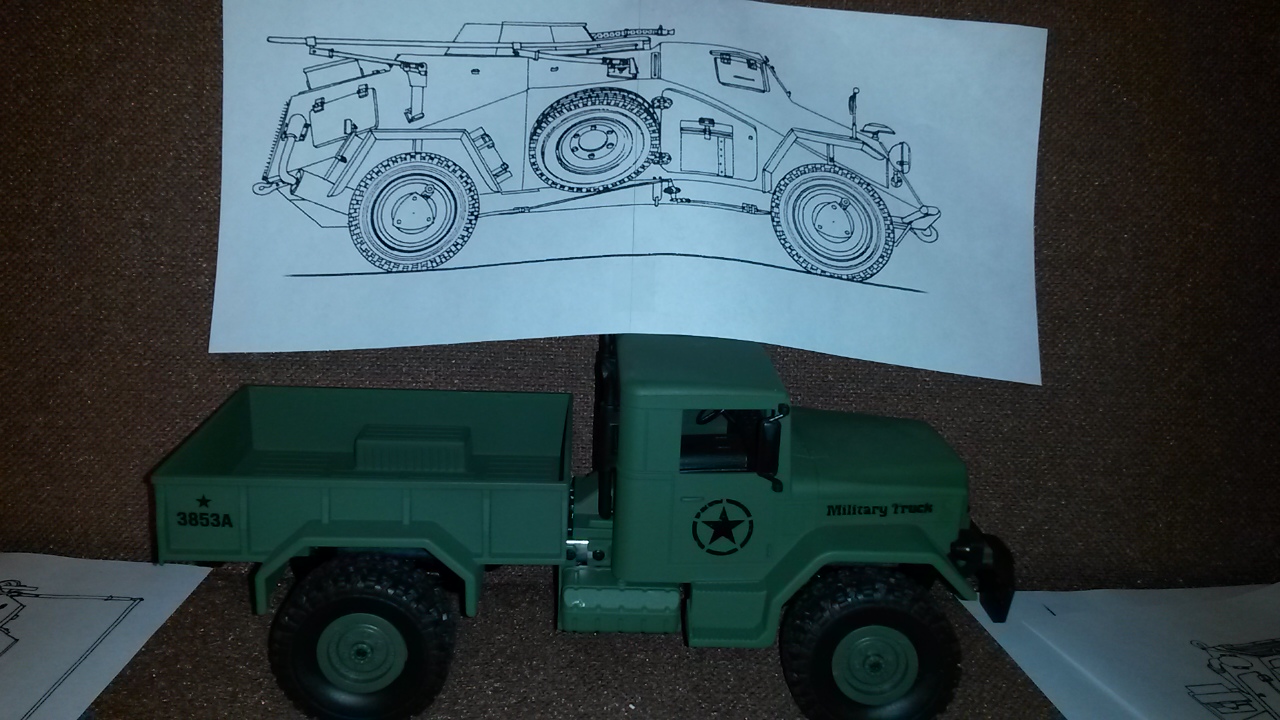

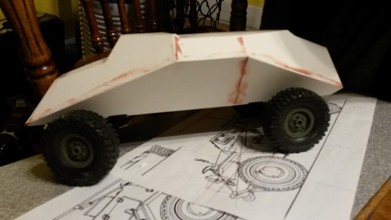

Okay, I finally decided to start doctoring on my HL truck. I was wanting something to run with our German tanks, but wasn't having any luck coming up with any ideas. I came across a picture of the 223 and thought it would make the perfect build. I think it's pretty close to 1/16th, but not exact. I scaled the prints to match the tire diameter and went full speed ahead.
Here's the truck with the scaled up plans.
prints
prints

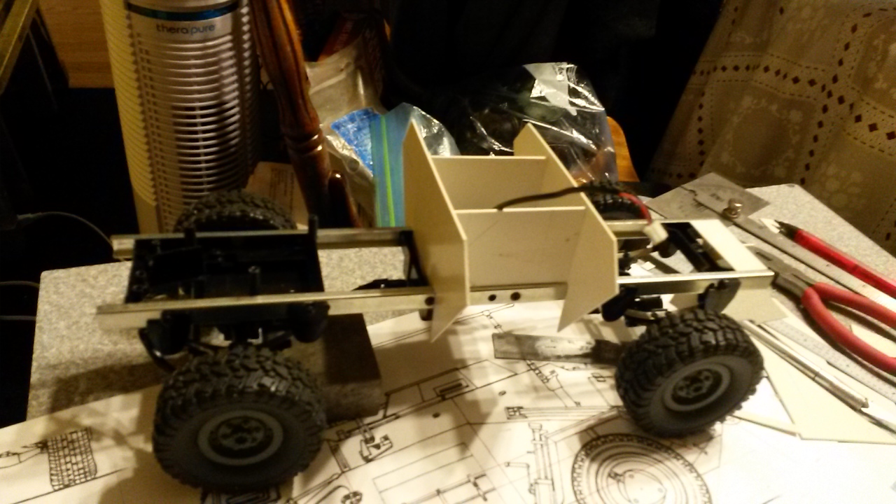

I had to lengthen the wheel base 15mm to make it match the prints.
wheel base lengthened

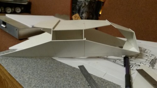

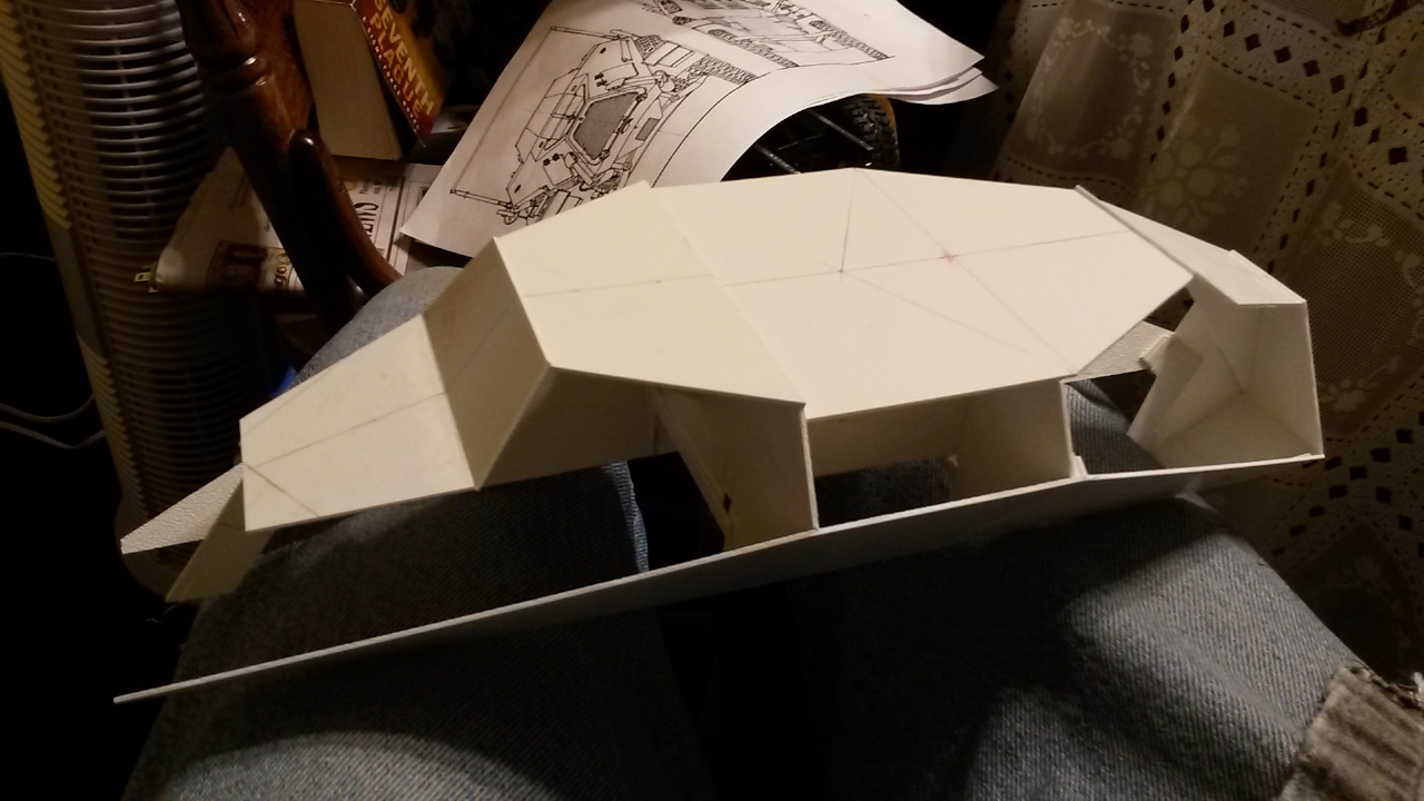

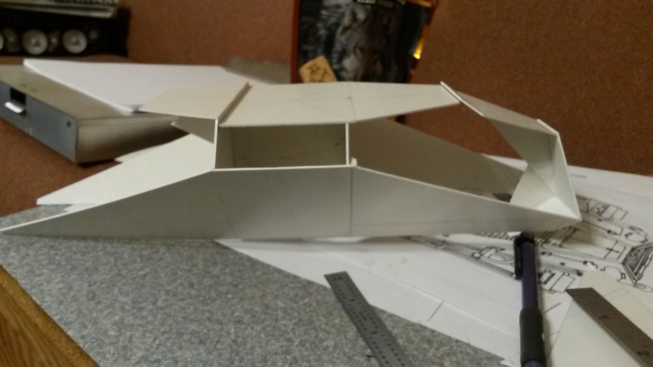

I used ribs to make a center box section to build the rest of the body off of.
framing started
framing started
center box
center box

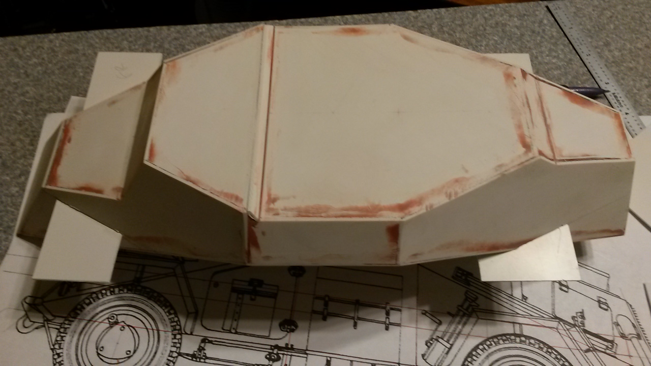

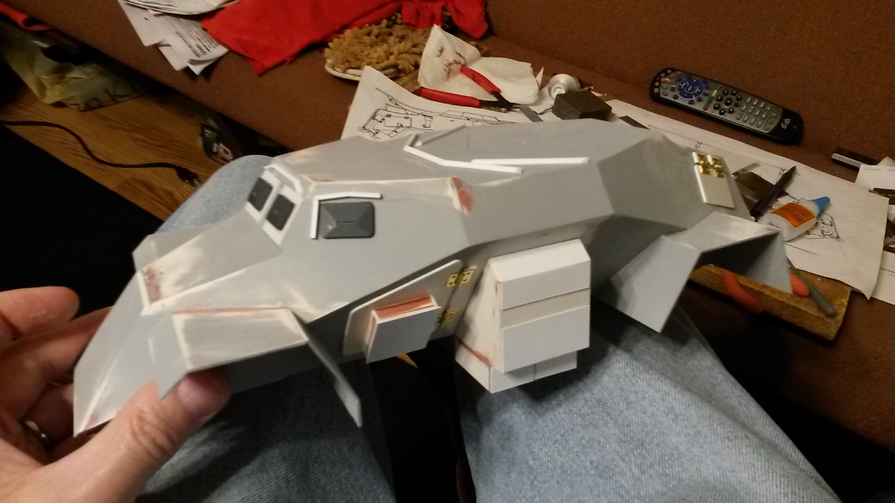

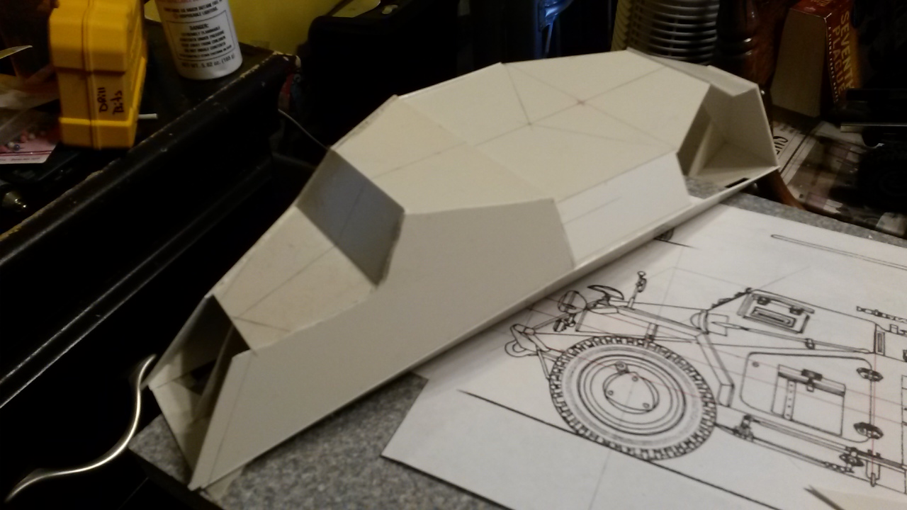

And starting on the body itself.
side panels
side panels
rear lower
rear lower

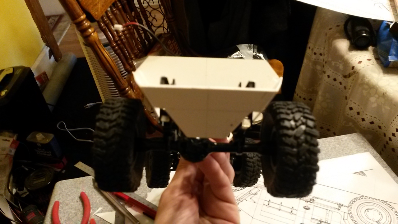

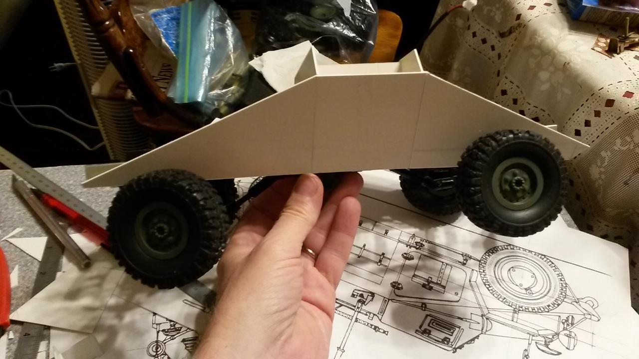

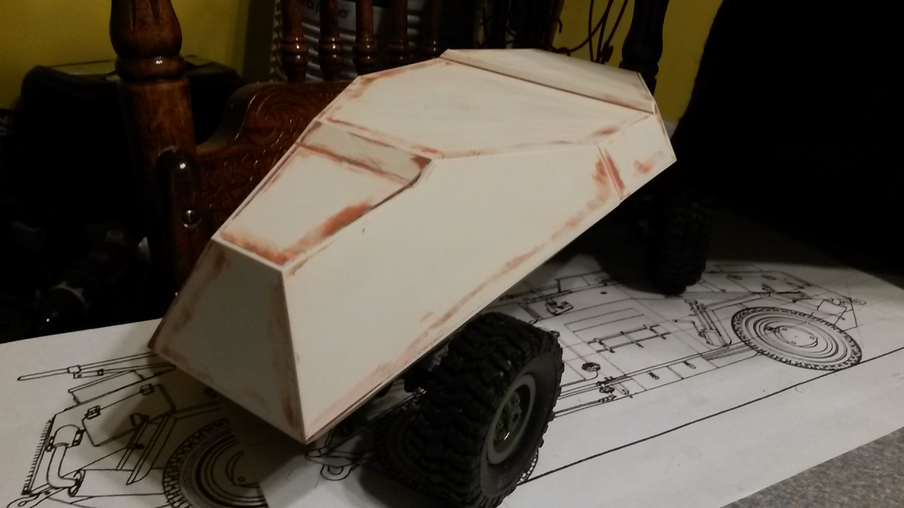

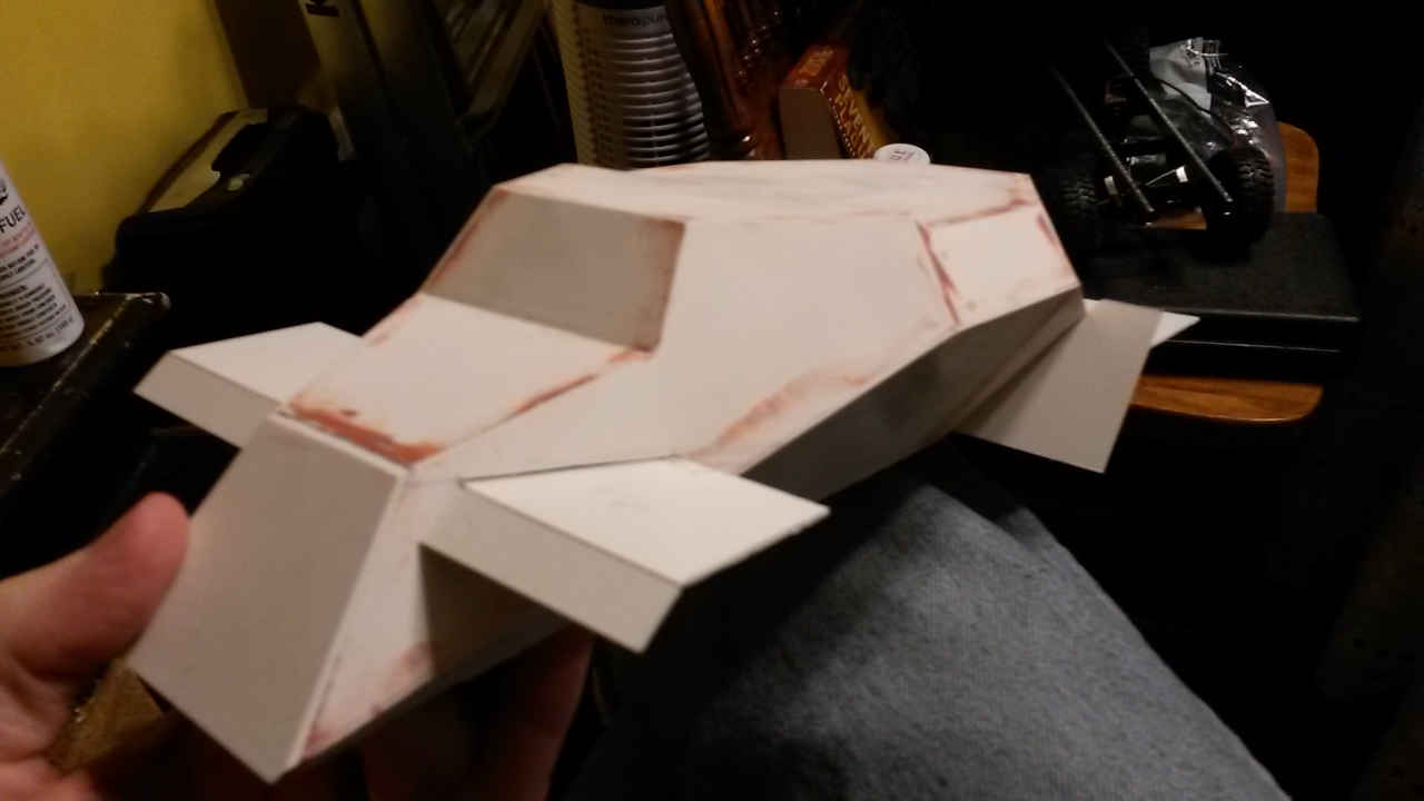

Here's how the body came together...

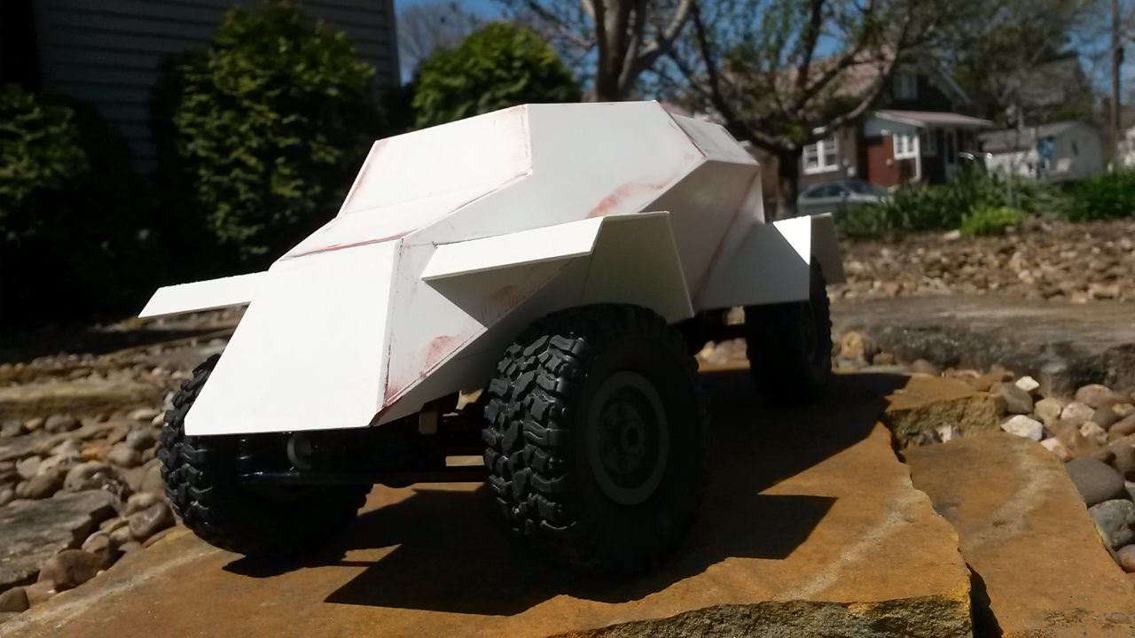

Test fitting the body onto the truck frame.
on frame 1
on frame 1
on frame 2
on frame 2
Had to do a bit of trimming on the frame, but nothing too severe.
More to come!

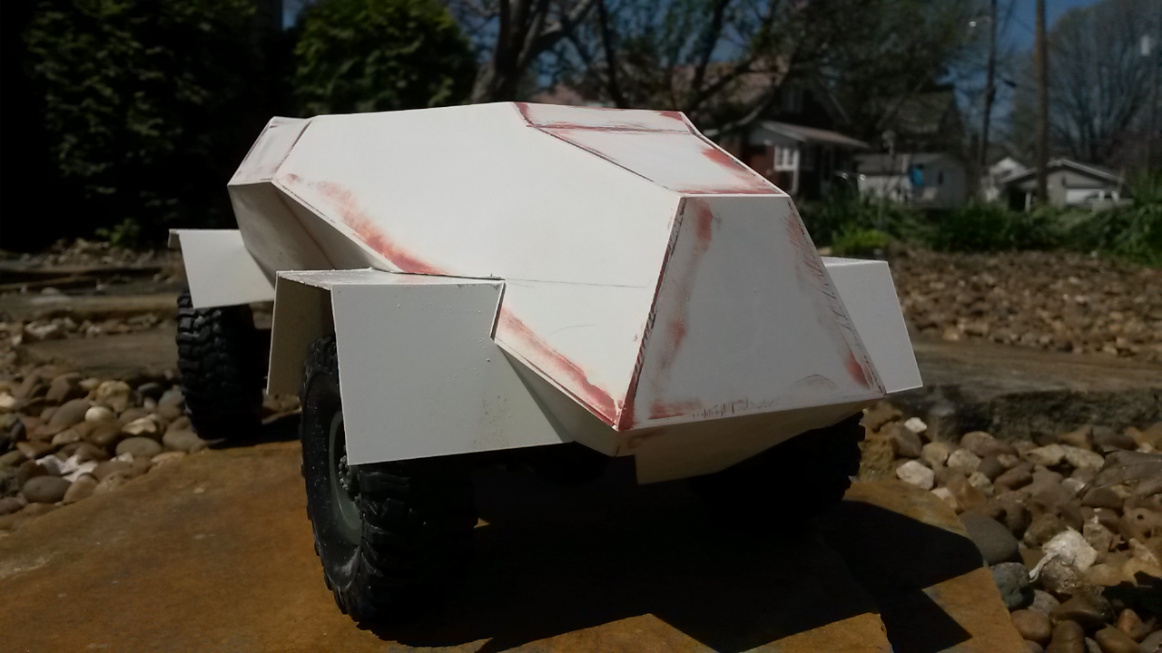

I ran the top of the fenders all the way through the body to give them a bit of strength...
fenders 1
fenders 1
fenders 2
fenders 2

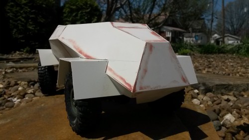

Here's some shots of the body, so far, mounted on the chassis.
outside 1
outside 1
outside 2
outside 2

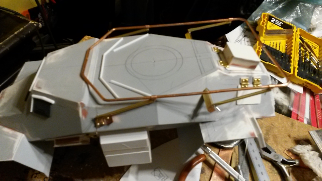

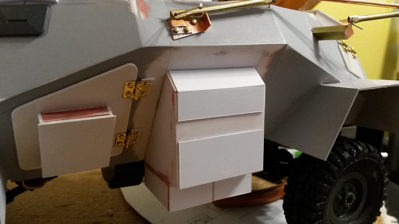

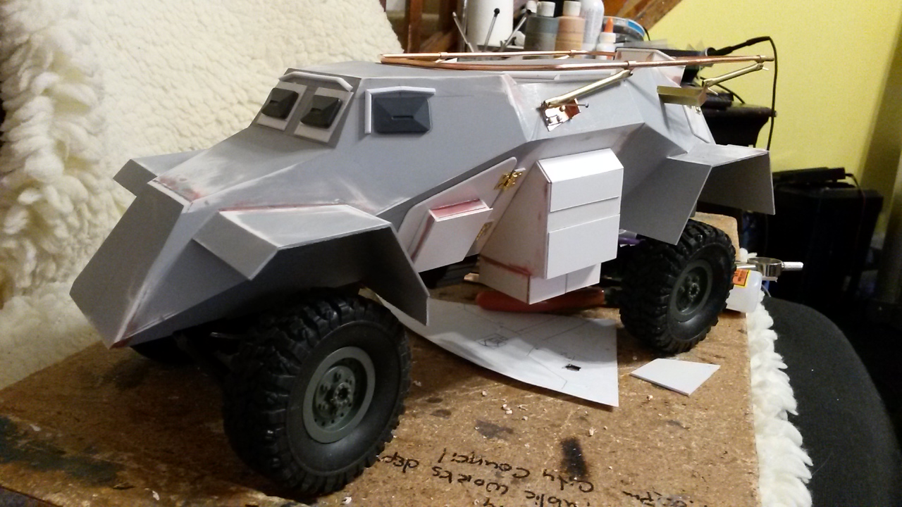

Adding the details now...
view blocks and tool box

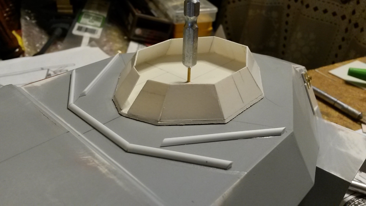

top turret
top turret

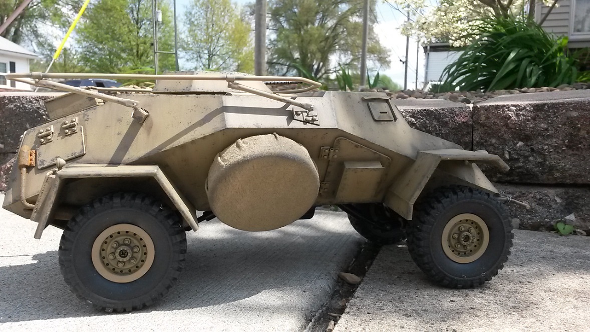

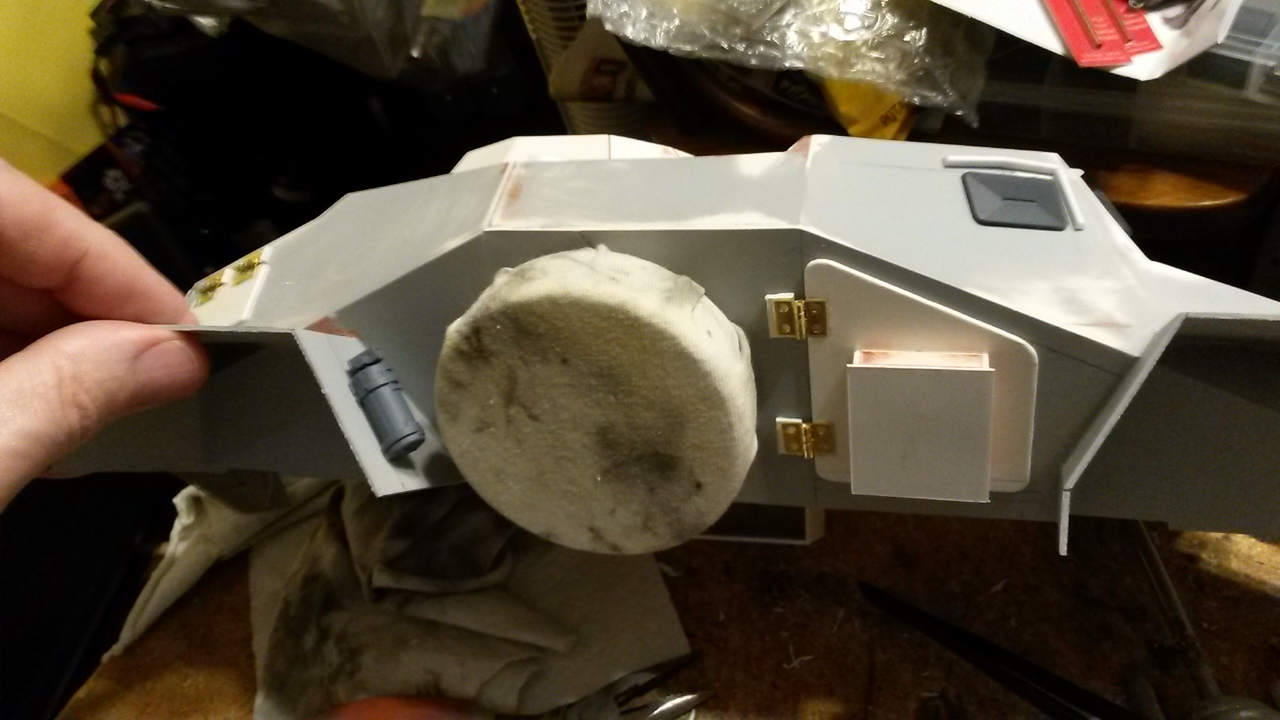

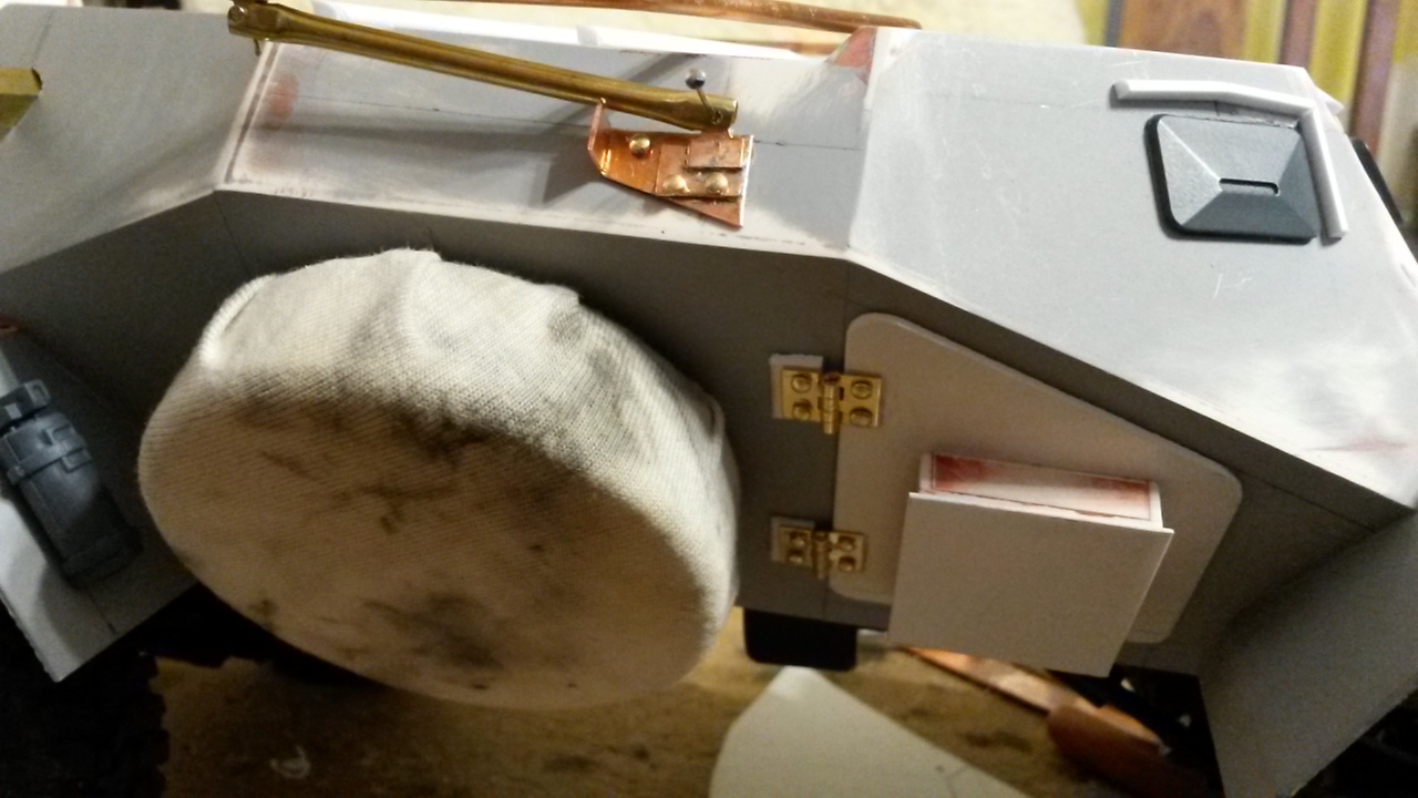

The spare tire is just foam covered with a piece of cloth
spare tire
spare tire

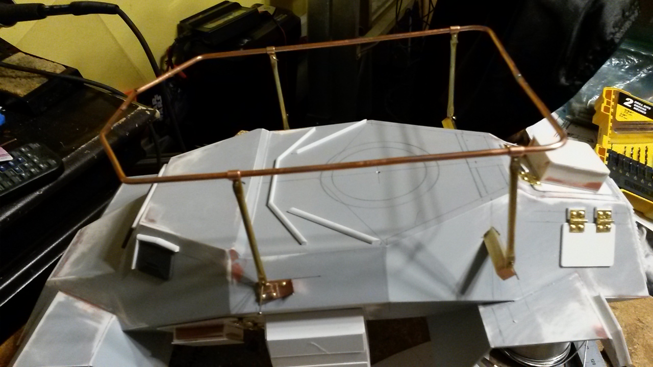

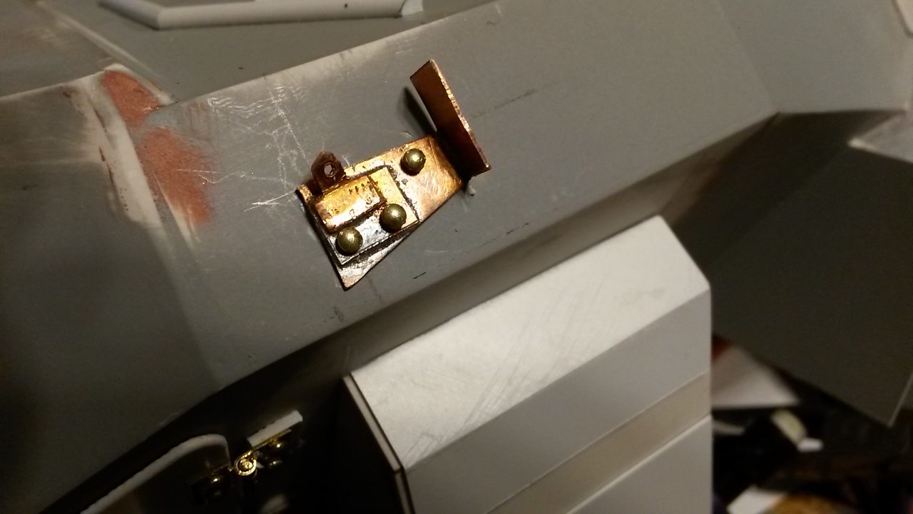

Here's the front mount for the antenna.
front antenna mount
front antenna mount
The plan was to have the antenna be able to be placed up or down.
antenna down
antenna down
antenna up
antenna up
More coming!

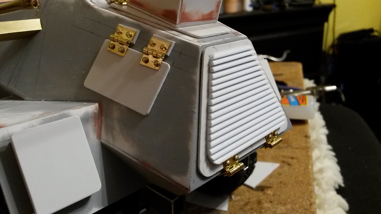

Here's some pictures of the details...
rear hatch
rear hatch
passenger side
passenger side
drivers side
drivers side
overall view
overall view

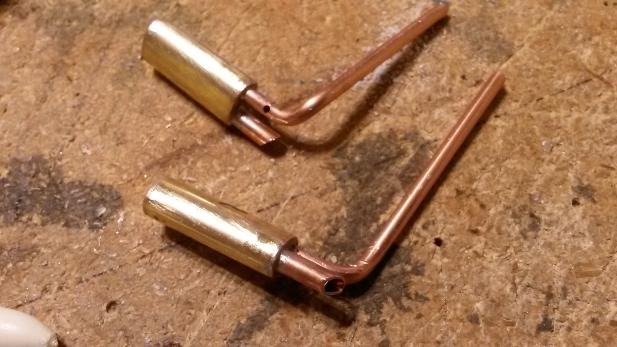

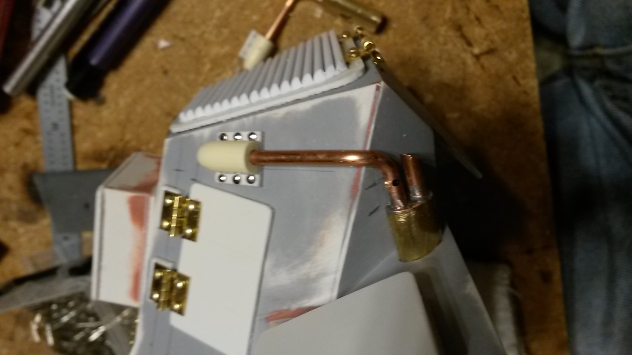

I made the mufflers out of flattened brass tube, copper sheet, copper tubing and solid wire.
mufflers
mufflers
The manifolds are made out of some scrap resin castings.
mufflers mounted
mufflers mounted

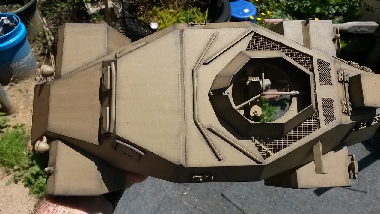

Now it's time for some painting!

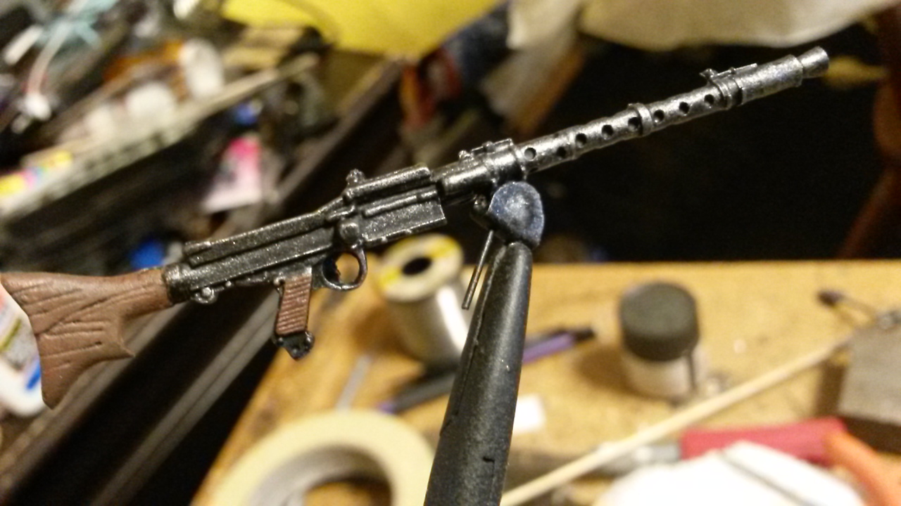

The MG for the top turret
turret MG
turret MG

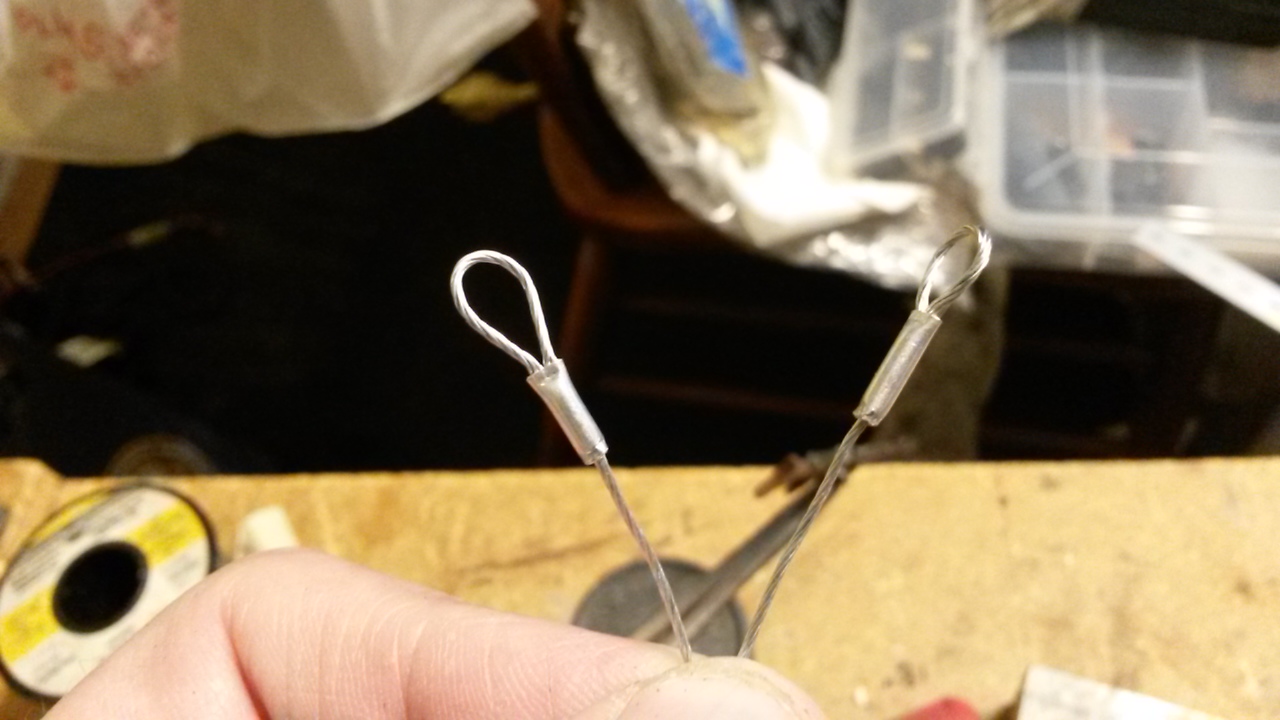

I made up a light tow cable to wrap around the front bumper. It's picture hanging wire and some small aluminum tube.
tow cable
tow cable

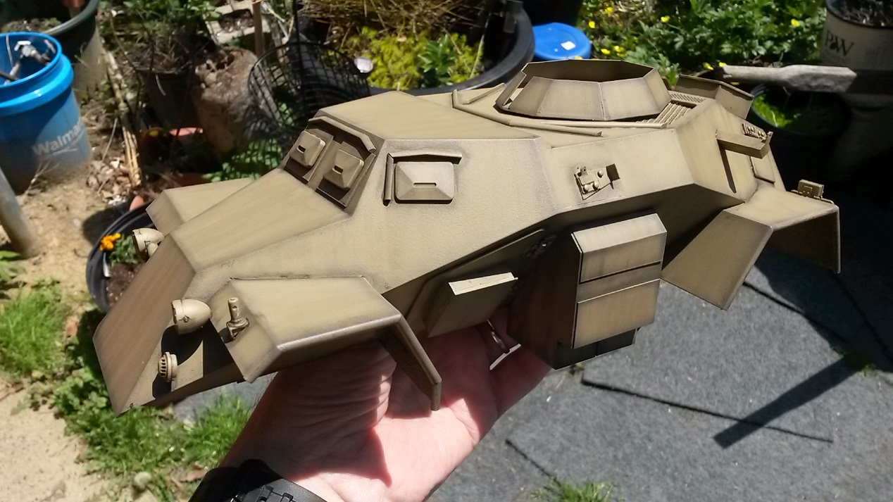

Here it is after a coat of sand paint and some shadowing with the airbrush.
painted 1
painted 1
painted 2
painted 2

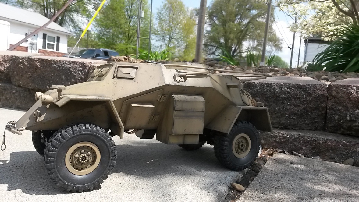

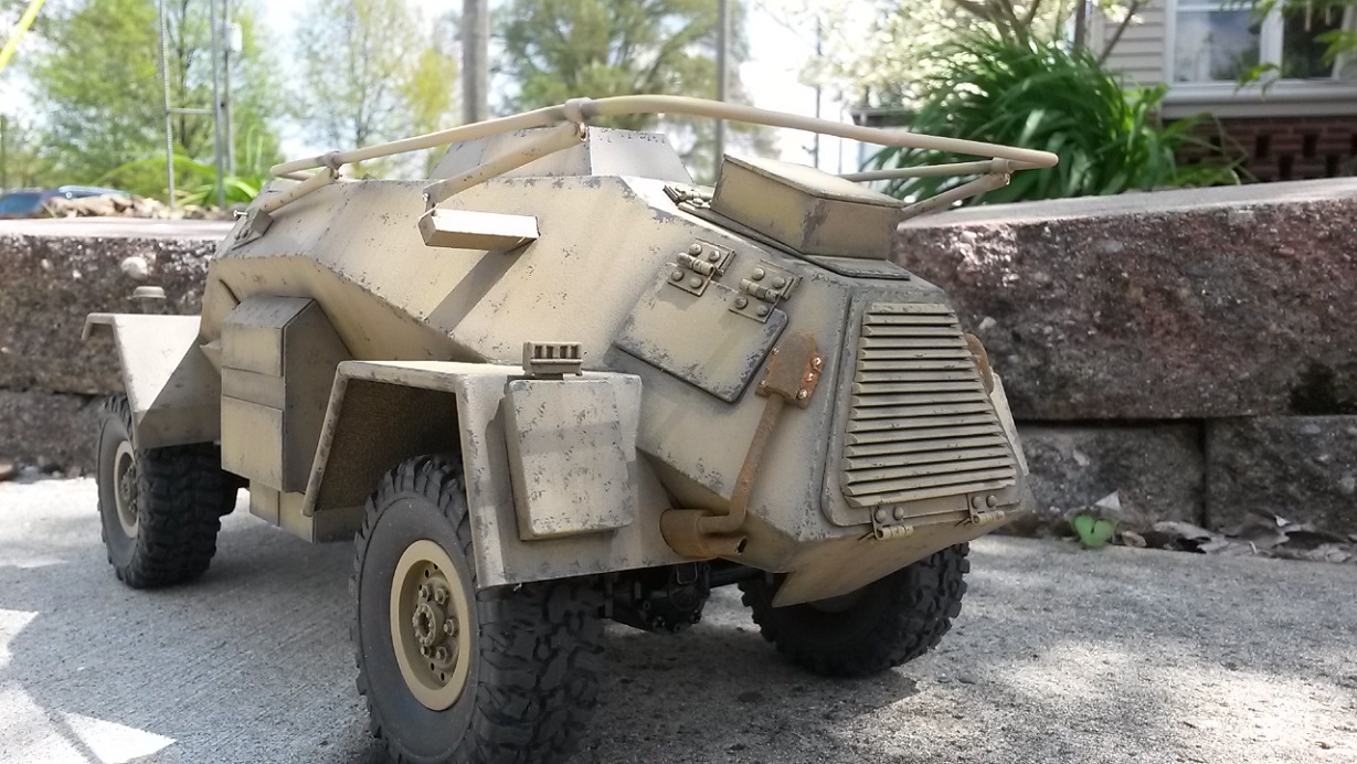

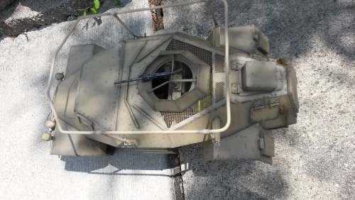

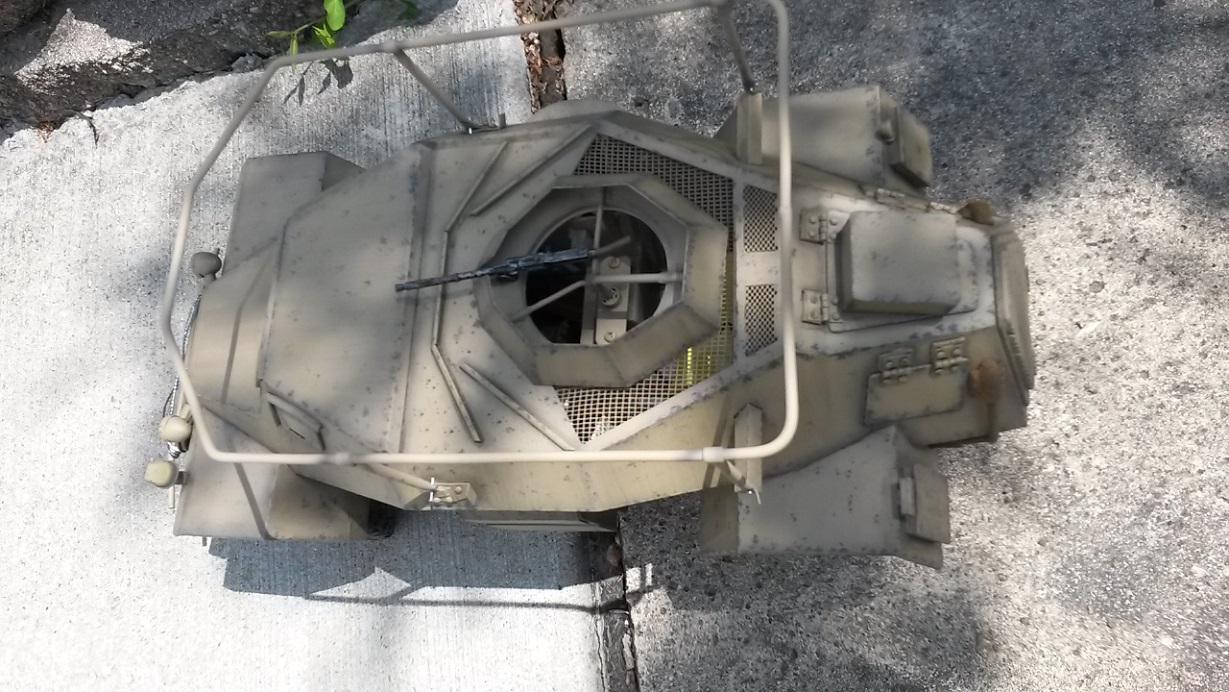

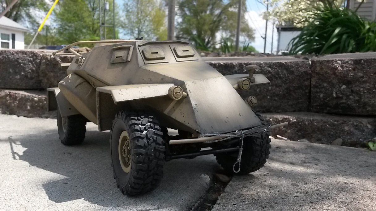

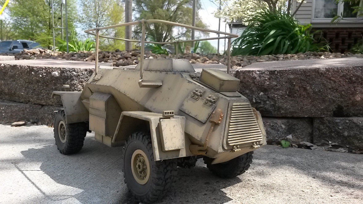

Got the paint chips painted and had to get it outside to get some decent pictures!
outside 1
outside 1
outside 2
outside 2
outside 3
outside 3
outside 4
outside 4
outside 5
outside 5
outside 6
outside 6
Still have some detailing to go, but it's getting there!

Thanks, Marco!
It does look pretty cool running around on the ground. I've got to get a video of the turret in action. I have it tied ionto a servo with the 4 wheel steering option on my radio, so it moves as you steer the truck.
