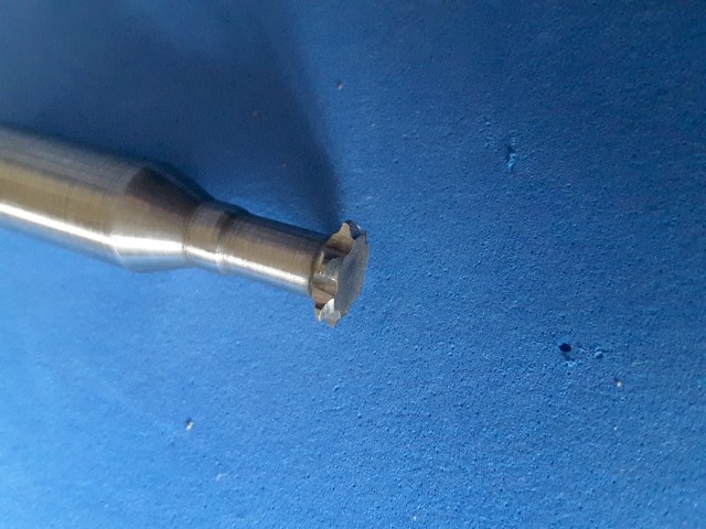

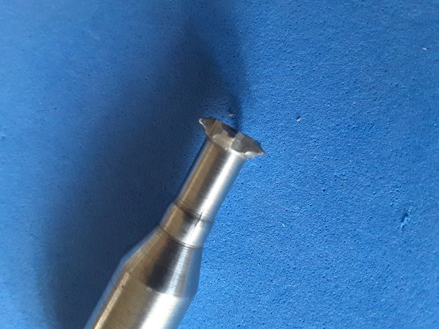

The motor driven gear has 45 teeth I wanted the modified gear boxes run slower so the bevel gear had to have the number of teeth increased.
I could only manage 7 extra teeth with a max. diameter of of 30.3mm. That would give a clearance of about 0.5mm to the neighboring gear.
The bevel gear has a face angle of 79 degree and pinion has 11 degree.

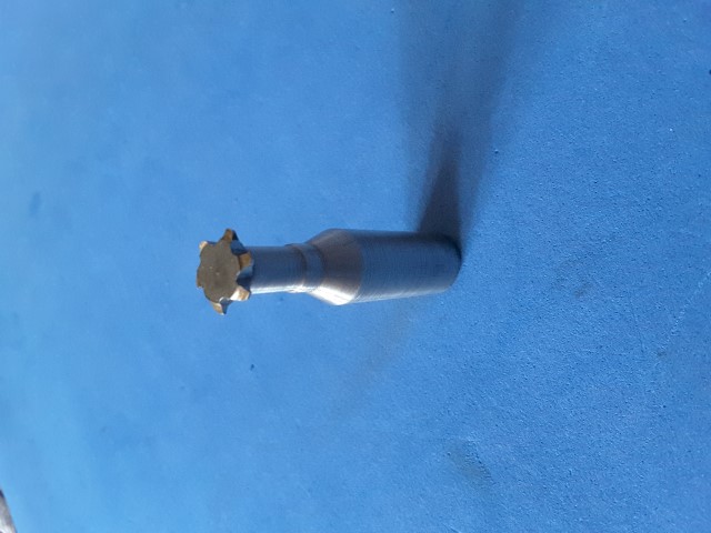

The first thing is I had to make a gear cutter.

Cutter
Cutter
Cutter
walter
Posts: 567
Location: Geelong Australia
Re: Modifying Standard Gear Box
Post by walter »
Cutter
IMG_20180426_162511 (Small).jpg (80.95 KiB) Viewed 6888 times

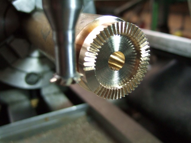

Bevel gear cutting in progress.
095 (Small).JPG (74.88 KiB) Viewed 6884 times

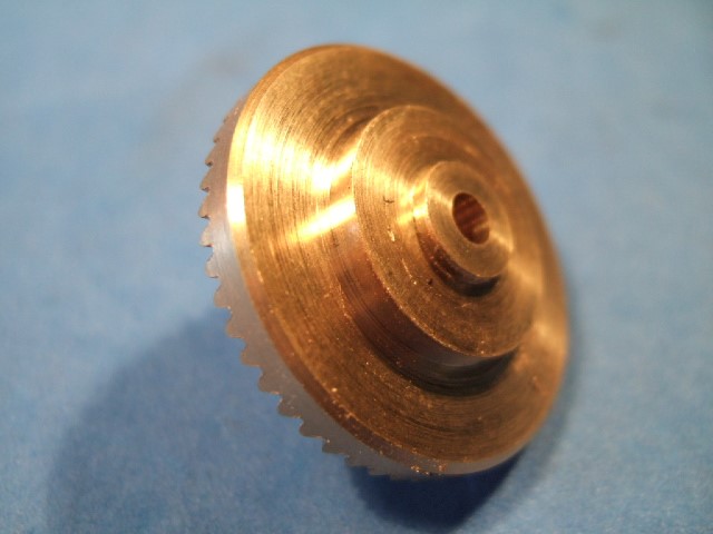

Finished bevel gear.
096 (Small).JPG (82.74 KiB) Viewed 6883 times

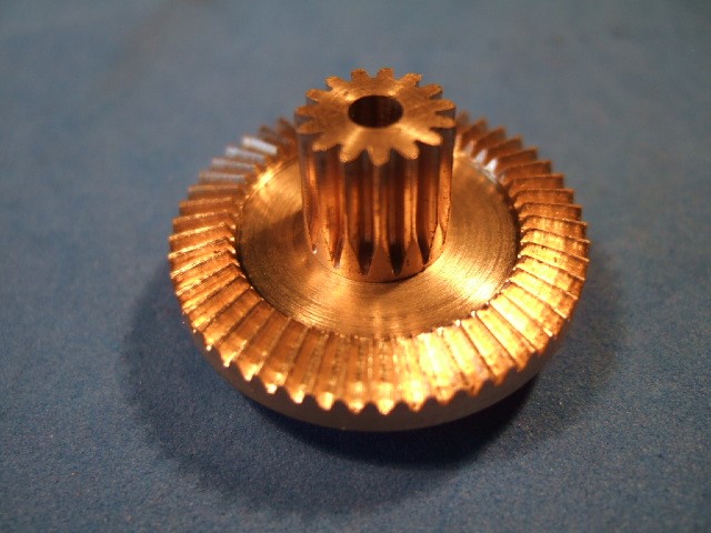

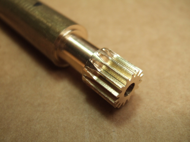

This little gear with 15 teeth will be pressed into the bevel gear.
walter
Posts: 567
Post by walter »
Like that.
105 (Small).JPG (83.81 KiB) Viewed 6879 times

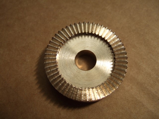

The back of it.
106 (Small).JPG (56.92 KiB) Viewed 6878 times
