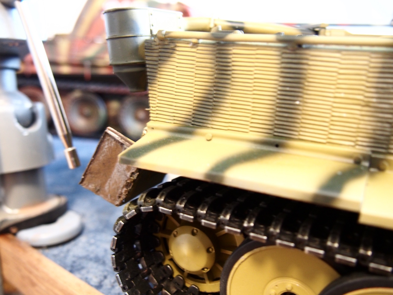

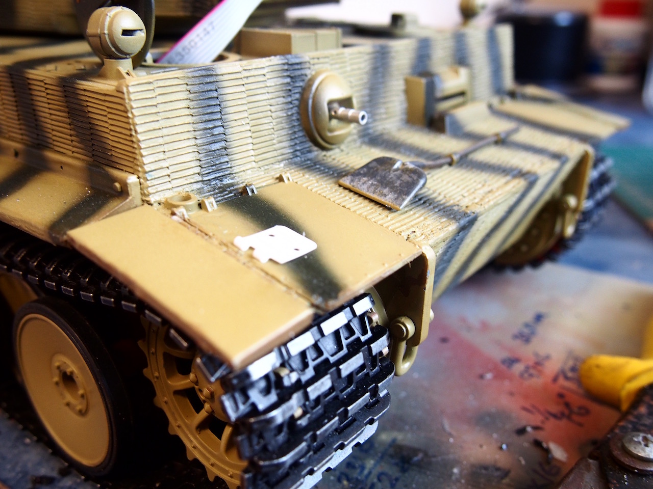

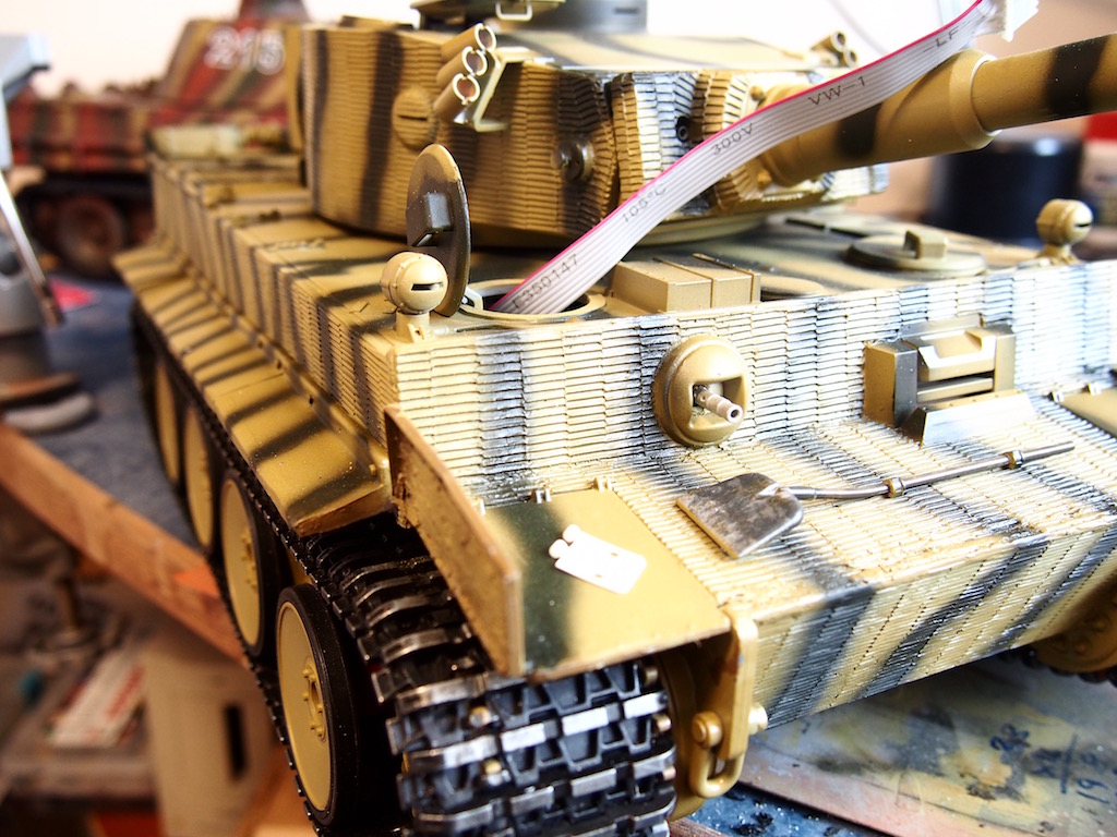

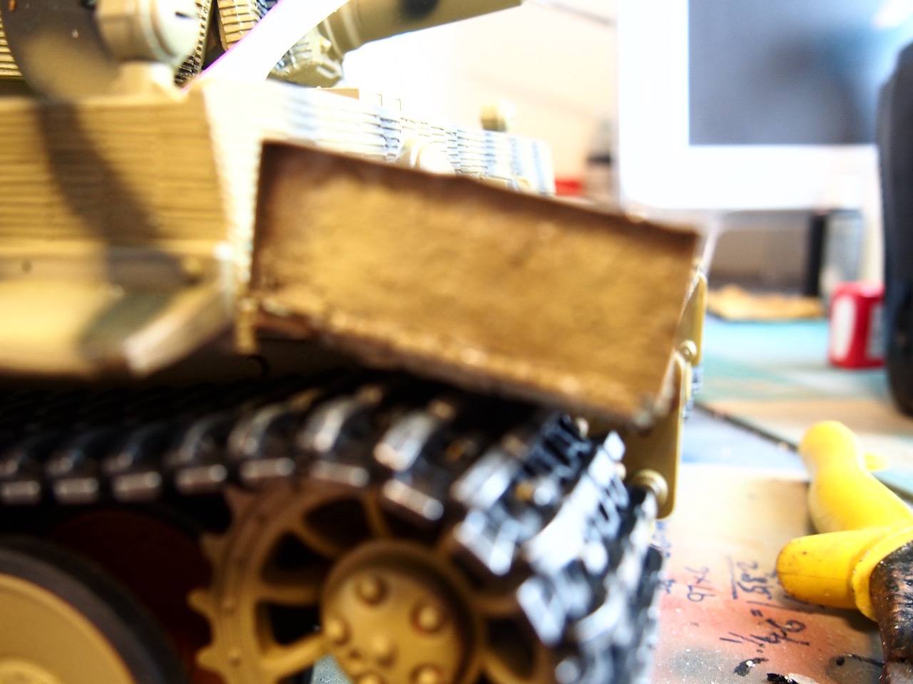

Gave my Tiger 1 a tidy up wanted to sort mudguards but not fit Aber . Used small plastic hinges for rc plane. Cut off mudguard extensions , file an angle on main mudguard glue and pin .You want the hinge to just be proud of surface, cut some styrene or thin metal to size. Best to have a lip on underside to hide hinge then plaster some filler ( mud effect) to hide hinge when its folded up.
