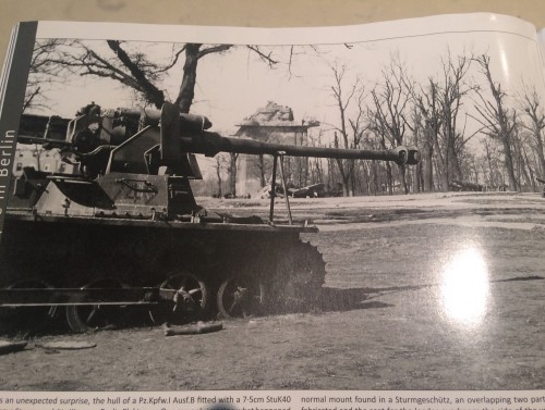

Posts: 11843
Re: Behind the scenes
I have a pic of an 88 on a Pz II , will find it and post. Just to show that the concept is not actually that fictional !

Panzer wrecks 2
Posts: 11843
It’s actually a 1 .
Will transpose the text ASAP
