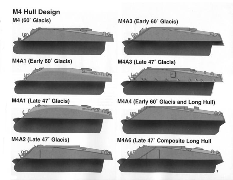

Re: Firefly conversion kit.
I presume we're referring to Dean's kit here. I have that kit, and have found that there's no discernible difference between the length of kit's upper hull, and the Taigen M4A3. :problem: unless, that is, Dean, revised it in a later offering. Whilst it's a fact that the Firefly based on the M4A4 (Firefly Vc) chassis was actually around 10in to 1Ft longer than previous versions to accommodate the bulkier power plant, I think that Ic versions based on the Hybrid and Composite M4 Shermans were probably no longer than non-Firefly models.
http://the.shadock.free.fr//sherman_min ... index.html
If you had the M4 'composite' hull, for example (cast front/ welded rear), you would not need to extend the hull anyway. The Vc Firefly was the version most frequently converted by the British, and should be longer than standard;
but if the kit's upper hull has not been extended, then it would look slightly odd sitting atop an extended M4A3, or M4A1 hull...., although it has been done here several times. Dean's kit upper hull has a swallower slope on the glacis plate than Taigen /HL M4A3 versions, as one obvious difference. Some Sherman tanks..without going into this in depth..had a 60 deg glacis plate, while others had 47deg. His had nearer 47 deg.
Sherman glacis plate angles..
Sherman Glacis shapes.jpg (42.65 KiB) Viewed 2451 times
