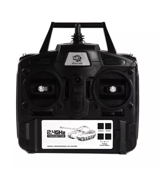

Re: How to Identify HL Radio Versions?
Hi Shaun,
so this is the one I have. So I gather this is the latest version from HL?
Yes exactly right.
Shaun.
