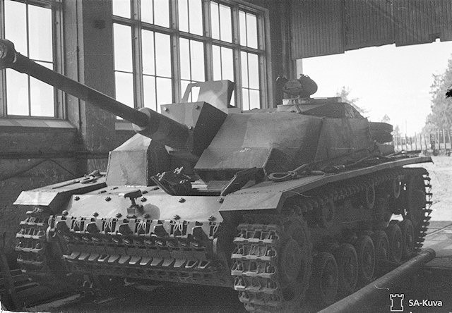

This clean photo of Ps531-22 is a rare period photo from 1944, showing no zimmerit. Interestingly from my point of view, the Finns donated it to an Estonian military museum in 2008:

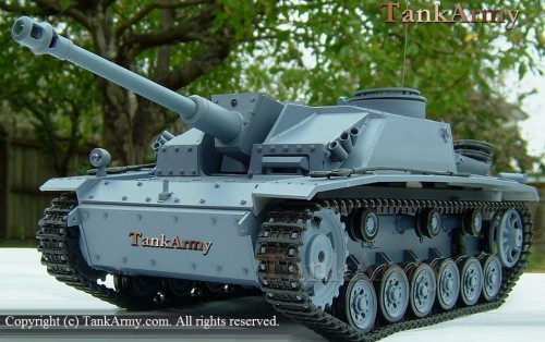

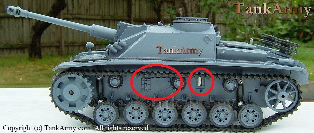

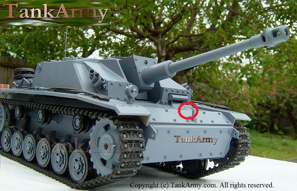

An interesting question. I couldn't find any criticism of the HL Stug, apart from the airboxes. If you go to the What To Fix On Your New Tank section there is little for the Stug, unlike the Tiger I. As a representation of an Early Ausf G, I think its pretty good.
Here is all I can find:

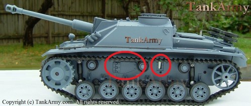

Like the real thing, Heng Long uses the PzIII lower hull. It is not surprising as they are identical apart from the side escape hatch that apparently only 30 or so early Stugs had and not the Ausf F or Ausf G. (Edit: just read in Panzerwrecks 7, that 170 Stugs were built with side escape hatches in 1944) Also, there is a slot that appears to be for the old style receiver switch, which needs to be filled.
This is a second batch Sturmi, fully restored, but featuring post-war modifications. Notice how the track dips slightly after the rearmost return roller. On the Heng Long the track stays level. Its only slight, and doesn't bother me enough to relocate the return rollers higher.
Just for the rivet counters, there is a bolt missing behind the central Notek.
In a real Stug there should be enough room to squeeze a standard German radio under the casemate roof. It doesn't look like it on the Heng Long.

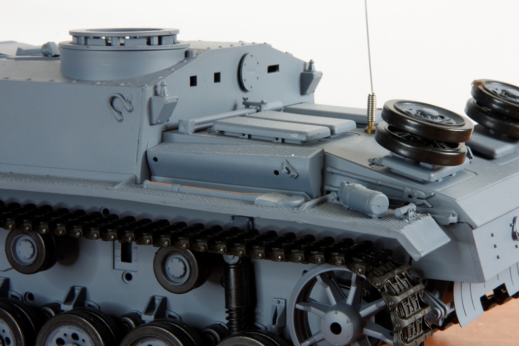

The airboxes should be open on top with screening mesh. Apparently the Heng Longs have always been closed. The first ones had a sticker to imitate the mesh, and they were later changed to have a moulded mesh. Some of the aftermarket bits include open airboxes from Asiatam and photo etch mesh.
Most of the tools on the upper hull are moulded in, which is not impossible to fix, just painful. And lastly, the airboxes are correctly tapered from front to rear, but my Stug is blessed with a right-hand airbox on the left-hand side. The glue monkey must have known it was wrong, as the right-hand side fits neatly. I guess he ran out of stock.
