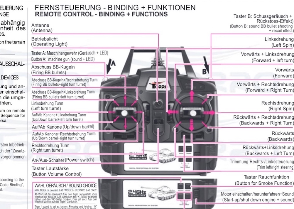

Indeed, but I am referring to full functionality. You're not going to get that with the older transmitter. That was really my point. :think: In fact, there's no evidence yet that it will work at all.
Just so that others may get an idea of the differences, here's the latest transmitter and its functions:
Heng Long TX functions v.5.3

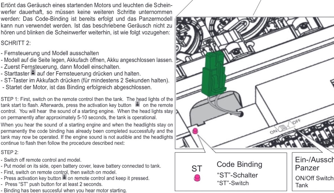

Just as an oddment, here's the binding procedure for the HL t90:
HL T90 binding procedure
Hope this all helps to resolve your issue... :wave:

Hi.
Thx for that info, from the schematics above of the version 5.3 tmitter it appears exactly the same functionality as the earlier black 2.4 ghz set except for the 2 top buttons.
But as you say means nowt if it wont bind we shall have to wait and see .

Yes. Ignoring the obvious revised arrangement of functions (ie: two additional top buttons), the two bottom buttons of the quartet on the latest TX's main panel, also now have extra functions, with possible extra trace pathways on the PCB. I can only imagine that those functions will not be transferrable to the earlier iteration of the TX (3/4), simply because the new instructions were not flashed on them in the first place, and the extra traces are probably absent from the PCB of older transmitters.
I guess that HL, Taigen, et al would prefer people to buy an entire upgrade package of MFU and TX, and not upgrade piecemeal. Major electronics and computer producers like us to be trapped on the upgrade treadmill, by fair means or foul. 'Foul' comes when backwards compatibility is not guaranteed, or as with new smart phone features, for example, that can only be enabled on the latest hardware version of the phone. Maybe MFUs are heading that way.. :think:
