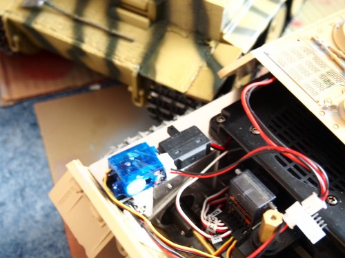

Was looking at the new Kingtiger post, easy way for headlight and convoy light if you want them on together.
Open up a servo (better if it has stripped gears) cut the motor cables .
Solder a 2 pin jst socket on and glue onto the side .
Plug into the gear on the rx .
No resistors or messing with the tamiya board.

Now i have discovered the attachment button here is my lighting/ power switch for Tamiya tanks . Servo is switch and 5v power for front led and convoy led.
