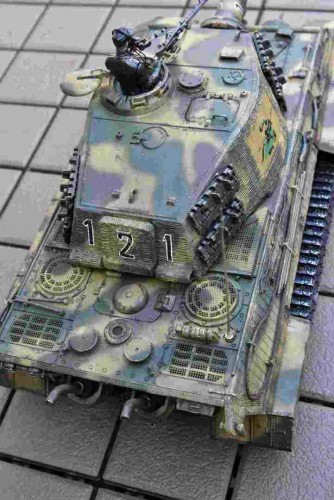

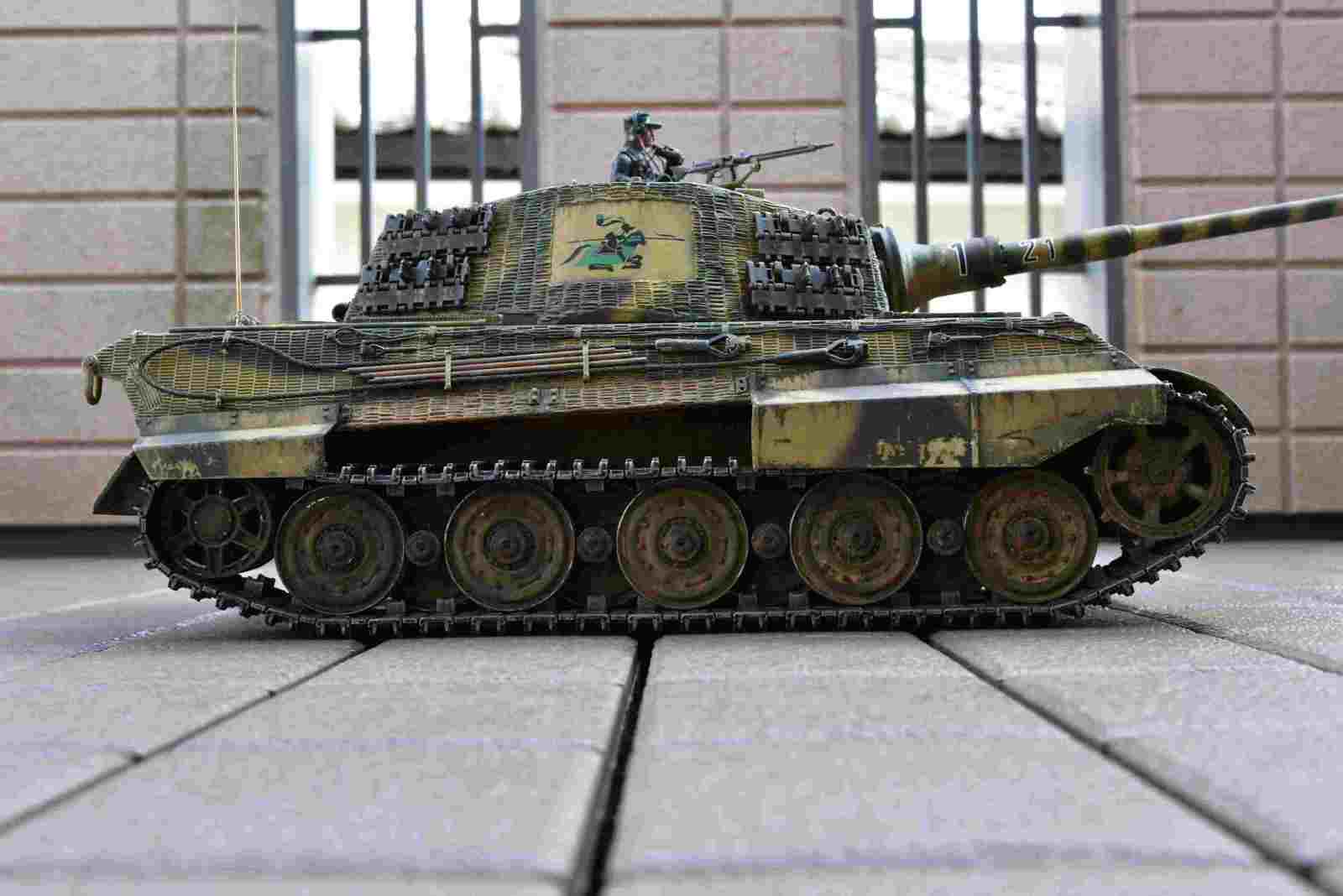

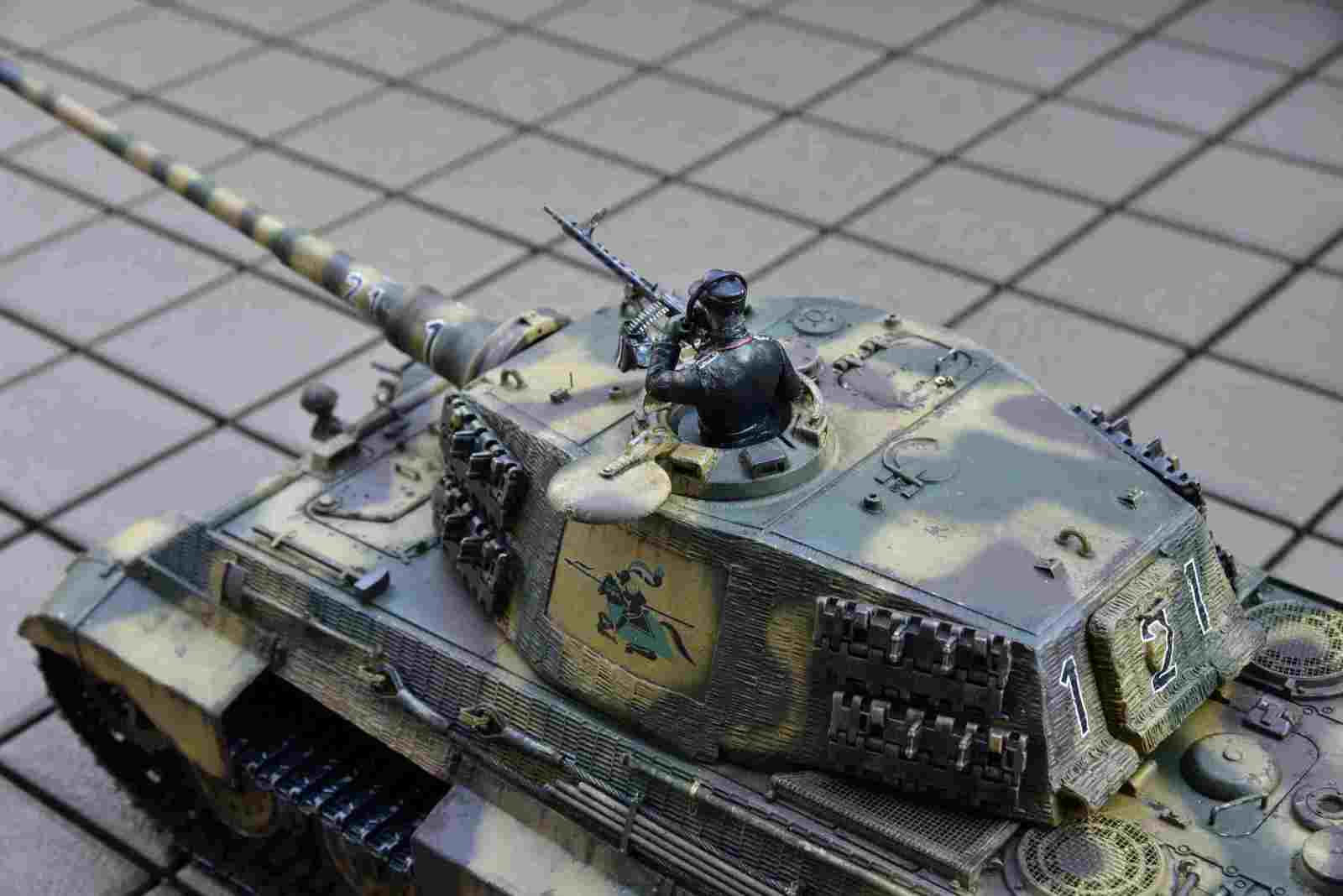

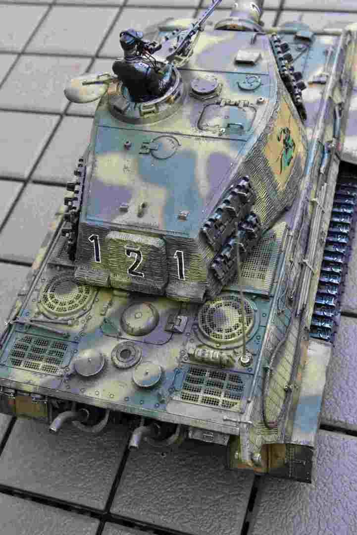

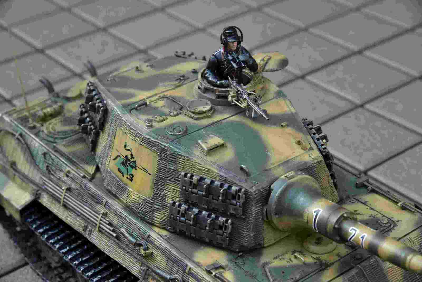

Because the gap between TORRO King Tiger's Saucop and the turret is extraordinarily wide, I modified the gap part and opening part of the main gun coax machine gun.
Since this tank of the 505 heavy tank battalion should have been manufactured before September 1944,
I changed the intake port cover of the engine room from a circular armored cover to a bolted type mesh cover.
Commander Cupola machine gun racks, bullet belt, and bullet bags were rebuilt with brass and paper. I made a bullet belt by cutting the brass wire to the same length, sharpening the tip, sticking it to the black stripe paper at equal intervals, and then laying a strip of paper on top of it.

You have some very accomplished details there Kin.
Above all, I'd say that the ammunition belt is the standout piece of work, and cleverly improvised! Well done.

Thank you very much. This is my first remodel of my 1/16 scale RC tank. The ammo belt of 1/16 scale machine gun was hard to find suitable flexible one so I made it by myself.
