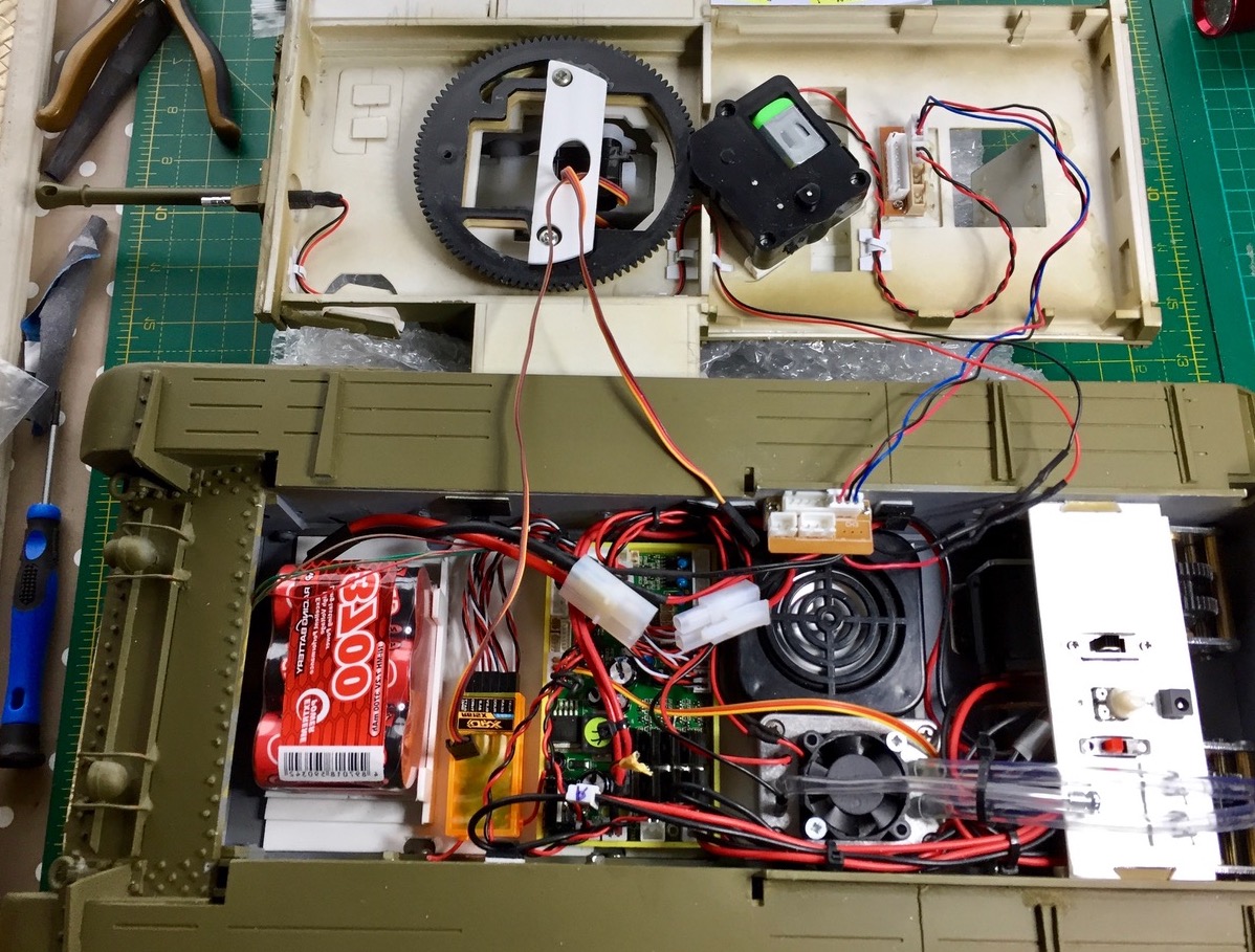

Research, and planning, can save you a lot of head scratching later- and money too. :think: To Wolfman and RochesB, I think you're both taking the right approach. :thumbup: The trick is not to make avoidable mistakes. Cramming the lower hull with electric gizmos is a challenge in itself, and you can give yourself a little congratulatory pat on the back when it's done. But now that you have the rolling chassis functioning properly, you think that you've cracked it..until, that is until it's time to mount the upper hull and turret. That's when the disposition of the lower hull components can impact on, or block the functions of the upper hull, for example: the Gun can't elevate; the turret can't turn properly, or- worst case scenario- the upper hull can't even sit on the lower one comfortably without being compressed like a bulging suitcase! :O
Put simply, the safest bet is to buy the biggest, deepest, and longest hull you can for starters. That would probably be the King Tiger or the KV-1.Once again, when considering the hull closer method, Taigen/Torro alloy hulls
offer a reliable quick release system- which as the names suggests- allows easy access to the tank's interior. You don't want a plastic hull as these are generally screwed together in an awkward, time consuming fashion.
This is what I crammed into my Cromwell project. Twice before, I had to reposition the entire contents (barring motors :/ ) of the lower hull, as they prevented the gun from elevating properly, and also made closing the two halves a real pain.
This is the final disposition (n.b. The Cromwell has relatively low profile, and subsequently shallower hull real estate):
Cromwell interior and electronics
This has the sizeable Clark TK60 fitted. I had to buy a more compact 7.2 v battery than the usual type in order to find space in the narrow hull. Incidentally, the Cromwell is about as long as the Tiger !, but as narrow as the PzIV.

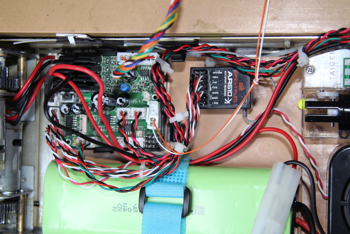

here by contrast, is the interior of my Torro (metal ed.) King Tiger, with a Clark TK22 at its heart.
Torro Metal ed King Tiger interior
.. As you can see, there's space enough for everything.What you don't want is a space that resembles that old 15-puzzle where you have to shift everything to relocate just one crucial piece :shifty:
