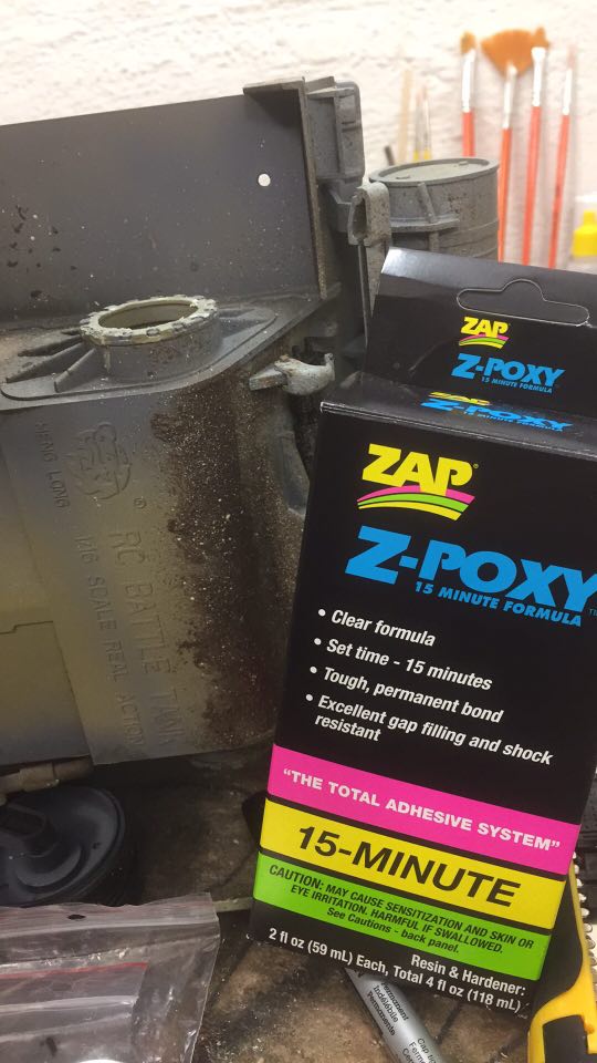

when adding the okmo parts to the challenger I used this glue. Not so userfriendly when doing small parts( mixing up small batches all the time ) but it feels superstrong once cured

I've not heard of Z-poxy before, Stian. It's on Amazon uk though, but seems to be a bit more expensive than the usual suspects. At almost £14 for a 4oz (59g) it's about £4 dearer than JB Weld, for example. Still, if it makes for a good bond, who cares? I may give it a try.
