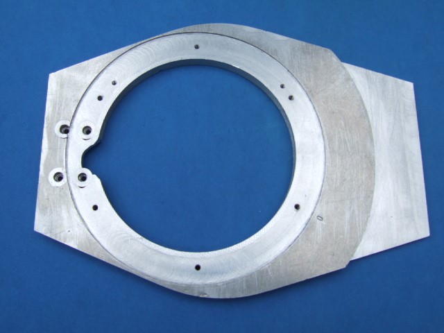

Before I started i realized the turret could reach a weight of around four kilos.
Attaching the turret to the upper deck could be a bit of a problem.
My first idea was to have the turret rolling on dozens of steel balls, but it turned out to be more trouble then I wanted.

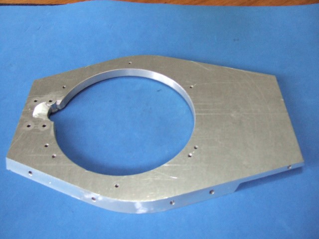

I experimented with teflon washers and found it had wonderfully smooth gliding properties.
All I had to sandwich two teflon washers between the turret floor plate and the upper deck.

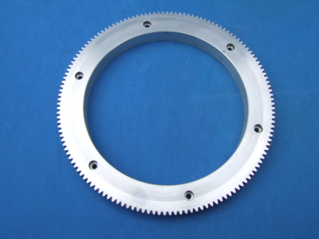

The only thing I had to make a new special turret ring gear.
I went ahead made washers from 0.5mm teflon sheet and the gear from 12mm aluminium plate.
Assembling the lot I was very satisfied with the outcome, it turned very smoothly and without almost no play.

Re: Scratch build Tiger 2 Part 2
Turret base.
- 009 (Small).JPG (64.06 KiB) Viewed 5996 times
Turret base underneath.
- 003 (Small).JPG (62.87 KiB) Viewed 5995 times
Turret gear.
- 010 (Small).JPG (55.66 KiB) Viewed 5994 times
Other side with teflon washers.
- 011 (Small).JPG (70.2 KiB) Viewed 5994 times
