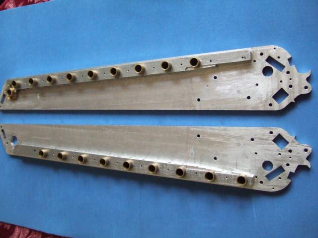

The two lower sides
The two lower sides
120 (Small).JPG (74.69 KiB) Viewed 10501 times

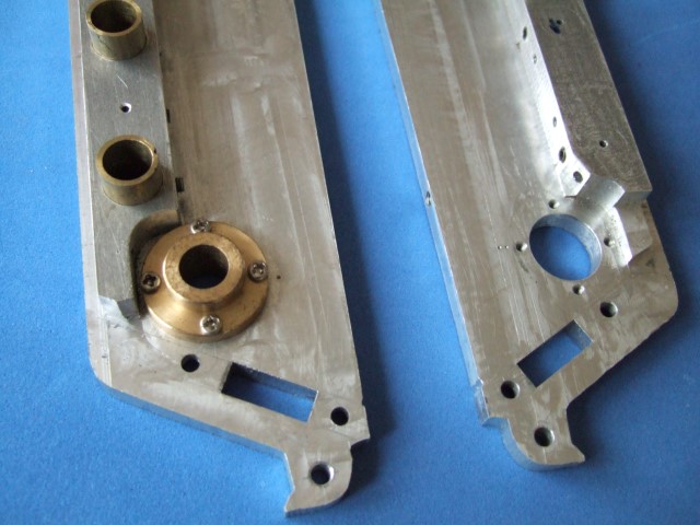

Side fronts.
122 (Small).JPG (89.46 KiB) Viewed 10500 times

Sides back.
124 (Small).JPG (83.67 KiB) Viewed 10498 times

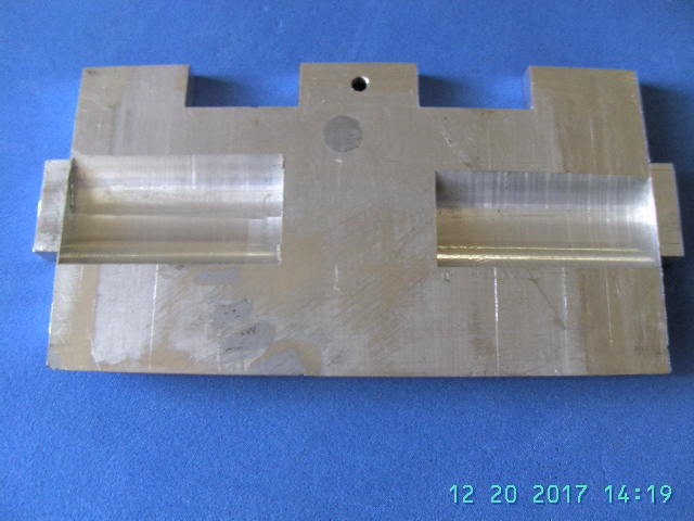

Post by walter »
Front bottom plate 6.5 mm thick.
077 (Small).JPG (58.24 KiB) Viewed 10497 times

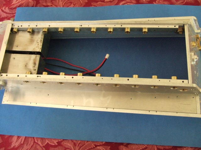

Assembling the lower body.
005 (Small).JPG (79.59 KiB) Viewed 10490 times
