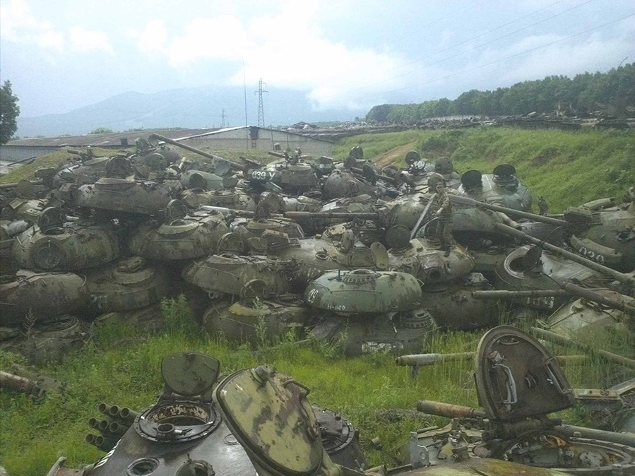

Having started my Hooben T55 I decided on building an Enigma, as many f you will know it was built by the Iraqi's after the Iran Iraq war about 1988-1990, as a direct result of the devastation to tanks caused by rocket launchers. My inspiration was a cover pic from Scale Military Modeller International

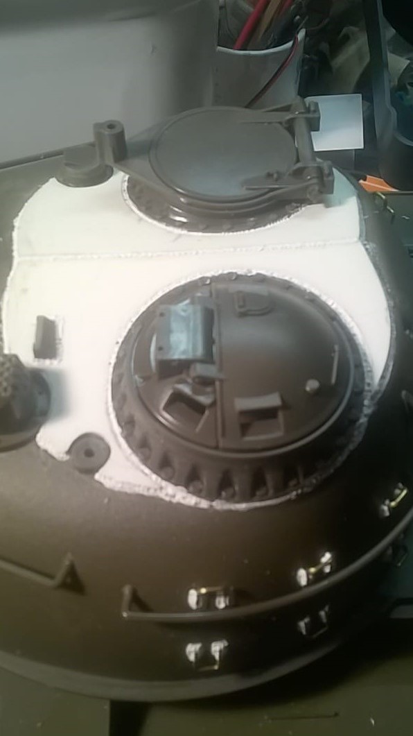

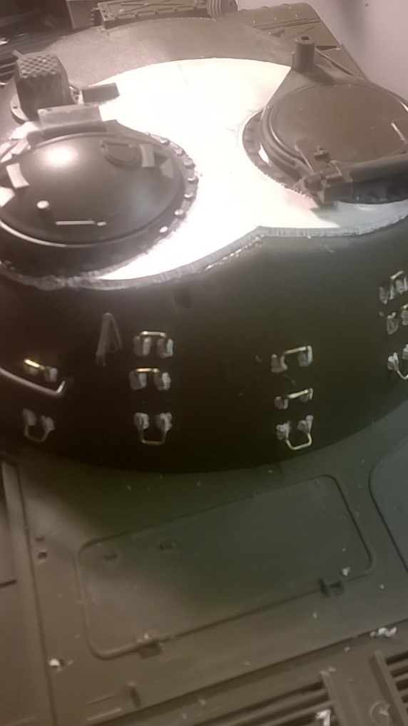

Having built the elevation unit and recoil and got it to fit (you guessed it it needed some work). I started on the turret. There are numerous versions of the T55 as a rough guide the nicer finished turrets are on Polish made tanks then Czech then roughest castings on the Russian built versions (but that's not laid in stone). I decided that I would use the Polish version as a basis. I cut away the very basic cable mouldings, made good the surface and then made paper patterns of the top armour plate that matched up to the reference photos I was using. Then joy of joy i cut these out of plastic card very carefully to get a great fit. Lots of lovely weld lines to add and then the stowage brackets on the side of the turret out of brass wire again welded to the sides

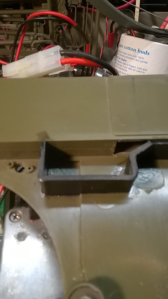

Played around with the interior layout so I can get an IBU , speaker and a smoke unit in. The smoke unit is going in sideways just in front of the motors. Because of the limited height ive moved the fan which normally sits on top of the unit to the end opposite the exhaust nozzle, ill take a picture at some point to show you. Ive cut through the exhaust port in the upper hull and made a frame to guide the smoke. Once ive done the final install (after painting) ill know exactly where the nozzles are and make a better seal.

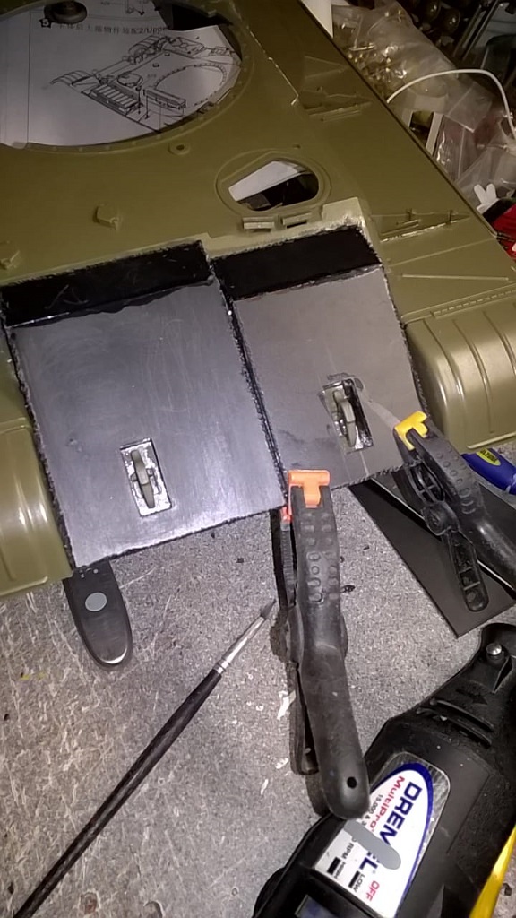

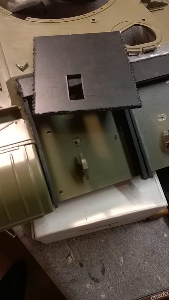

Frontal armour made and fitted, it actually overhangs more than it should for the time being until i'm happy with the final fit of the upper hull, then i will just trim it off and redo the bottom weld line. I like using black plastic card as if it gets scuffed its not as noticeable as white.
