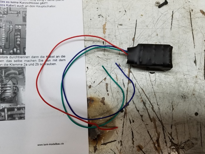

the track portion of the recoil on the KT? I bought a piece from our german friends and it came with no instructions. Just three wires out the back and a place to plug a 2 pin connector in. And 4 places to put other wires into. It's a lovely unit, and I saw a wiring diagram here but danged if I can find it now. I think it is called an ARM unit?

Pretty sure it goes between the RX board & the motors. I've got one somewhere and am equally stumped, not least because it looks like I need to solder something....

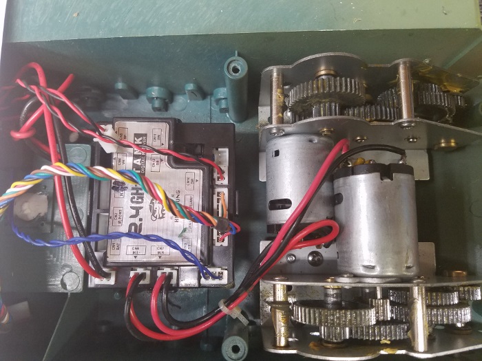

I imagine cutting the red wires to the motors will prevent the recoil signal getting to them. Then again, the motors will need some source of power from the Battery (+) via the MFU L and R terminals, and so there should still be a direct connection from the MFU to the motors. Then again, it's the MFU providing the recoil signal to the motors. Therefore, the red to the motor has to pass though the recoil nullifying unit before it reaches the motor (+) terminals, I guess. Looking at your wiring, the motors are connected directly to the L and R connects on the MFU. Normally, that's how it goes.
Somehow the unit has to be wired in between the MFU and the motors,,rather like a switch, I guess.
Not having the setup to hand, nor my usual tools (multimeter. continuity tester..etc.) it's hard to proceed in a meaningful way. If the wires somehow pass through it's not made clear here in the text, and the diagrams ..being vague greyscale.. don't make it any easier to see what to do though this iPad I'm using.
