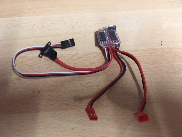

At last my small ESC arrived from china, but without any documentation.
Its going into my HL truck.
Can anyone tell me what plug goes to battery/motor ( google was not my friend, this time)

I know nothing about HL trucks, but I'm guessing that from L to R you have:-
(1) RX connector; (2) On/Off switch; (3) Power (input) to MFU or Sound card; and (4) Connector to the supply battery- in that order. No doubt some experienced HL truckers here will have the right answer for you though. This is just to get the speculation going.
if (4) is the supply, connecting a battery should produce power in (3) and (1) with the switch (2) on. A multimeter or simple voltage detector should help detect the presence of supply in the terminals.
Re: Wirering ESC
Thank you Mike. Exactly what im looking for.

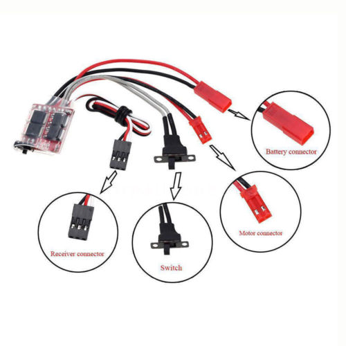

No problem. My handy guide everytime I put one into the HL trucks. My Gaz-66 just showed up and put one in there already. I still don't know however what the little switch on the board does. Tried different setting and didn't notice any difference. Maybe for the brake function ?
Re: Wirering ESC
It's for the brake indeedMichaelC wrote:No problem. My handy guide everytime I put one into the HL trucks. My Gaz-66 just showed up and put one in there already. I still don't know however what the little switch on the board does. Tried different setting and didn't notice any difference. Maybe for the brake function ?

Michael to the rescue!. I think I had the order about right, but (3) should have read 'motor', but I put 'MFU". I knew it was the route/path to the motors; but not that an MFU isn't needed in that particular signal path.MichaelC wrote:No problem. My handy guide everytime I put one into the HL trucks. My Gaz-66 just showed up and put one in there already. I still don't know however what the little switch on the board does. Tried different setting and didn't notice any difference. Maybe for the brake function ?
Live and learn, eh? Glad you had that diagram to hand, Michael
