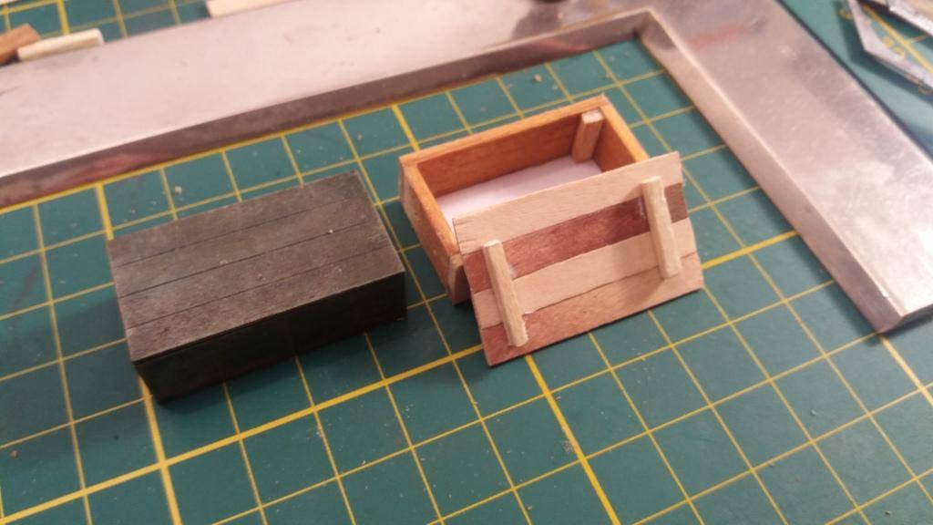

I used balsa wood to create them.
Model 1:

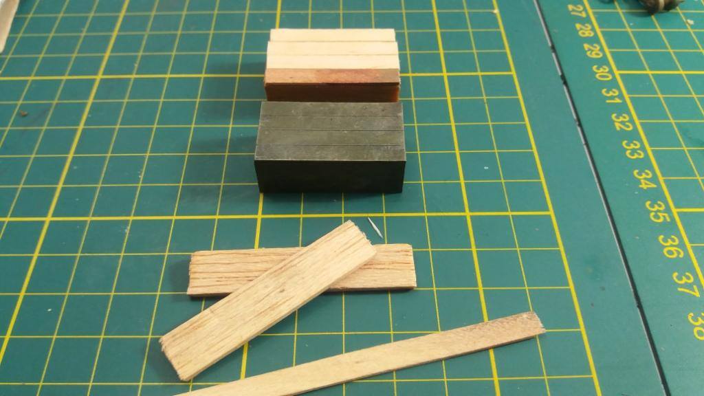

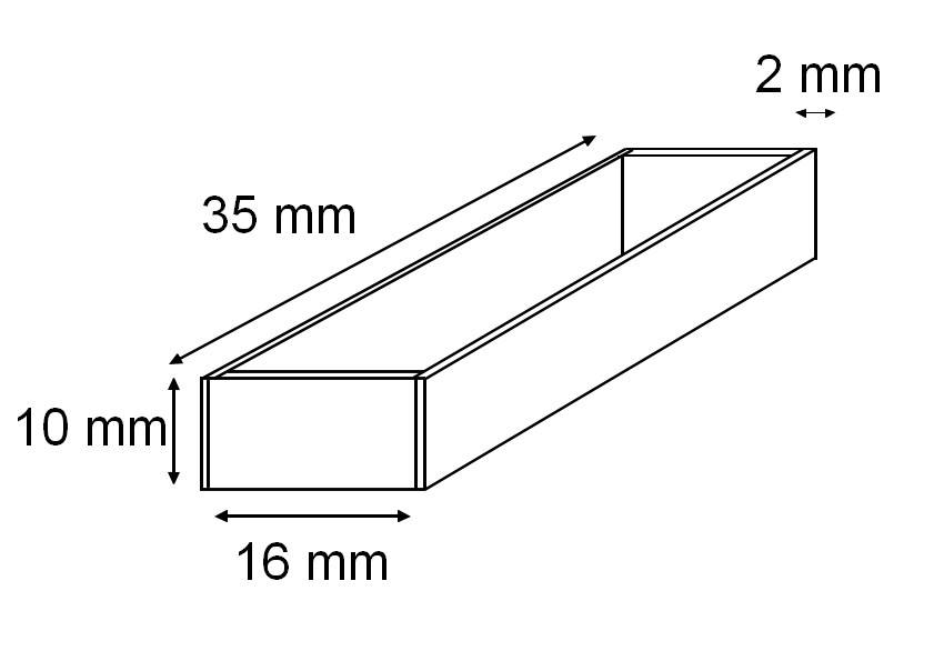

Out balsa strip of 10 mm X 2 mm we will create the box itself.
Out of 4 mm X 1 mm we will create the lid and bottom.
crate 2.jpg (22.89 KiB) Viewed 10220 times

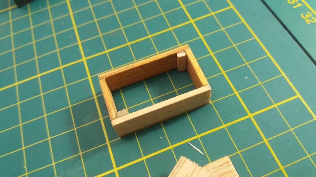

You need to cut first 2 boards of 35 mm length and 2 of 16 mm.
crate 3.jpg (69.85 KiB) Viewed 10220 times
Once done, glue them with cyanoacrylate glue (super glue). You can add some squared small pieces of wood in the corners.
Take great care to get the corners squared as well as getting them flat!
crate 4.jpg (65.71 KiB) Viewed 10220 times

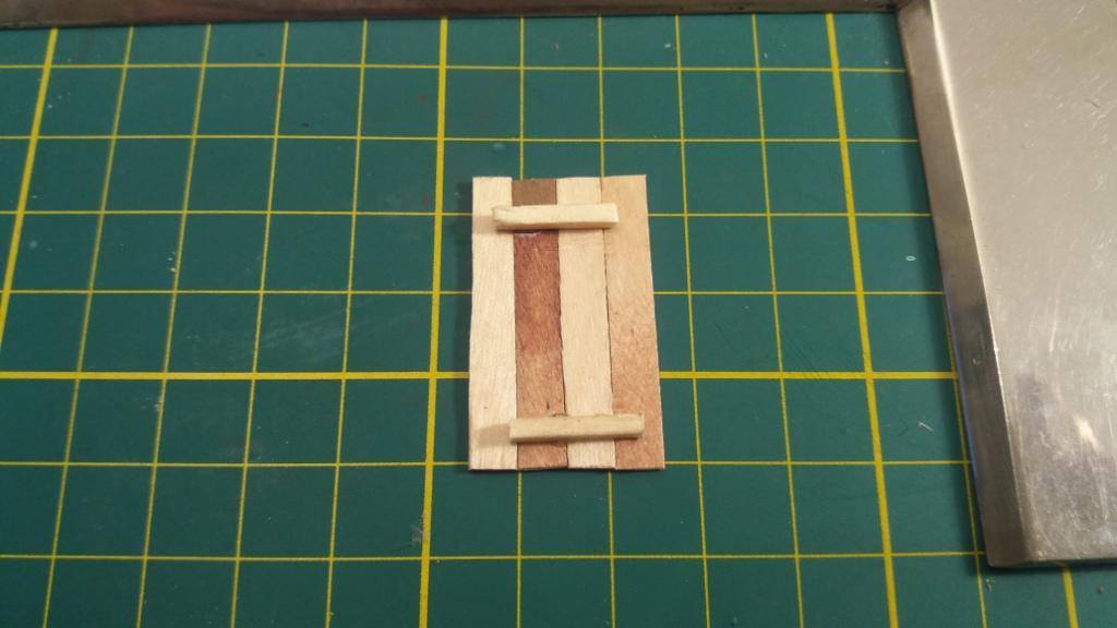

While it is drying, we can now work on the lid and bottom of our boxes.
For this, out of the thin balsa you must cut 4 boards of 35 mm length x 4 mm. Sometimes it is hard to get 4 mm strips, so you can use wider ones and cut them to 4 mm.
I'm using a piece of 1 mm/1 mm to get the lid centred allowing me to set the crate in open or closed position.
For the bottom it is better to glue them directly.
crate 5.jpg (56.21 KiB) Viewed 10220 times
crate 6.jpg (62.2 KiB) Viewed 10220 times

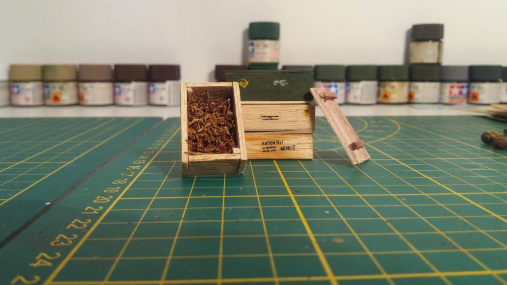

ET VOILA!
It took me between 4 and 5 minutes to do one, so that’s why I’m saying it is quick.
Of course now you can weather or paint them and get a result like this.
So what I’m doing is, when I have some minutes left in a day, I’m making one or two of them.
crate 7.jpg (61.18 KiB) Viewed 10220 times

Thanks to you, if you want to add some more realism, you can, as I did on some, put decals on them.
I used some from my spare decals box, even some are from 1/35 kits, they can do the job.

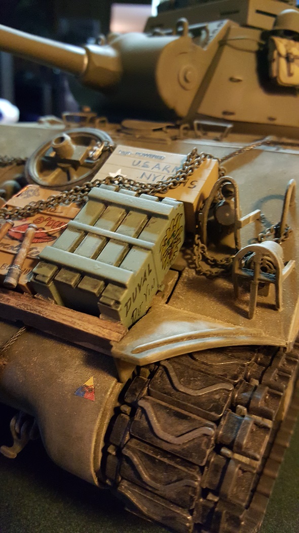

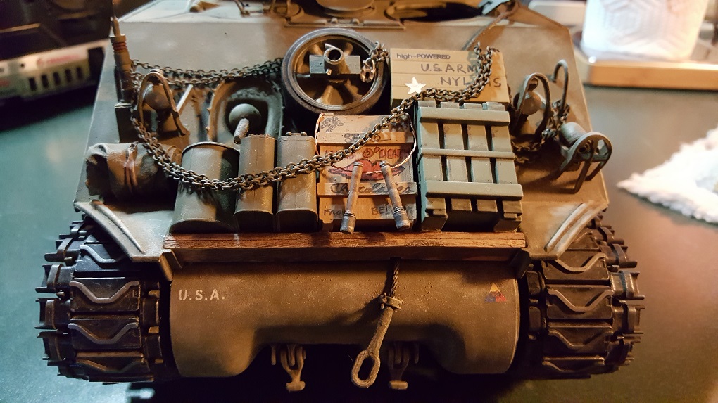

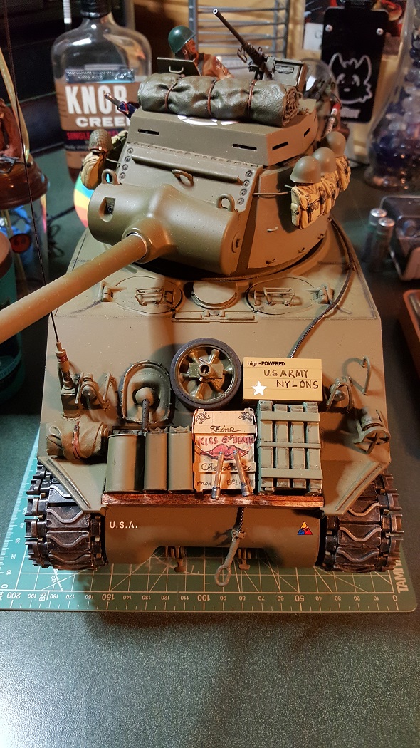

Don't be afraid to think outside the box as it were ( pardon the pun please ). Storage on a tank is a great opportunity to bring realism with a touch of humor to light. Some of the gear on Crazy Joes M36B1 was modified with paint and permanent marker then given a coat of flats to keep it moisture proof. Boxes were completed using flat strip styrene or popsicle sticks. Pics:
Front stowage mounted to the board using the clear 3M tape.  It's all one piece now. The spare wheel is a separate mount..jpg
